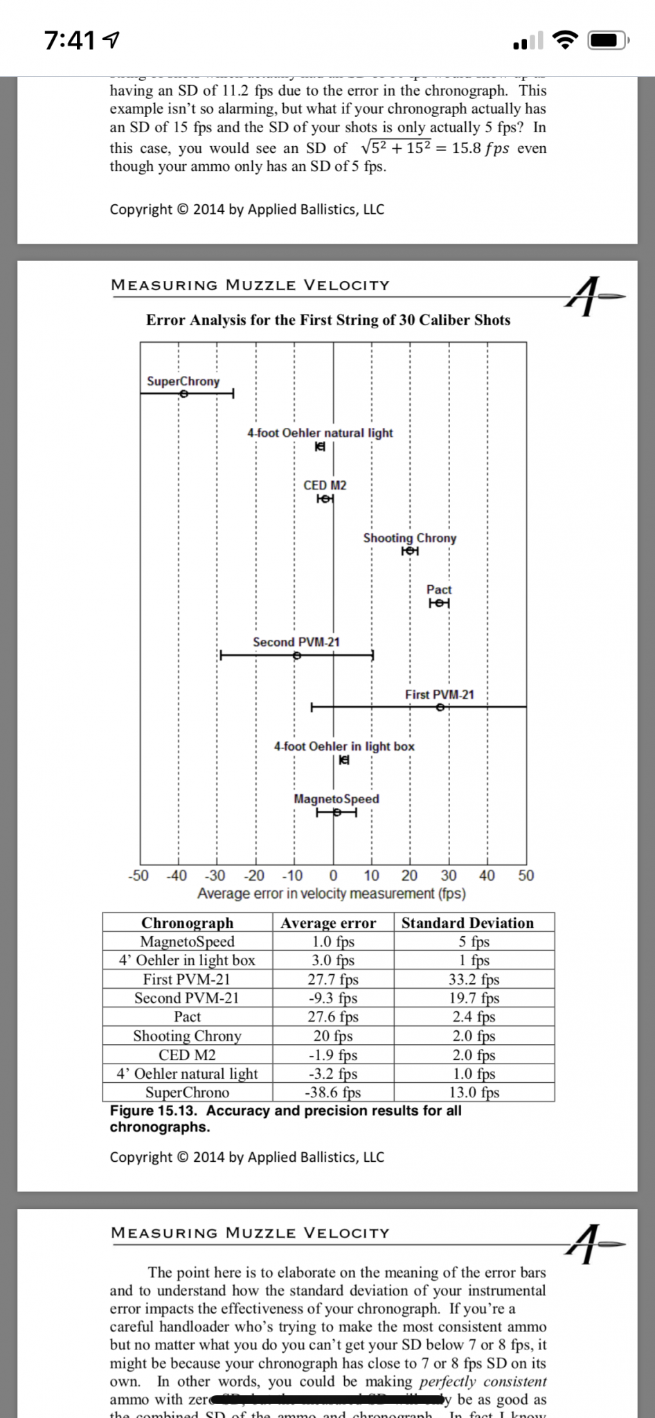

Reactions: spife7980
I had a caldwell, still do, but it sits in the garage. I have run the magneto speed and labradar at same time and got same exact numbers. I went with labradar mainly because of the number of rifles I use and load for, just more practical. I made a board that clipped to the back end of the caldwell and I could align it through the scope with a laser bore sight. It worked ok, a lot of effort and it was still not reliable due to light.
right out of the book:
ALL CHRONOGRAPH UNITS HAVE INHERENT UNCERTAINTY WHEN RECORDING VELOCITY MEASUREMENTS. SEVERAL UNCONTROLLABLE VARIABLES CAN AFFECT EACH MEASUREMENT AND CONTRIBUTE TO THIS UNCERTAINTY, INCLUDING SUNLIGHT INTENSITY, SUNLIGHT ORIENTATION, CLOUD COVER, WIND, SHADOWS, AND GROUND REFLECTIVITY OF CEMENT, WATER, OR SNOW, ETC. WHEN COLLECTING DATA, BE SUSPICIOUS OF ANY DATA POINTS THAT HAVE GREATER THAN 4% DIFFERENCE FROM THAT AMMO’S AVERAGE STRING
.2. Position the unit 10 to 15 feet in front of the muzzle of a firearm or if using with a bow, at least one full arrow length in front
I had a piece of tape at the 12.5 foot mark on the cord going to my tablet.
