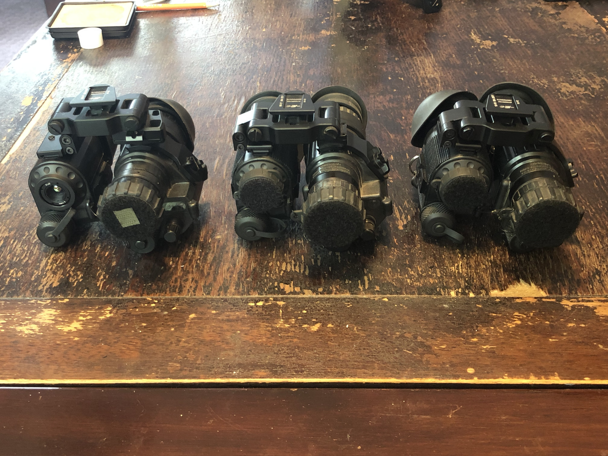

haha, I started out with a pair of 14s six years ago for my head mounted NODs. But a year later got my first head mounted thermal. Since then I've continued the slide towards dual band head mounted NODs.
Now I have three 14s (shown in the first row) and a breach (in the center) and a skeet (to the rear) and a patrol m300w (not shown). All three thermals have usb batteries which extend the run time beyond one night and add to the counter weight on back.
These days, the only time I would consider going with two 14s is if I was driving a vehicle with fixed front glass (which thermal can't see thru) and a load of passengers. So for enhanced safety in that scenario I would go with the dual 14s. But otherwise to detect critters that are alive ... I want a thermal on my other eye.

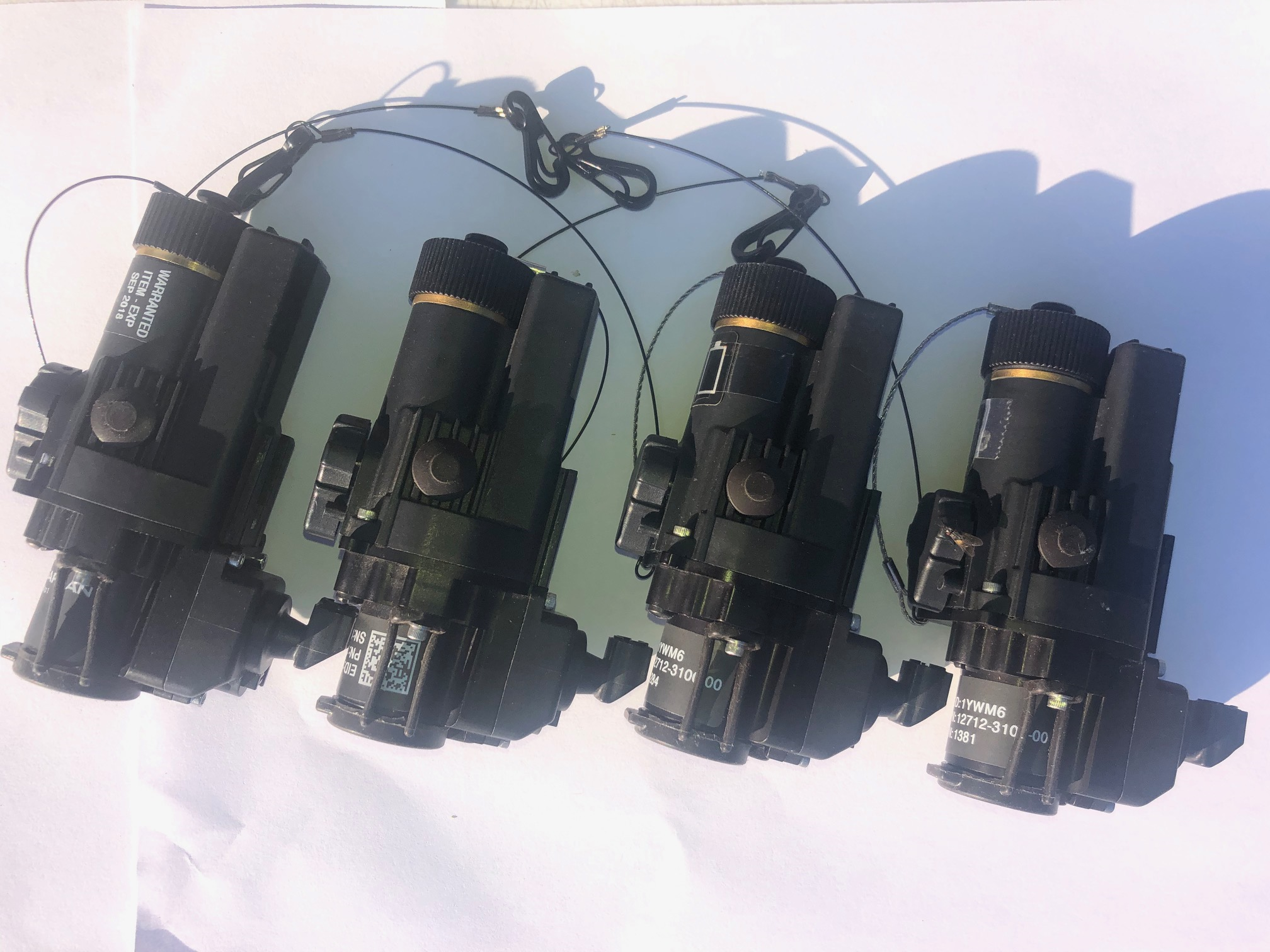

Left to Right: Mod Armory Quick Detach Bridge, Mod Armory Light Weight Bridge (Original Version), Mod Armory Light Weight Version (Current Production)

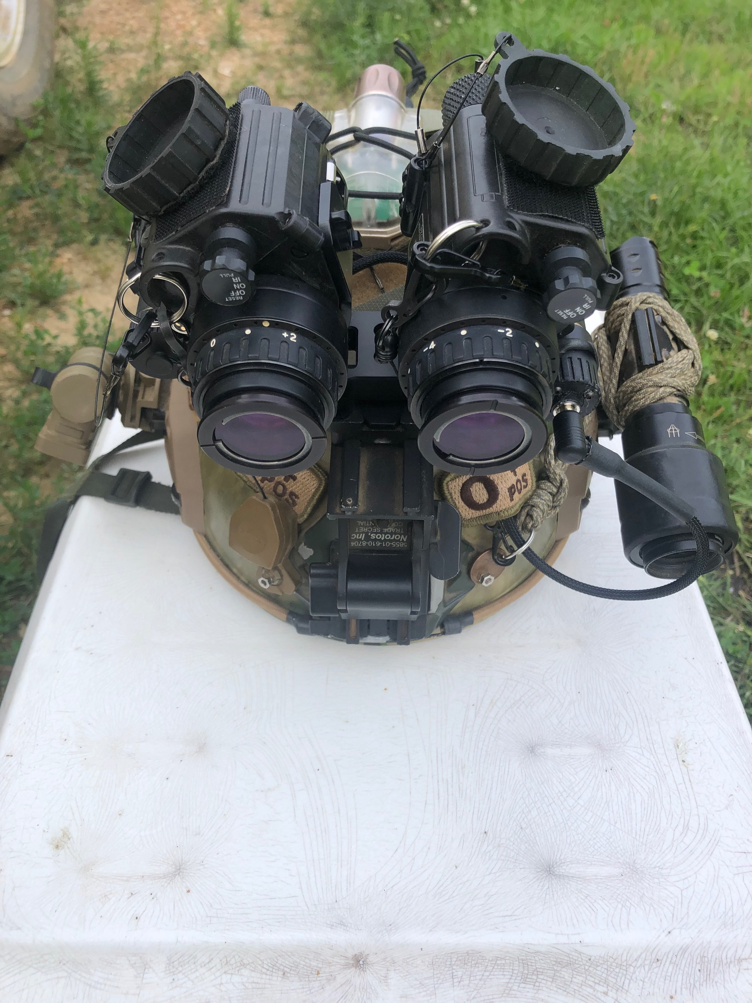

@nighttrain0305 I just posted these on the Collimation Thread, but here they are again.

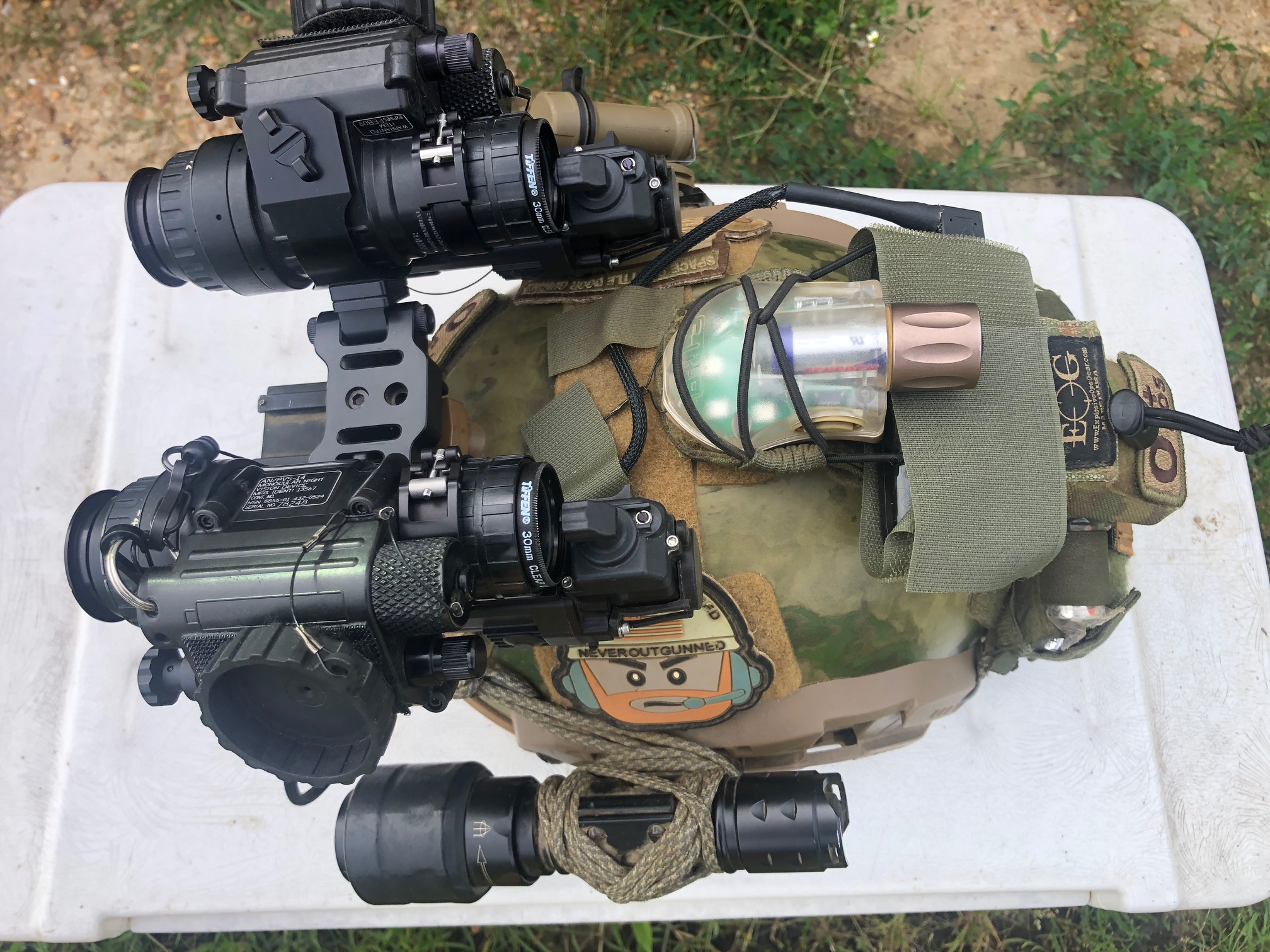

PVS 14s laying flat on your helmet with Mod Armory Lite Weight Bridge and Norotos Rhino 2 with Dovetail Socket.
Dual PVS 14's with a Dual Set of COTI's on the Mod Armory LIght Weight Bridge with Rhino 2 and Norotos PVS 15/18 Socket. Please not these will not sit quite as low due to the COTI's being on the 14's but still much better than anything I know of currently out there.
