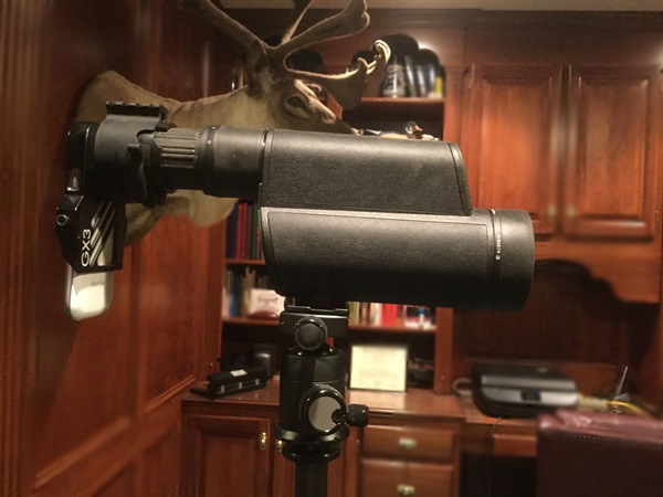

    I posted this elsewhere but this combo works well. Leupold Mk IV, Vision Pro shop adapter & tripod.
