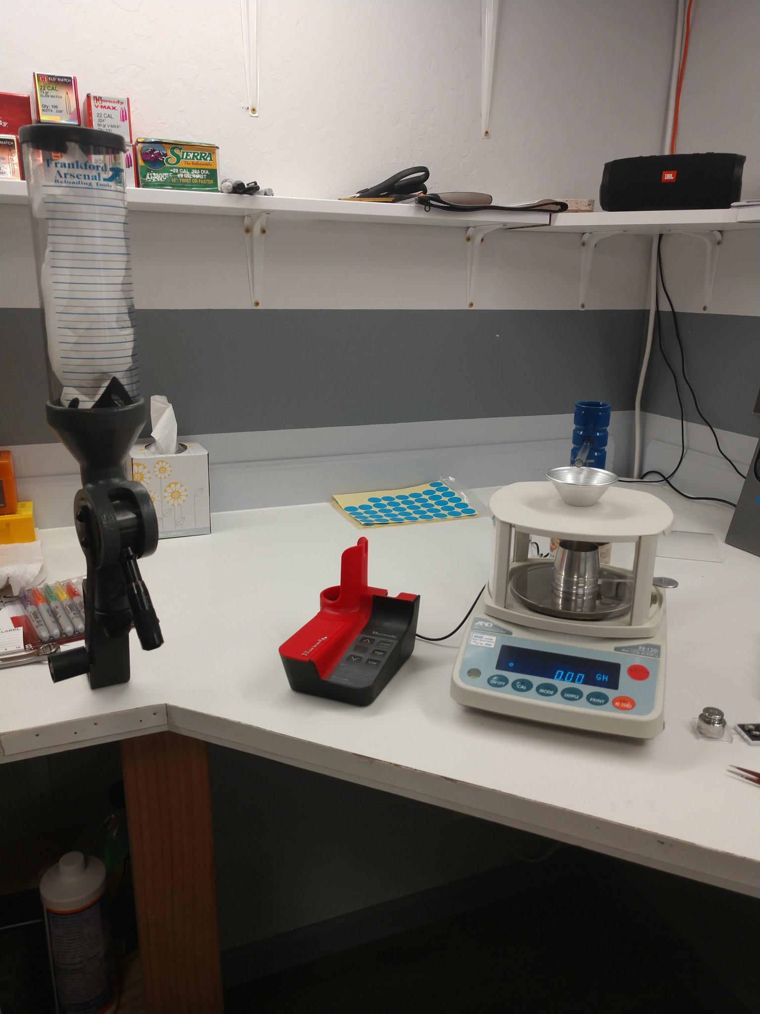

I am running the FX120i with a Frankford Arsenal powder drop and vibratory trickler. It is just as fast as the whole auto throw/trickler set up and just as accurate but was about a third of the total cost. I load for multiple calibers too. Easy to adjust powder drop to get it close then trickle.

Could you show us a picture of your setup please?
I'm not seeing how that's 1/3 the cost since the scale is more than half the cost of an auto-trickler setup.
You might save a couple hundred but you lose the completely automatic dispensing part.

So turns out waiting to by the AutoTrickler worked in my favor with the hole v3 thing coming out when it did. The other cool thing that happened was a buddy of mine owns a scale company and had a fx-200i he gave me. SCORE! Now just waiting for the v3 to show up.
Reactions: BigBlastin300win
How is everyone liking the V3? I am about to pull the trigger on the combo but now they have a V4 coming out. So I might just buy the scale and wait for the v4. This will be my first year loading and I am trying to be one and done in terms of scales and throwers. If anyone has any input i am all ears. Obviously I will have to throw manually until I get the auto trickler. I really just want to get my order in so I can load but the v4 seems pretty promising.
I would say get on the waitlist for a V4. My set up is a V one with some V2 and V3 modifications. The whole set up as a V4 looks really awesome and I know if Adam puts it out there it’s going to work and it’s gonna work well.
The whole V3 set up looks awesome compared to my Kabul together system but my system works and I spent enough money on the stuff without buying a loading system to replace one that works.
That said I’m probably going to get in line for a V4
