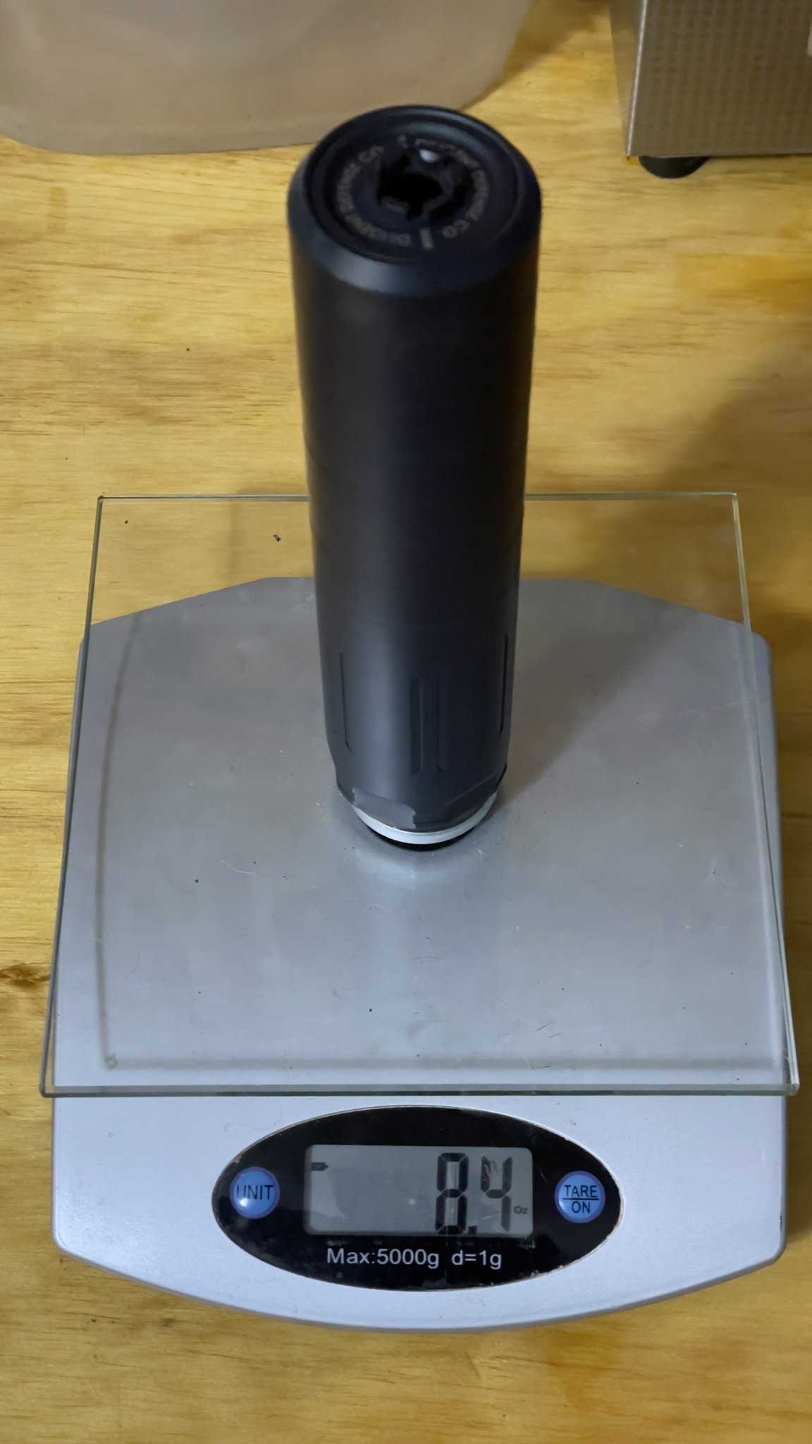

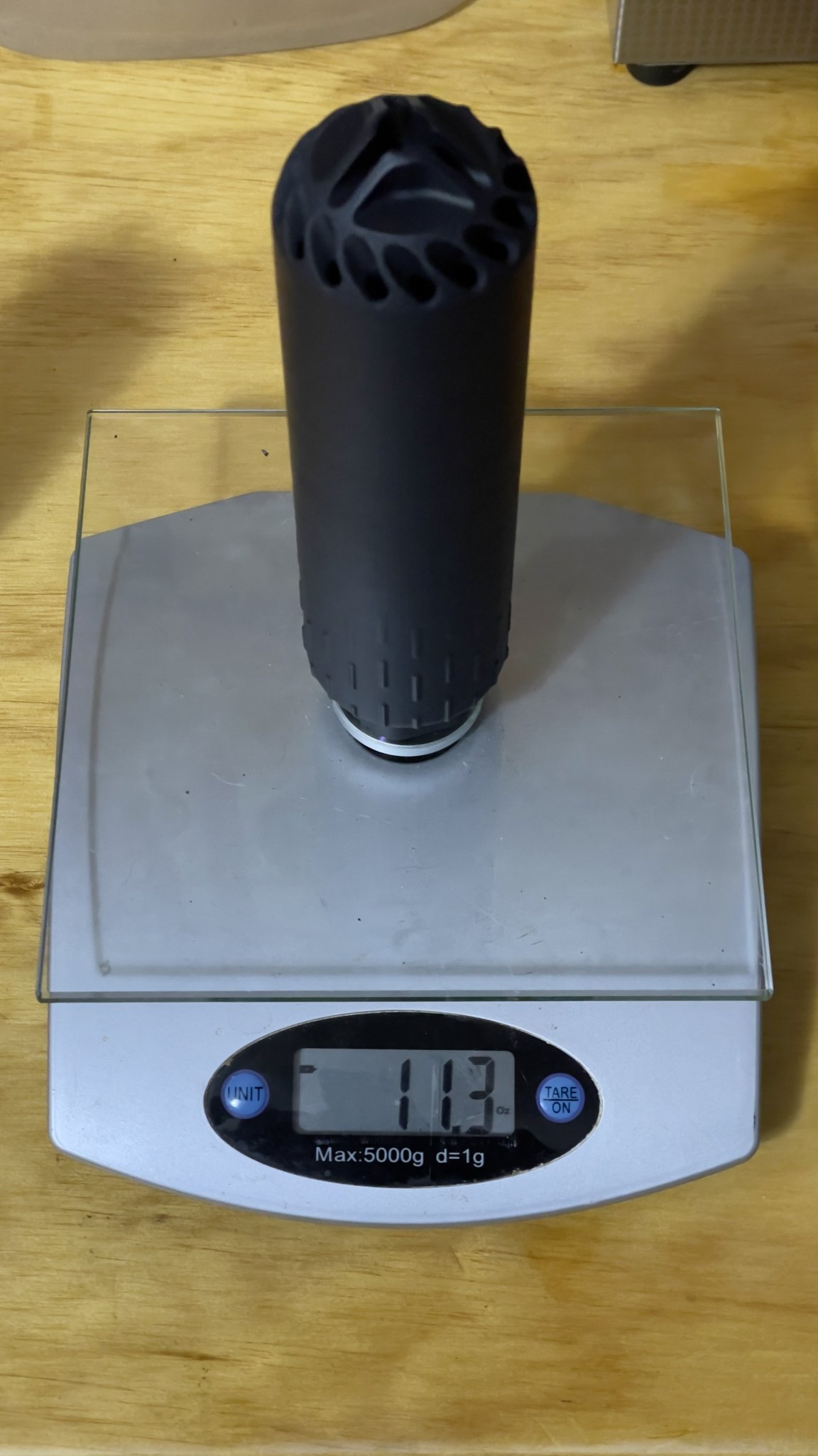

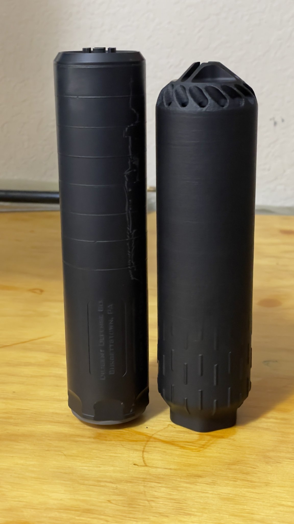

I have the Enticer S Ti as well as two different Huxwrx cans including the new Flow 762. There's nothing between the Enticer and the Flow 762 on a gas gun other than the Enticer has significantly more gas out the port and the rifle will need to be adjusted and the Flow is likely more quiet at the ear (haven't tested without ear pro). Honestly, there's virtually nothing between them on a bolt gun either. The other "low back pressure" can to look at is the new stuff from Radical Defense, specifically the LS3 and CS3. They're both offered in a titanium lightweight version in either a long (LS) or short (CS). I'm waiting for the CS5 to hit the shelves as a dedicated K-style 5.56 can for when my Sierra 5 implodes. I had to do quite a bit of gas adjustment to get my 5.56 rifles to run well. Without adjusting the gas, my 16" DI gun's felt recoil was horrific (for that caliber anyway). Once I dialed the gas way down, much better. Still, a flow through design is just better and less noise at the shooter's ear where it matters. No affiliation with Radical Defense or anyone else in the industry for that matter. https://rdusa.com
The Enticer photos below is with the direct thread rear titanium HUB mount.
