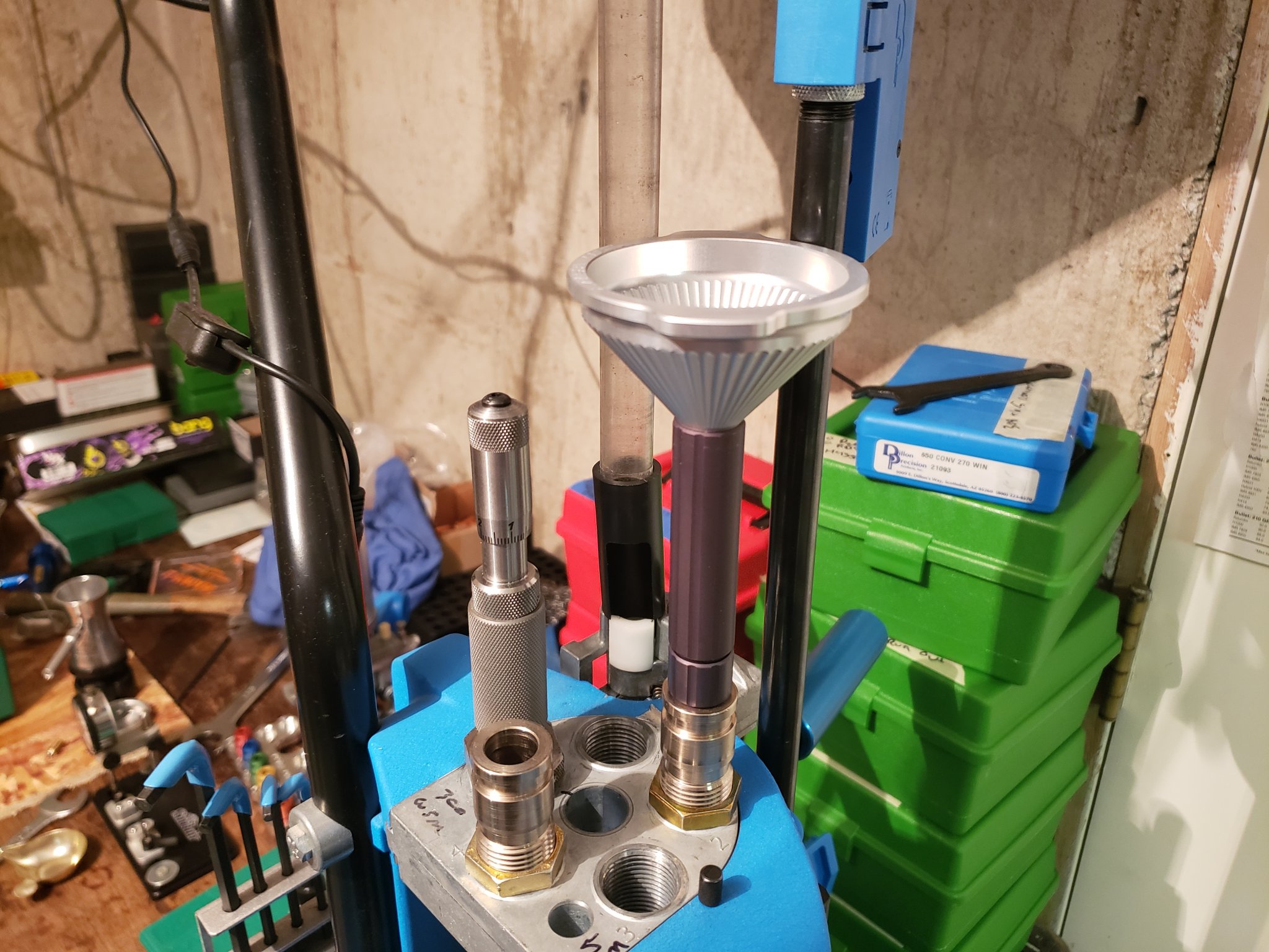

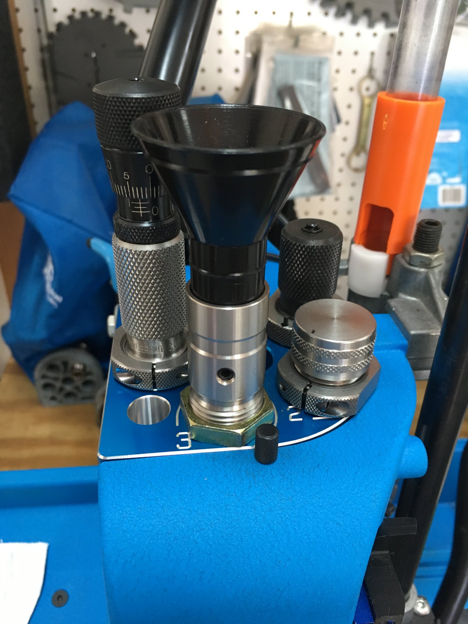

You don't need a bushing area 419 makes a funnel that directly sits on a standard Dillon powder die
The dillion funnel would work but it's not heavy enough to always sit tight to the die.
All I did was basically glue an old rcbs green funnel onto the powder insert that dillion uses. I first started to just pour into the dillion powder die at top stroke from the auto dispenser pan. But the funnel makes the process a little faster. The way I did it doesn't work in short cases. But I can make it work on all 30 cal I reload except 300blk but I don't get picky with that.
I still have to wait on the two dispensers tho.
To be honest I could easily keep up with four of them.
Really you can take the die out and just sit any old powder funnel in there and stop at the top of the stroke and seat the funnel and drop the charge.
The other idea I had was somehow sit a funnel on a charge bar so you can drop the charge in at bottom stroke and it will then drop in like normal.
I have tried the dillion and all I get is powder everywhere. Not sure what I could be doing wrong.
Not sure if everyone who's tried the Dillon funnel has used it with the AT 500 Powder Die as Dillon says or not.
I ordered the funnel and die a few weeks ago and they've worked great for me.
Dillon AT-500 Powder Die

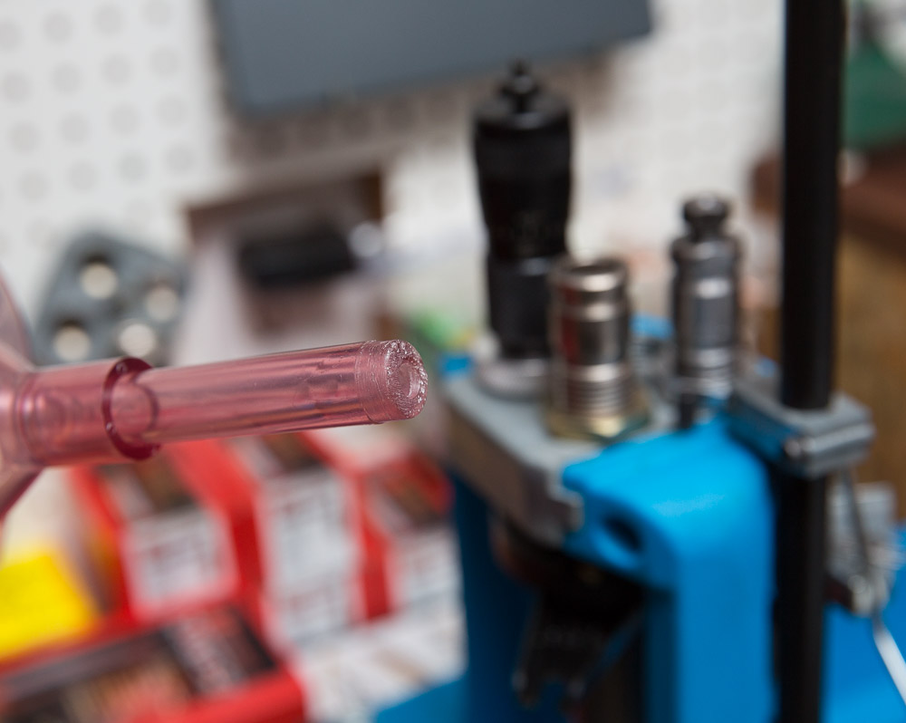

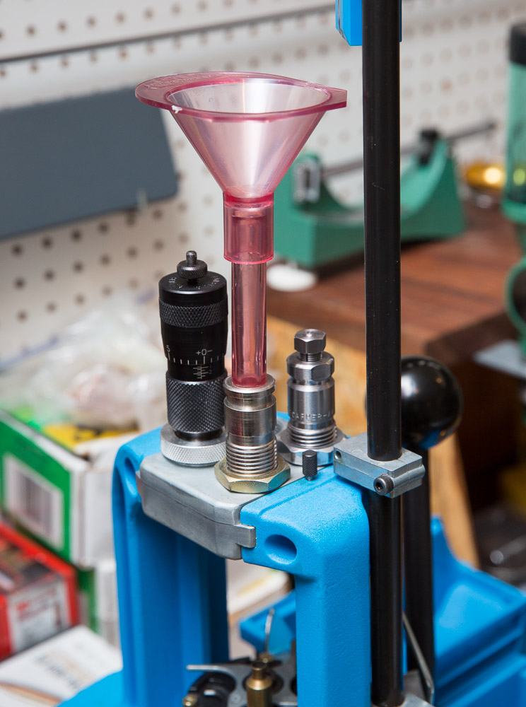

The issue I have is the H4350 powder does not always get into the brass case and powder goes everywhere on the down stroke. My bench is build high and I cannot see into the funnel to see if the powder got clear of the funnel insert in the AT 500 die.
MTM Universal funnel kit with drop tube. $15, cut the drop tube a bit shorter then modify to fit into the powder die when it's at the top of the press stroke up against the internal powder funnel. Lets you see if there is any bridging of powder, smaller center diameter of tube keeps any kernels from getting hung up inside the powder die on the top of the powder funnel. I leave the powder die/funnel at the proper location for the Dillon thrower, so I can swap that on and run progressive loads if I want to without changing the powder die.
Been using it for years now, works great.
Reactions: fxdrider
That setup looks pretty cool. I like the idea of the longer powder drop.
