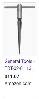

One thing I did to correct Varget bridging is increase the taper of the stock "A" powder funnel with a 1/2 - 1/8 reamer. The T handle presses out and the cutter fits in a 1/2" drill motor making the process very easy. It not a 1000 round an hour solution, that is, it doesnt speed things up, but with a reasonable tempo, I stopped getting even occasional varget bridging with my 25 grain load.
