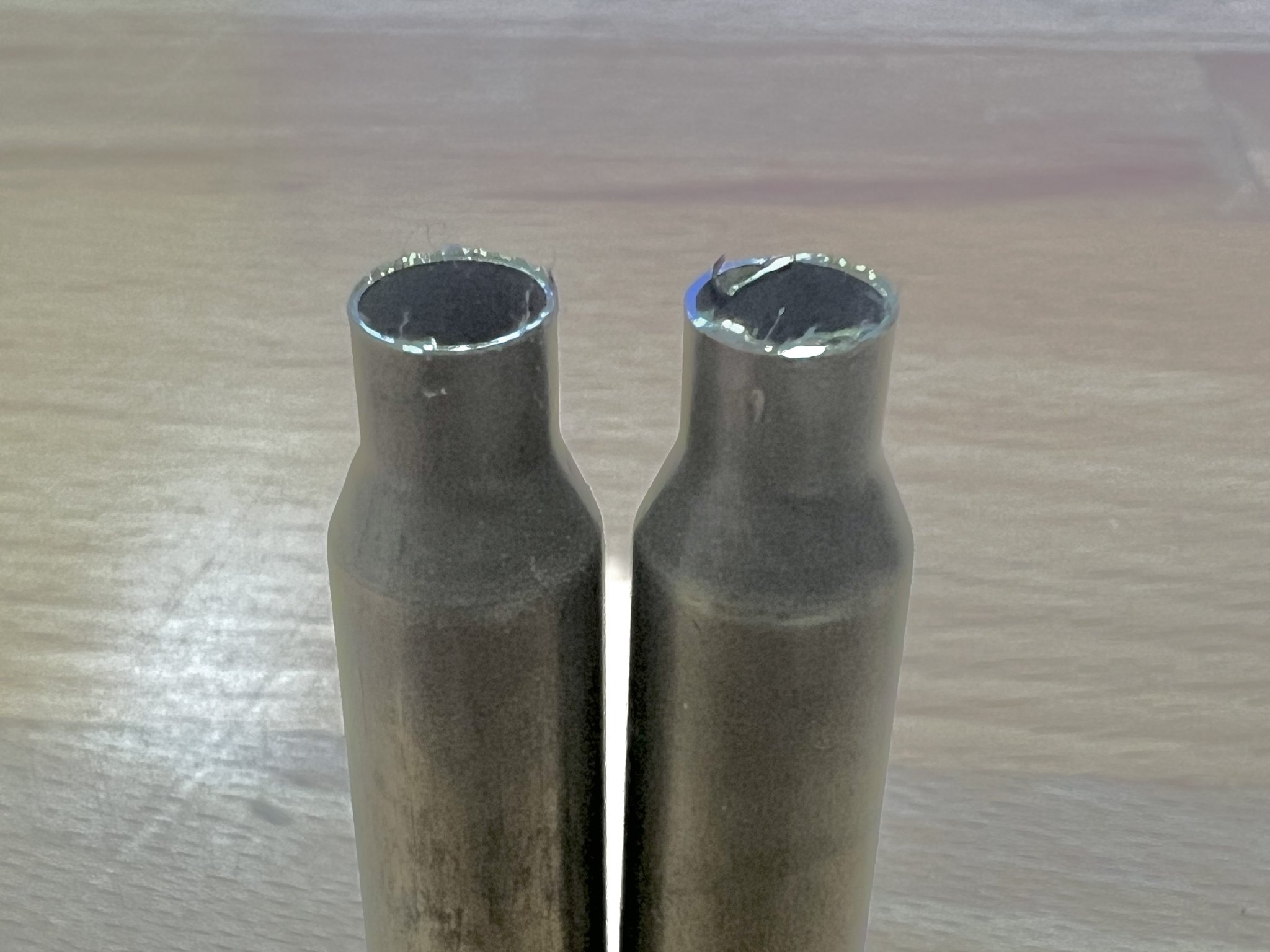

Purchased a rt1500 to eventually trim about 30k of LC military 5.56 brass. I have a giraud but thought this would be quite a bit quicker. I’ll be reloading on my rl1100 but planning to do the case prep on my xl650.
Anyways, set it up properly and all the brass comes out really rough and not consistent. Switched the blade around and same problem. I live 20min from Dillon so I stopped by a few times and had them check it out. They said everything looks good and gave me a new blade. Tried it again and everything was still a rough cut. Finally took it in today and set it up in front of them. The only way to get a clean, square cut was to run it through the trimmer twice. After the second time, everything looks great. Dillon didn’t have a solution.
Are the stock blades too weak? Seems strange that guys use these for 300blk conversion but I can’t take a few thousandths off of 5.56 brass.
Some of that looks like what happens when it does the "bird nesting" thing. The manifold is kind of a shitty design.

No, they are brass LC. Just bad lighting
Did you edit the lighting in the OP photo? Before, I swear they were nearly black, and the trimmed area was bright silver. (I did see the part in the OP that stated "LC brass", but the photo sure didn't look like it, so that's why I asked). Anyway, they look more like brass now.
Yes I did! It was a crap pic.

... so I stopped by a few times and had them check it out. They said everything looks good and gave me a new blade. Tried it again and everything was still a rough cut. Finally took it in today and set it up in front of them. The only way to get a clean, square cut was to run it through the trimmer twice. After the second time, everything looks great. Dillon didn’t have a solution.
Not the usual outcome from Dillon.
The power trim units are very popular and this result isn't normal at all. It would take a lot to dull a new tool. Having one bad right from the start is possible, but swapping to a good tool would cure this instantly.
Add to the results with the idea that they didn't just swap out all of your stuff and demonstrate good results is a little surprising.
Even if the folks on hand didn't know how to debug, swapping out the whole mess would have been easy enough and since they have many machines set up and running so it should have been easy to demonstrate your toolhead running successfully on one of their machines.

Yeah, they gave me a new die on Friday and asked me to try that. They did check it and said everything sounded good and was rotating the proper way.
I’ve tried holding it longer at the top, slower at the top, everything. Still comes out super rough and inconsistent.
Brass comes out perfect when I run it through the trimmer twice. Most of my brass is in the 1.765+ range. I have it set for 1.750. When I run it twice, it all comes out at 1.750.
I found a few pieces in the 1.755 range and when I trimmed it, I only had to do it once and I came out better

What is your chip extraction setup? Shop vac of some sort on the chip extraction hose adapter with lots of suction?
Sounds like the birds nest issue and your not getting it cleared and this double stroke/cut you speak of is helping clear out debris...

Yeah I have a powerful shop vac attachment. Haven’t had issues with the birds nest. This happens on the first case of 5.56
