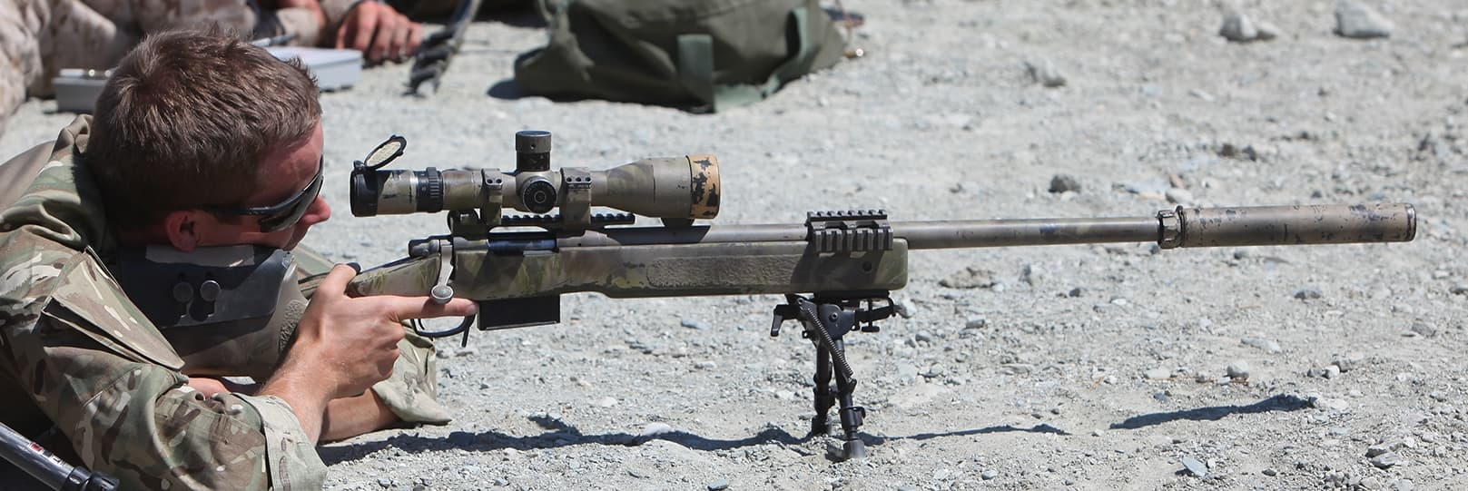

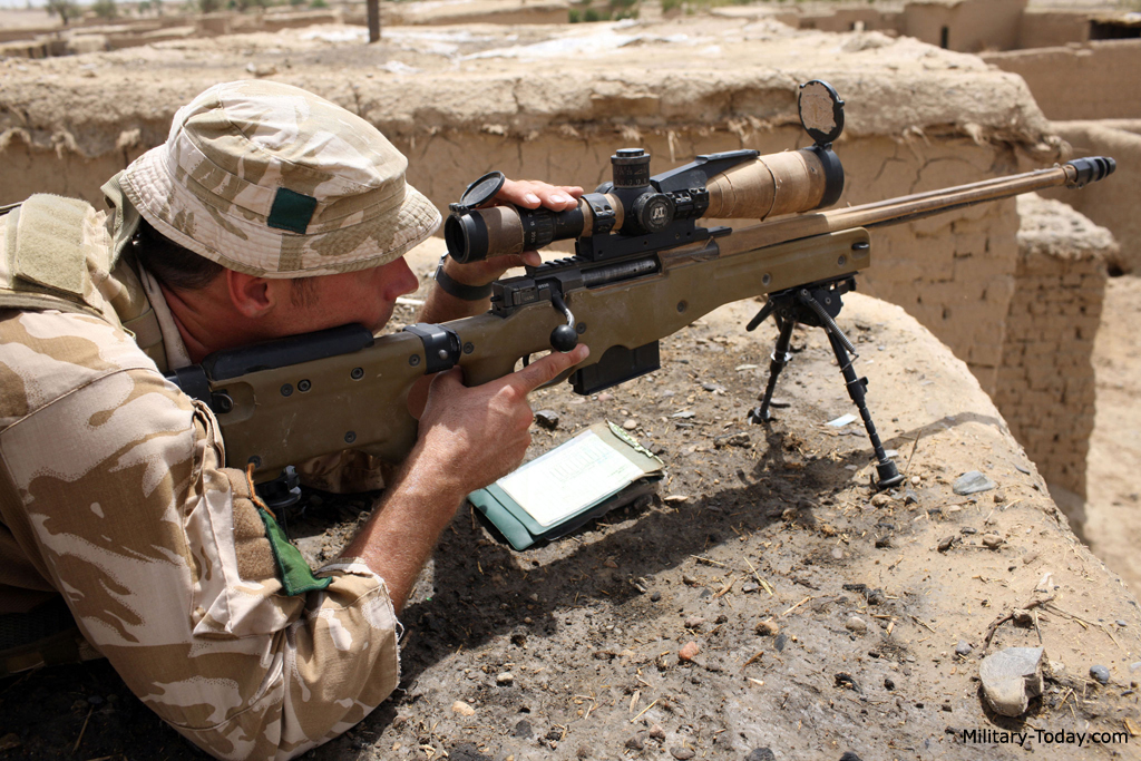

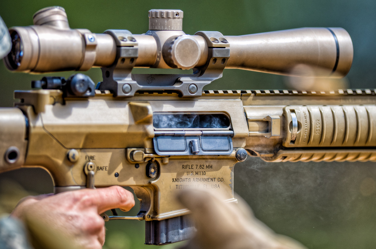

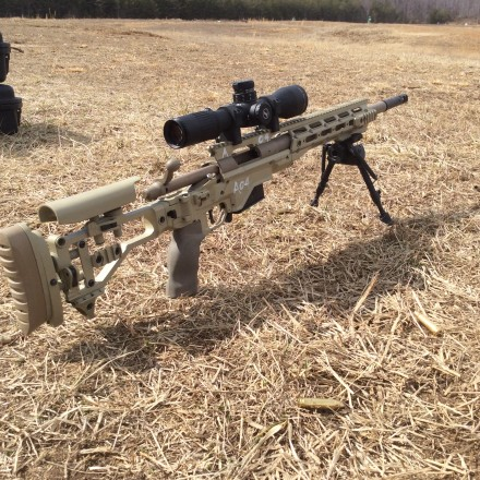

What do all these hard use rifles have in common?
I think it's fair to say that quality rings clamped to a quality, angled MIL-STD-1903 rail is more than strong enough.

They are yellow?
Those are bolt guns, gas guns, screw on and milled in rails in stocks and chassises. Separate rings and monolithic scope mounts...

They are yellow?
Your username is fitting.........
They are all hard use rifles. They all have scopes attached to the rifle via a MIL-STD-1913 interface. The difference between rings and monolithic mounts is irrelevant.
