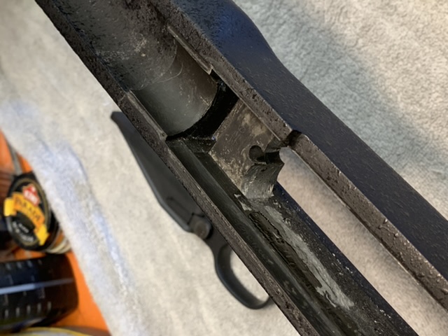

I used the Power Custom bedding studs when I bedded my fathers FN / Win 70 action into a McMillan stock a couple weeks ago. First time I had done a bedding job and looking back, I was way overthinking it. Kiwi shoe wax on all the surfaces I didn't want it to stick to, plumbers putty every place I didn't want the MarineTex to go, tape wrap on the barrel to center everything up, and dry fit 100 times to get good clearances before hand, removing as many high spots as possible and making sure the mag system worked properly. I didn't even remove the trigger, just encased it in plumbers putty and dry fit it to know exactly where the bedding would be filling in. It came out great.

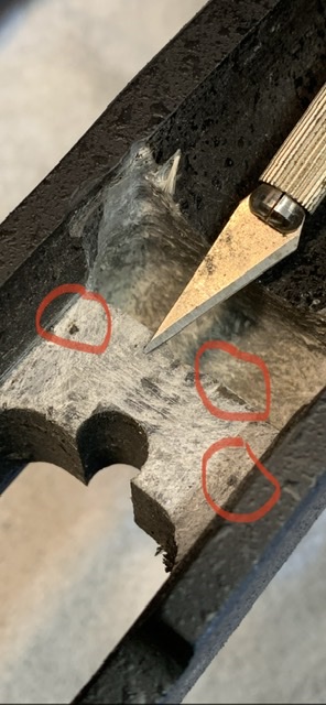

Whats the best way you found to identify high spots while dry fitting?
If you have high spots you'll often times be able to rock the action. Unless you have lots of high spots.
I'm no expert. But the 2 I've done improved accuracy and repeat even when I take the stock off.
What I've done on them is take a Dremel to everything between the action screw holes. Don't go crazy. Just remove a layer of stock material. That gives the bedding a place to go, removes high spots in between the pillars, and roughs the surface and gives the bedding a better surface to bond to.

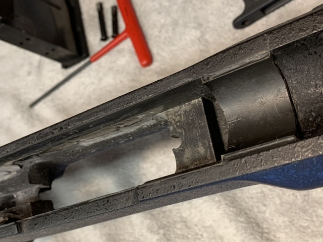

Run your dry fit. Tape, fill voids (I use Play-Doh), apply release agent(wax, Hornady 1 shot etc) then Blow it out with air and then degrease the stock with DNA or whatever you like. Let dry.
Mix up the goop and apply it. I like to coat the action AND the stock. Nearly fill the recoil lug. Set it in place and move it around a bit. You wanna try to get it even and remove any air.
Like Heytonyman said, I freaked out and over thought the process. It's really not difficult. Just think it through.

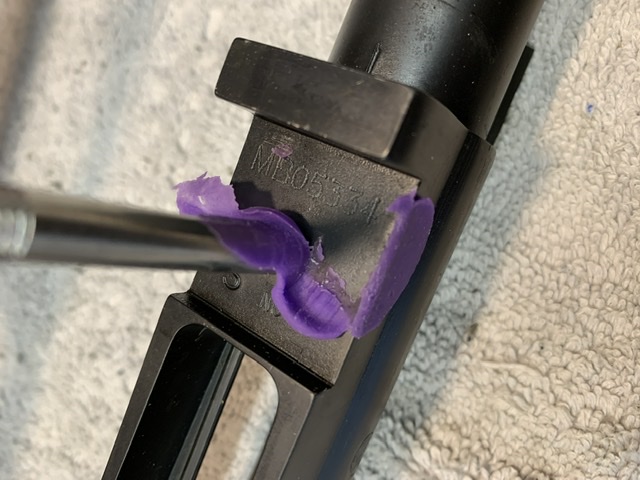

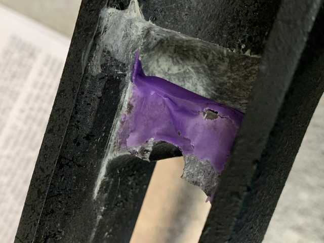

I initially laid down a bed of playdoh to get an idea of the low spots and to check how much material would be between the recoil lug and the stock. Once I got close, just rubbing the stock back and forth on the action left a dark spot where the contact was occurring. Don’t have to get too OCD about it, just make sure nothing glaring is happening. The bedding compound does the work.
