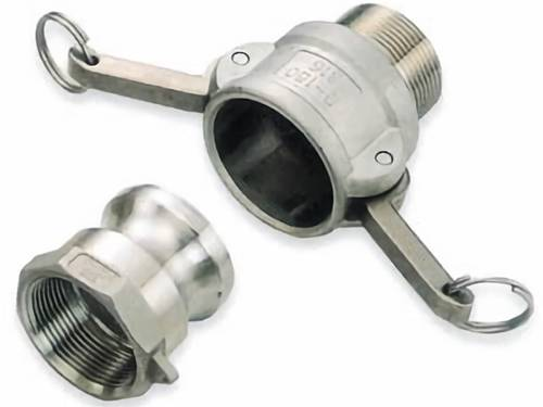

I actually have a slightly better solution for connecting the legs rather than screwing them in. You can get cam lock fittings (NPT) that will screw onto the pipes. Then you can just about snap them together.
Neat! Got a link for those?
I can't remember if this is the place where I got them, but they are all essentially the same - except for price. I got two of each for the 3/4" legs and one set of 1" for the rear leg. It came out to about $10 per stand.
