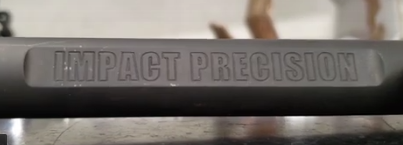

Hey Guys,
Did a video for you on how I swap out my barrel on my precision rifle. I know for me it was a dark magic that only gunsmiths and witch doctors could perform because I hadn't done before and I couldn't find enough visual information to wrap my head around it all those years ago. Hope this helps someone out.
-Match Junkie
