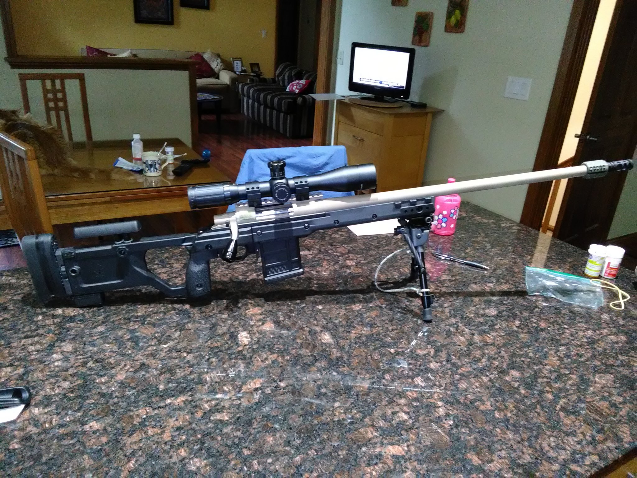

Here's what it looks like on my heavy barrel Howa. The brake itself is a VG6 Gamma 762
Reactions: MBowersox
