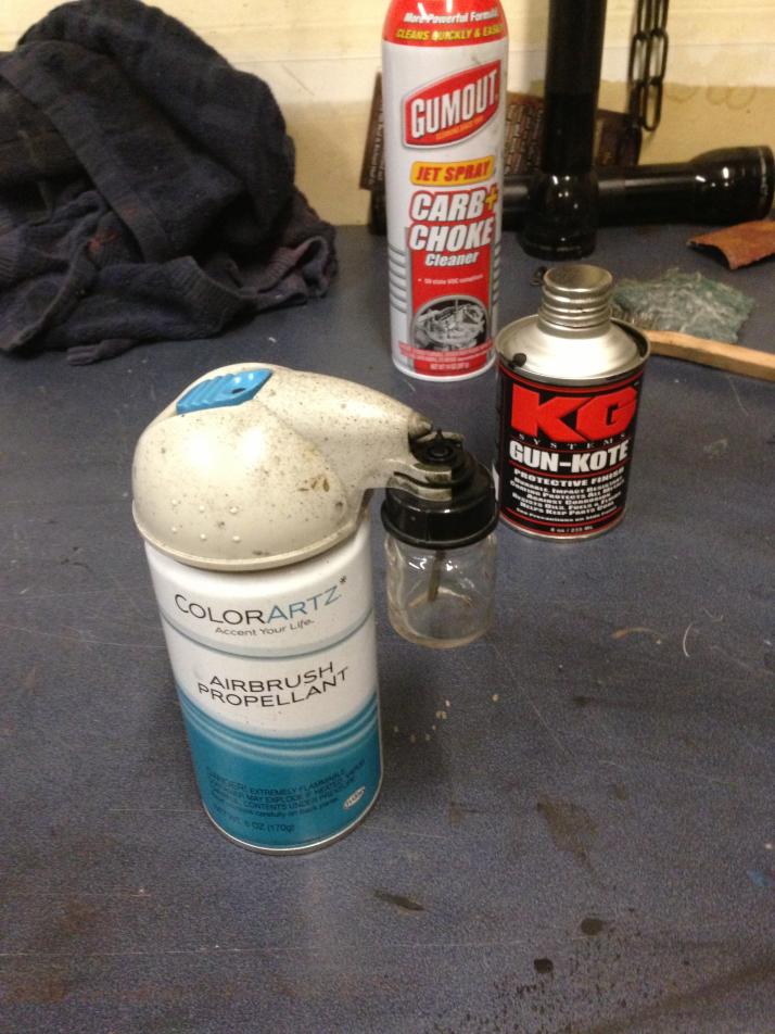

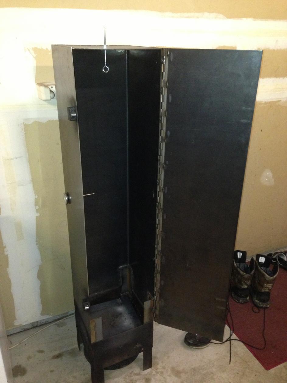

Here's one of my personal cerakote jobs. Just got my 308 back from my smith and it needed some clothes so I ordered up some mil spec od green. Blasted the barreled action down with 80 grit alum ox. Soaked for a couple days in acetone and dried out. I have cerakoted a few times and each time we come up with a little something to make it easier. This time I decided to try a preval self contained sprayer and it worked excellent. No clean up, no pressure to dick with, no filtered air yada yada. Here's some pictures of the project. Needless to say the results are great and easy to do your self.

Preval sprayer and a Keef stone for good measure.
Picture of my hillbilly double wall oven
