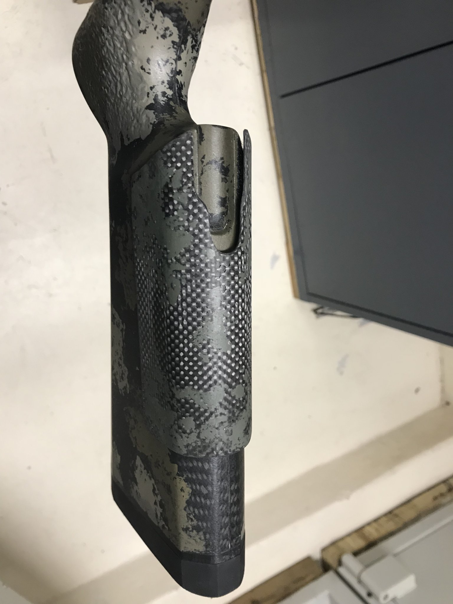

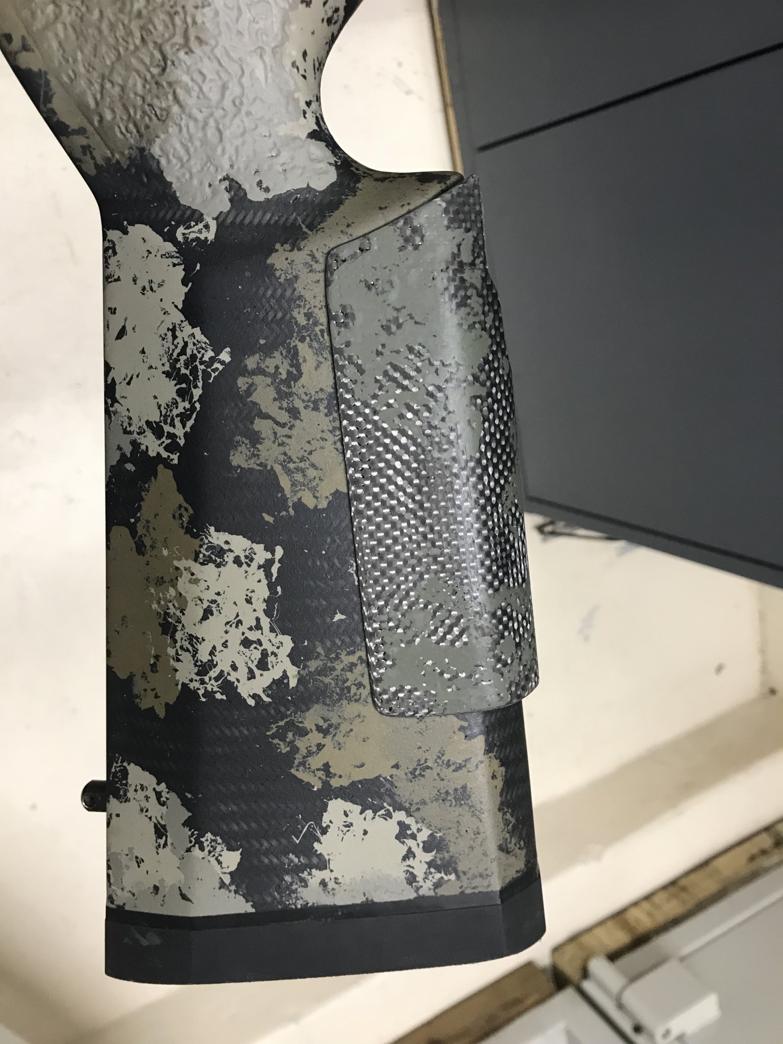

That’s great. I did the same thing on my EH1 using carbon fiber. I’ve used five layers (in the future I’ll add one or two more) of cf cloth and marine systems 105 epoxy. Next day I’ve trimmed it to size cut out a notch for the bolt so I don’t have to remove it and sponged some flat green to blend it in. Best part I’ve only spent $4.16 for the velcro.
