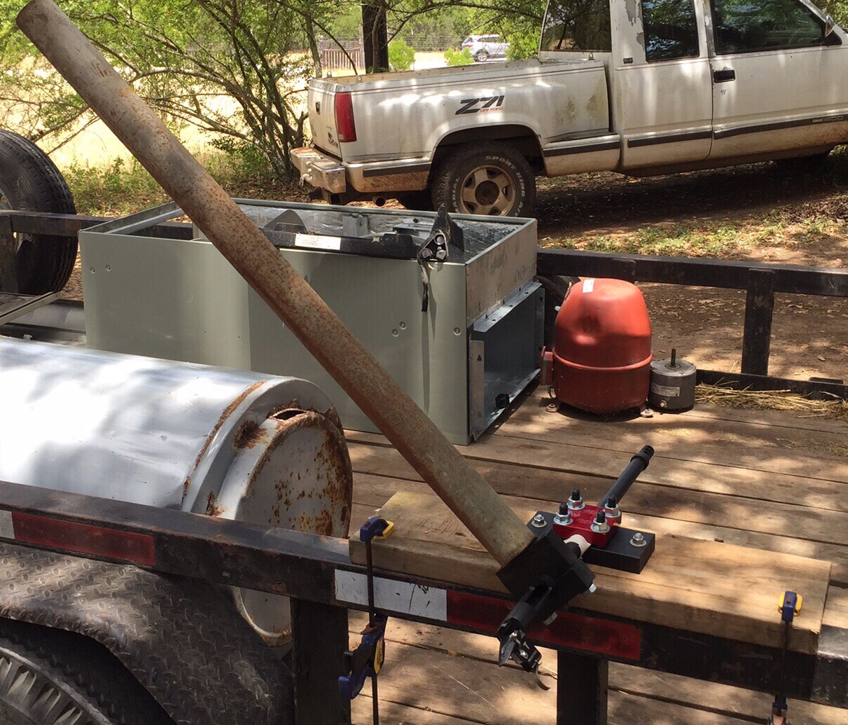

My rem barrel popped easy. It was too hot under the shed so I mounted it to the scrap trailer outside with a breeze. Used a toilet paper roll on the barrel. I barely pushed on the action wrench and could tell I was too skinny so I went and got a breaker bar. No sweat, came right off.
And I feel that not holding the action wrench when tightening the new barrel nut allowed it to slip a thousandth. After torqued the go gauge had just a slight hair of drag as opposed to perfectly free. Not enough for me to bother undoing it again though. Scotch tape on the back worked great as a no gauge again.
Great picture. It shows the mechanical advantage of leverage in both the breaker bar and the grip clamps used to hold the vise to the trailer.
Glad it popped pretty easy. I've seen them easy and I've seen them ridiculous. Glad yours was pretty easy.
