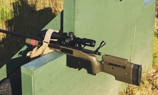

    I bought a used stock today, my first fiberglass stock. Wondering what suggestions you guys may have with regards to painting or cerakoating it. Not sure if this is a common DiY or if most folks have a professional cerakoate or similar product applied. Please share any pics of your stocks either way. Main goal is durability, as this will be used for my PRS rifle next year. Thanks for any thoughts, or pics of your stocks.
    Dan

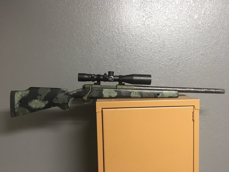

    The AR is Dura Coat and been okay. Not great, but okay The Remmy is Krylon and has held up surprisingly well. I am not gentle with any of my "field" rifles. The Dura Coat gets nicks if banged around and the Krylon has some wear area where handled the most. I have heard Ceracoat holds up well, but I have no personal experience

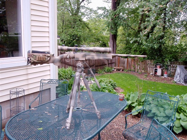

    I’ve paid top dollar to have several McM stocks cerakoted by quality refinishers. I’ve also spent $9.99 on a disposable sprayer from Home Depot and a $30.00 4 oz bottle of cerakote air cure and done it myself. Here’s a Manners EH1-A i did myself. Key is good prep - light sanding and degreasing.
