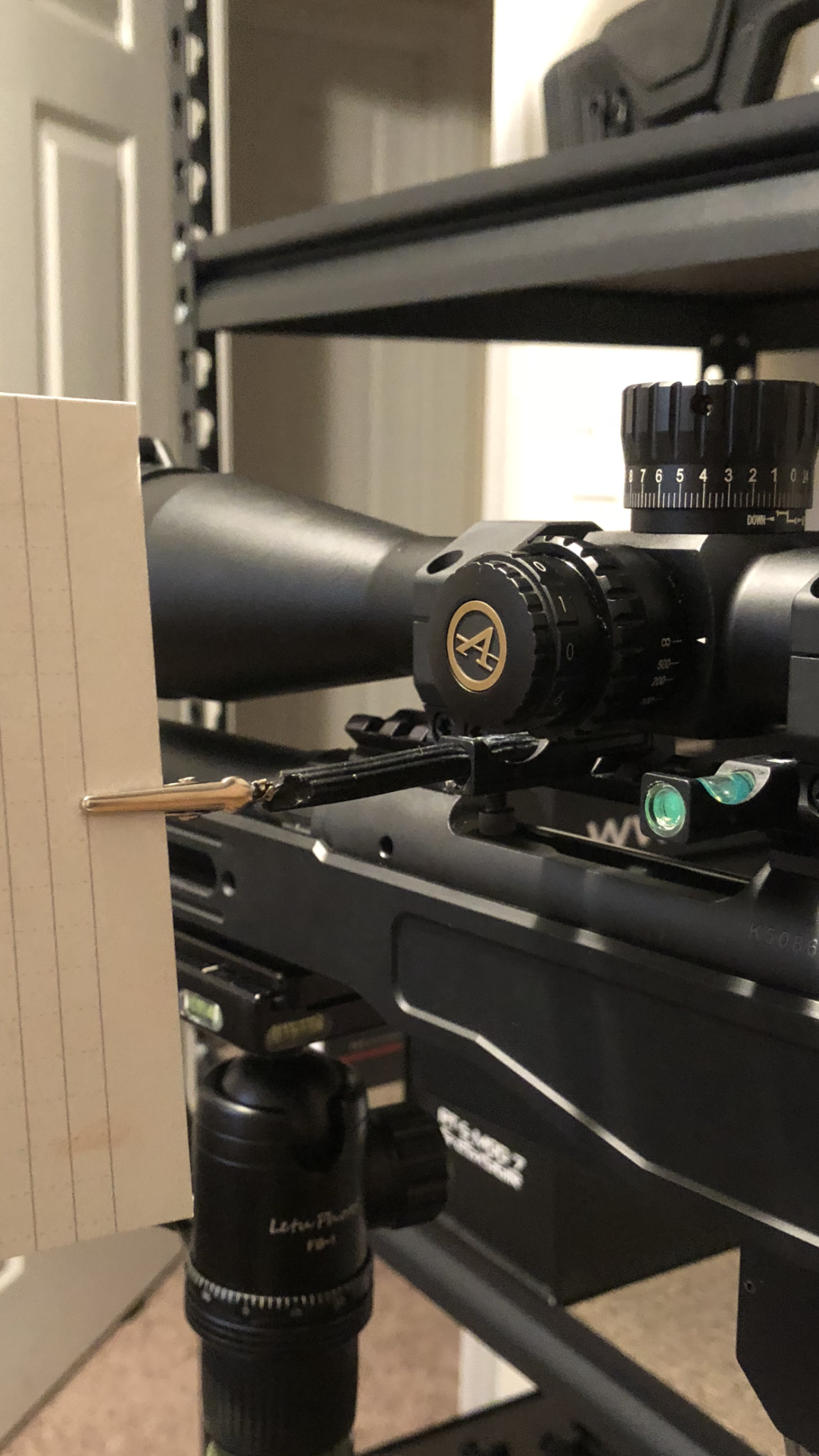

DIY - Picatinny Rail Dope Card Holder <$30

Do it...mostly yourself... Dope Card Holder.
HopticUSA Bubble Level or Similar - $24
Wire Gear Ties - $2/ea
Alligator Clip - $0.20/ea
Set Screw - we all probably have one laying around our work bench.
Step 1) push spirit level out of bubble level housing using punch. should slide right out
Step 2) drill hole for set screw in middle of bubble level
Step 3) cut gear tie to desired length
Step 4) trim 3/4" - 1" of rubber coating off one end of gear tie
Step 5) pinch alligator clip to exposed wire
Step 6) Slide wire into bubble level housing and tighten set screw to lock in place.
