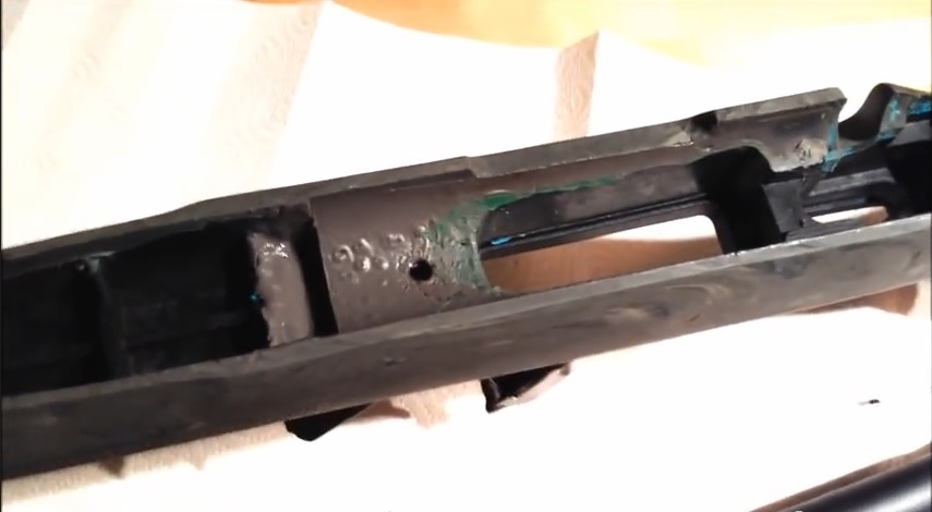

I plan to bed my rifle DIY style soon. I'm reading and gathering as much info as I can. Can someone tell me how this screw up occurred:
Its a screenshot from 29:44 minute mark of this video: DIY: Remington 700 AAC-SD SPS Tactical JB Weld Bedding Job - YouTube
It looks like 2 mistakes: (1) Too much release agent (green floor wax) and (2) not letting the compound dry long enough. Can someone confirm or add to this list of what not to do? Thanks!
Looks like the wax used was not sufficient for this kind of work. I use mold release wax and Partall PVA, or polyvinyl alcohol, which is a super thin spray-on latex glove like liquid that is also water soluble. Also, as you mentioned, the epoxy did not setup. I wouldn't use JB weld for any bedding job, there are better products out there. Play-Dough may not be the best bet either, modeling clay works better.
