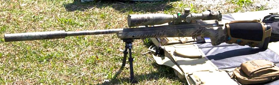

I painted this upper with tape. I did the base color and left the tape on. Next color. Next color. Then peel all the tape off at the end.

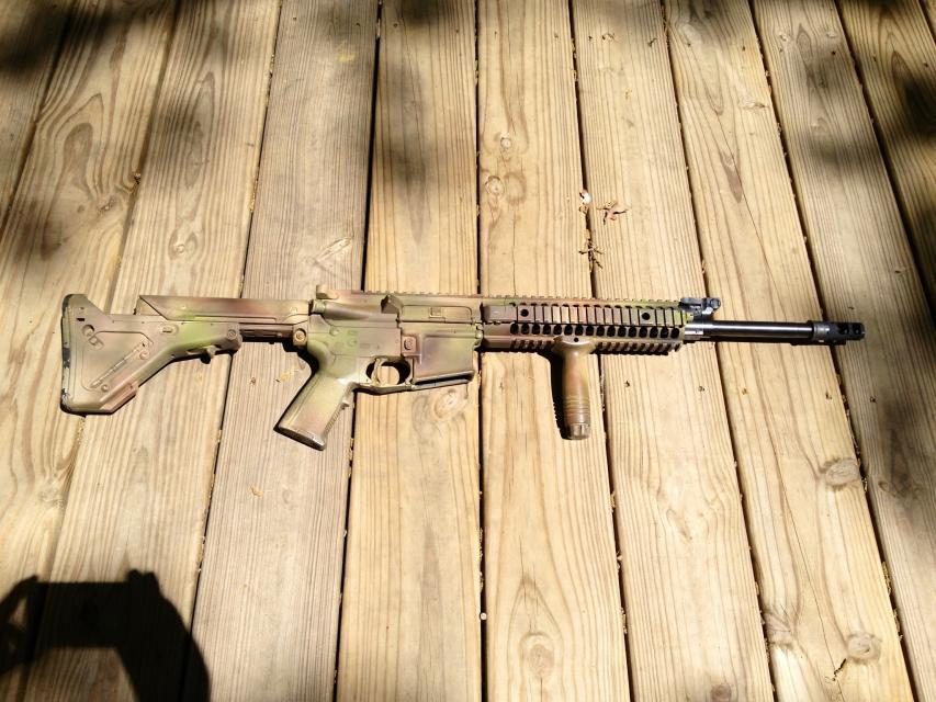

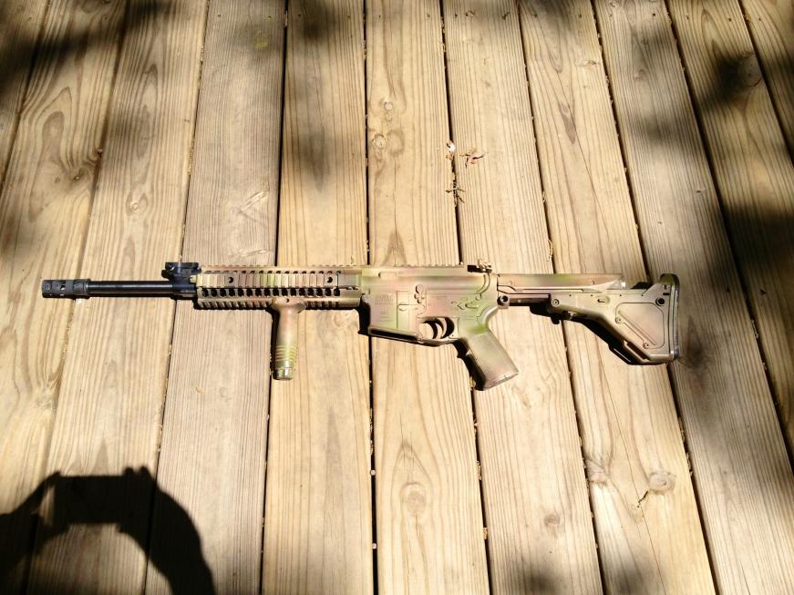

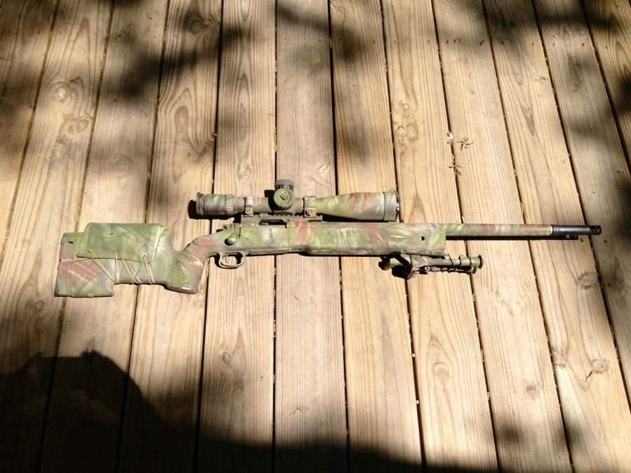

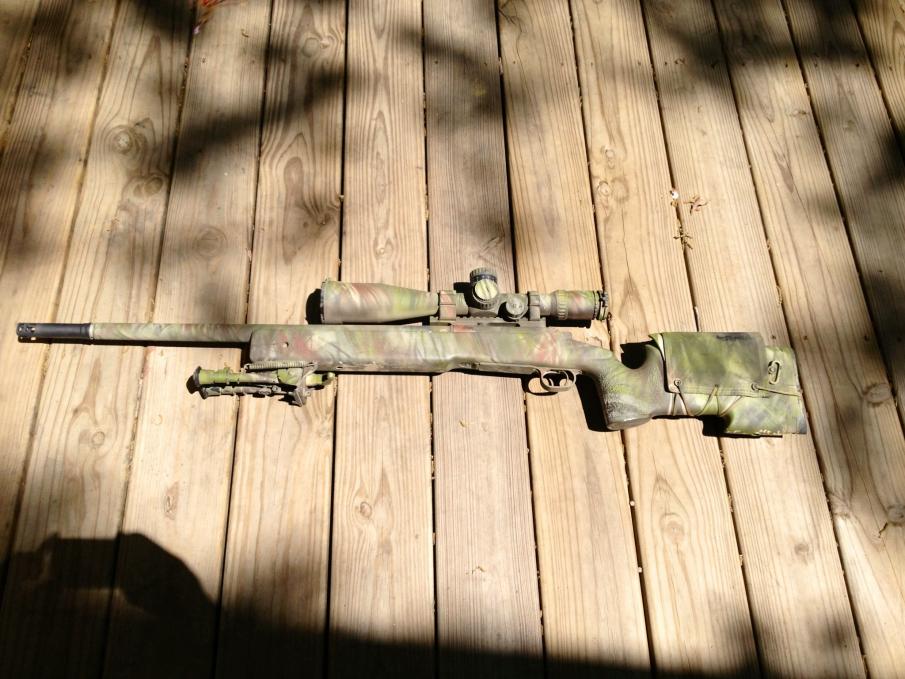

The M4 was done by using a tan base coat and then spotting on different colors in various places. don't be alarmed if it looks like crap at first it will come together in the end. keep applying random sprays mixing your darks and lights and if an area gets to dark lighten it up or the opposite.
The M40 was done by spraying big blotches of random colors and alternating dark and light. then grab some grass or leaves and hold them in front of the rifle, if you are holding them in front of a light patch then spray a dark, if you are holding them in front of a dark patch spray a light color, mix and match till you reach desired effect. again it might look silly at first but it will come together as you keep going.

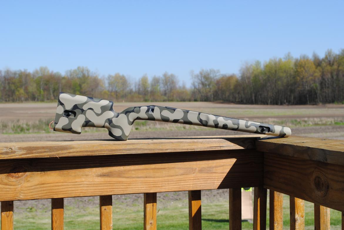

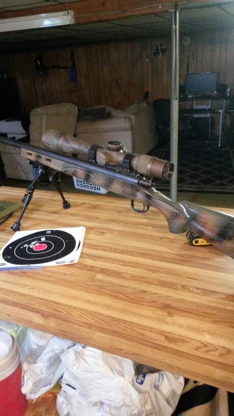

I have used a few different methods of making stencils over the years. First, you can take making tape and use an exacto knife to cut out the stencils, Random is what your looking for, you don't want to repeat shapes. The top pic is using the cutout method. In the second picture, I use a different method, by tearing wide making tape down the center in curved tear patterns, you can make your own shapes and they end up being much less deliberate looking than clean cuts. The last pic is a stock painted with tearing the masking tape

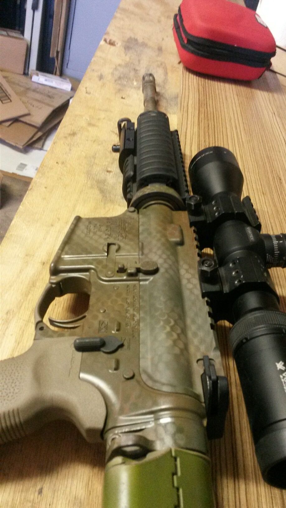

Netting works great! Heres a AR I did with 3 color no stencil spray, then went back over alternating the same 3 colors through a piece of netting. Its a great mix of the clean lines patterns but will has the overspray blend/fade too

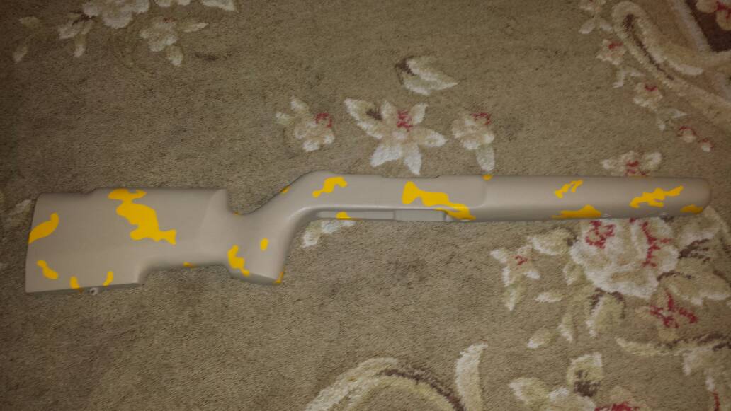

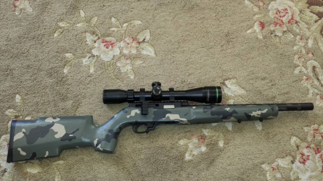

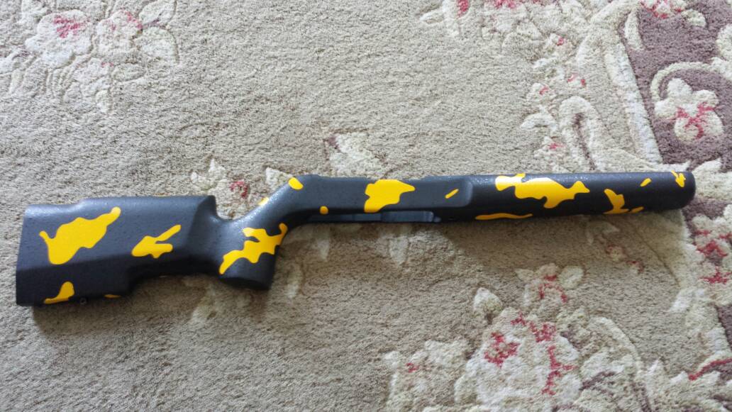

uploadfromtaptalk1410090332566.jpguploadfromtaptalk1410090342276.jpguploadfromtaptalk1410090352085.jpguploadfromtaptalk1410090362979.jpg
