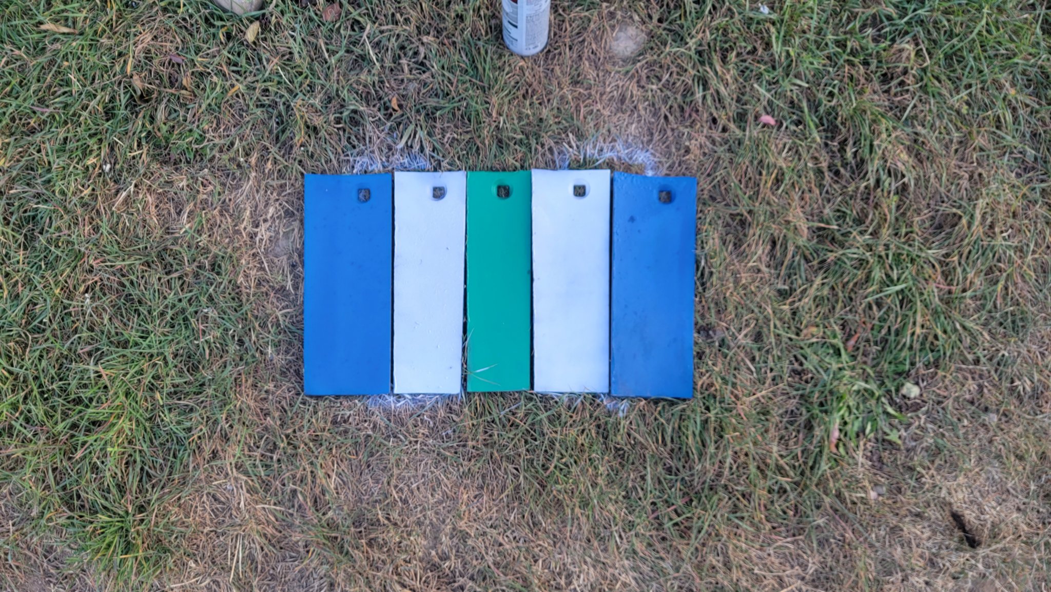

Hoping to set this target up at the 500 and see how it holds up. The middle is 3.5" wide so it's close. It's from a grader blade so they are all wedge shaped but it's fine for my redneck range and I should find out pretty quick if it's hard enough.
Straps will be 2" fire hose.
I'll update you guys once I try it out!

This is the same thing @lowlight uses on his range from Austin angus. However they should be correctly sized for whatever range they will be used at.
.2 wide at whatever range with .1 between

Yup, that's where the idea came from. This one just happens to be free. They are close to .2 mils and the middle one being 3.5" for 500 should be just right. The rest are a little big but the price is right and It's only for personal use so.. 4 - 4.5" is OK with me.
