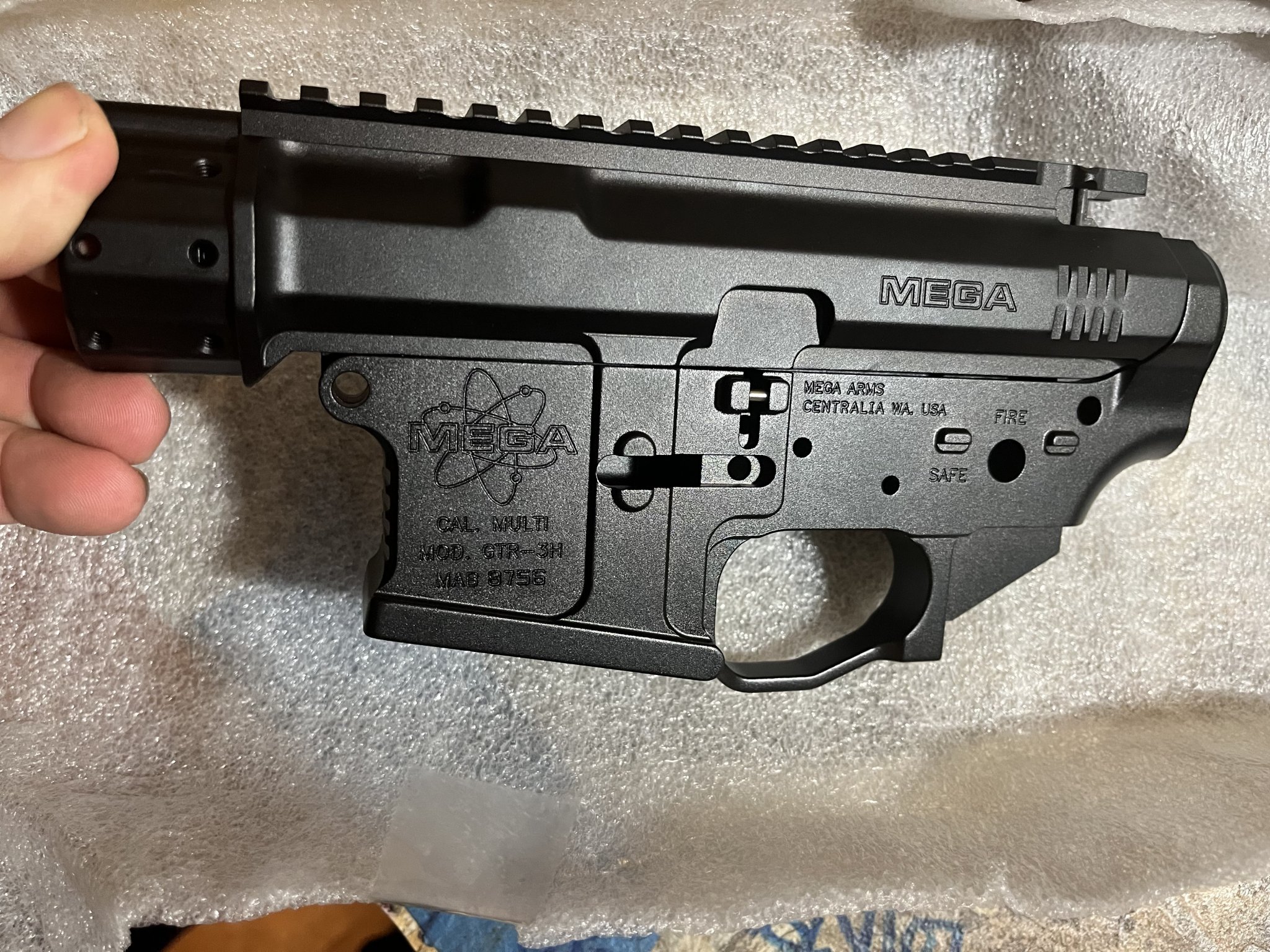

Zev has started back making Mega sets
I like the Zev's as some have the correct Atom roll mark but the color and finish are off. I prefer the Expo's if trying to match an original Tumwater Mega, really hate I sold all my spares years ago.
I can’t comment on the original Mega set, This is my first. From research on here I felt like I missed out with them discontinued until I discovered Zev was back making them. I got to say everything from upper/lower/ handguard locks up like a vault and the barrel was a thermal fit.

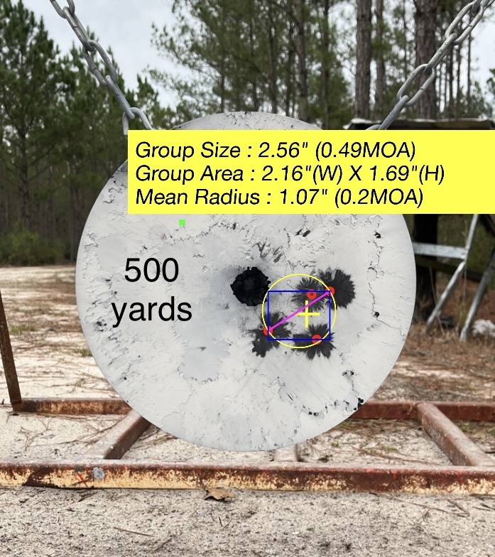

I have finally had some time try tuning a load for it. I wanted the 73 gr ELD-M to shoot so bad but I just can’t consistently keep it below 1 moa, same result in my other guns. So I went to the tried and true 77 gr SMK & minimal load development.
SMK's almost never don't work but the new world 1,000 yard shooter want higher BC................sometimes they are accurate, sometimes not.
And the old SMK plods on........................
Good shooting, great rifle.
MM
Reactions: B Man
I had the same problem with Hornady's factory loaded 73 ELD-M ammo, just piss poor accuracy out of two of my guns so I gave up. I heard the same thing from other people too.
Reactions: B Man
The bullet itself is capable of acceptable precision. The 10-shot group pictured below was fired from a semi-automatic AR-15 with a hand-load of the Hornady 73 grain A-MAX/ELD and has an extreme spread of 0.82". Unfortunately, as you stated the factory load falls short of expectations for a lot of people. And as others have stated, the standard 77 grain SMK is a safe bet in most any decent barrel. A 10-shot group of the 77 grain SMK fired from the same AR-15 had an extreme spread of 0.56".
Reactions: B Man
MM

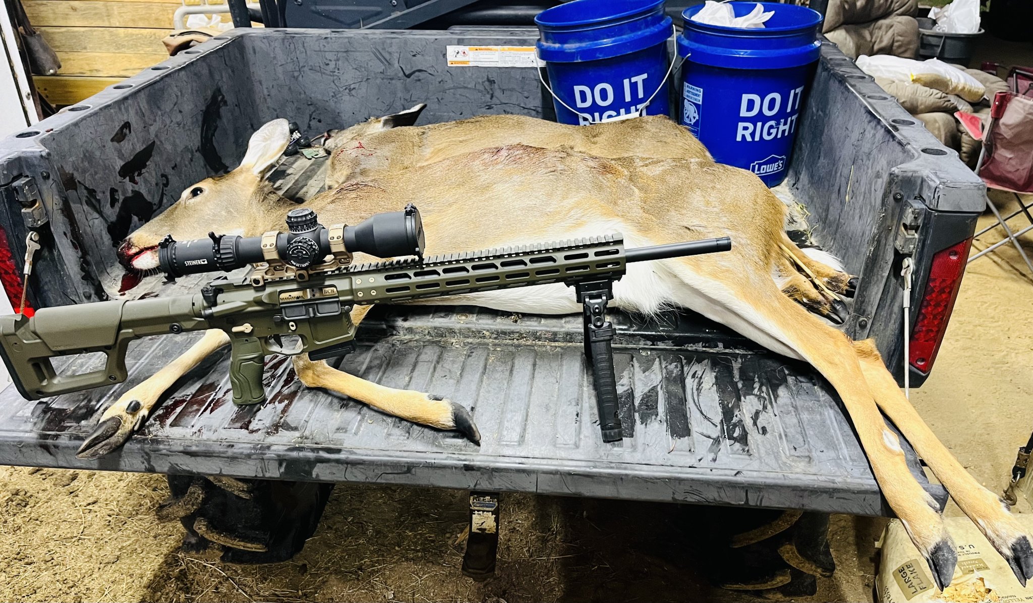

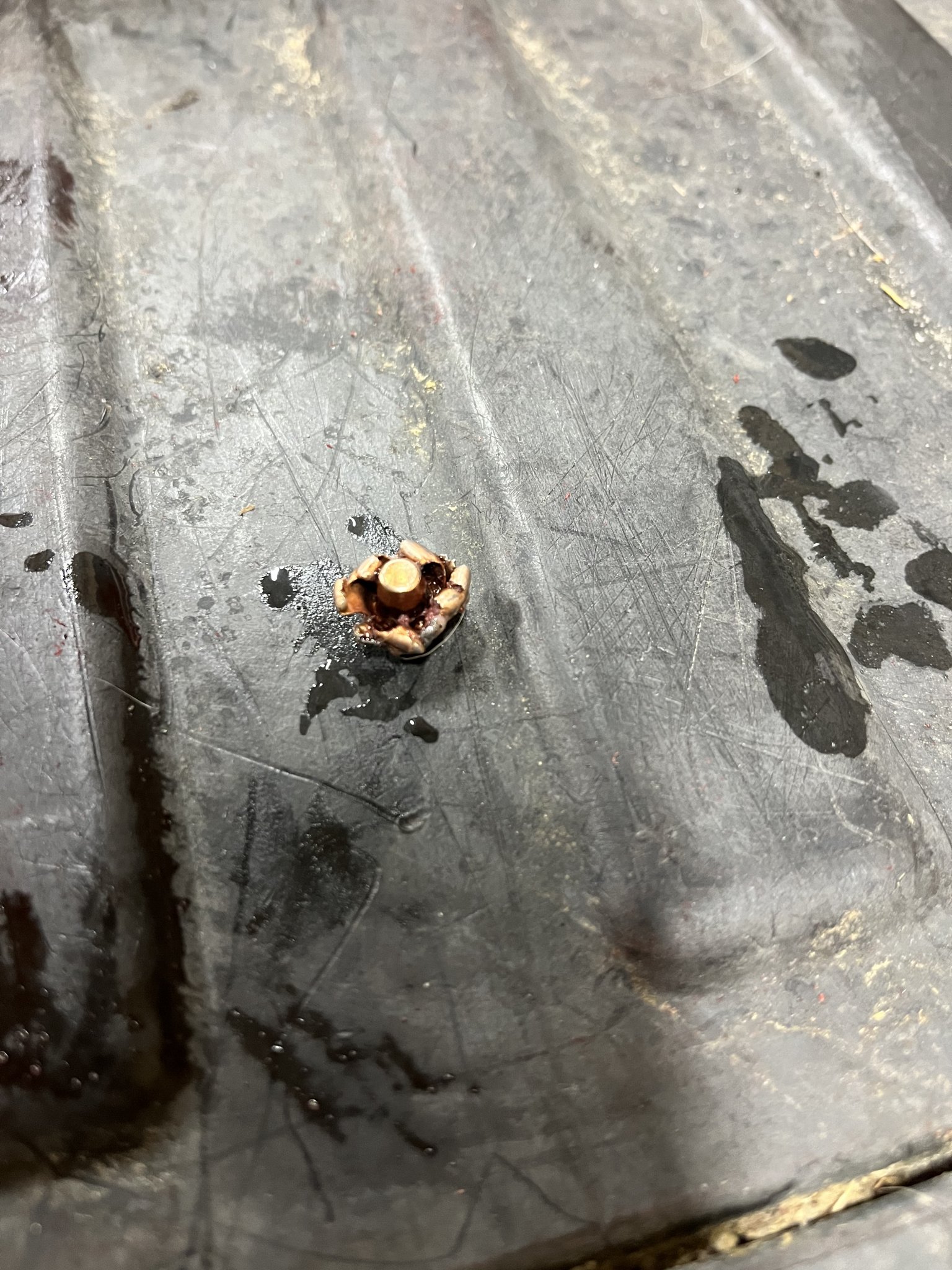

The extra BC is nice if it worked but I honestly wanted it to work badly as a do all bullet with the plastic tip (better expansion) for predators, deer/hog, and the range. I guess when supplies catch up some more and hopefully cost comes down sone I’ll try some TMK’s.
My rifle hates every Hornady I tried...68gr, 73gr, 75gr...not a single one could hold under 1.5" @ 100m. Good ol' 77gr SMK comes along, and now the rifle wont shoot over .75" @ 100m. Best part is, the rifle is a very inexpensive Ruger American Ranch 5.56.
MM
Meh I want a heavy polymer tip for terminal affect. Not many out there besides the TMK. Is. Sucks the eld doesnt shooot. Was about to buy some
