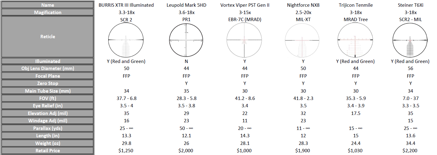

So I'm finishing an AR-10 build in 308. I'm running a 20" barrel and trying to pick out an optic. I think I've pretty much narrowed it down to these. Though I'm always open for suggestions. My target budget is $1000 -$1200 with my military discount.

As far as your list of prospects in regards to your budget, I'm a little confused. I doubt you can get a NX8 for $1200 with a MIL discount. Same goes for a Mk5 with a Horus reticle or even the PR-1. The PST is way under your budget. If you could stretch your budget a little, I would recommend a 4-16x42 ATACR in reticle of your choice. They come and go on the PX pretty often for $2Kish. Nightforce has a MIL program but kinda stingy. Eurooptic is often cheaper with MIL. I bought a couple demo Nightforces from Eurooptic and they were perfect.

Yeah they're not happening for $1200. I haven't looked on EV yet this year to see if there was any price increases but the cheapest NX8 configuration was a few hundred over that last time I checked. No idea on Leupolds mil pricing though, I don't get that and I'm pretty sure that's direct, if it's on EV I don't have access to it. I can't imagine it being $1200 though.
Reactions: 1911hombre
It's just a little north of that but close enough if it's worth it. $1000 -n$1200 is a target. My limit is $1500

No way I'd pay $1,900 for a NX8, might as well look for a used ATACR.
