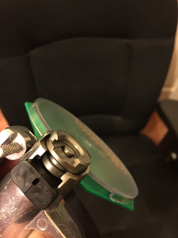

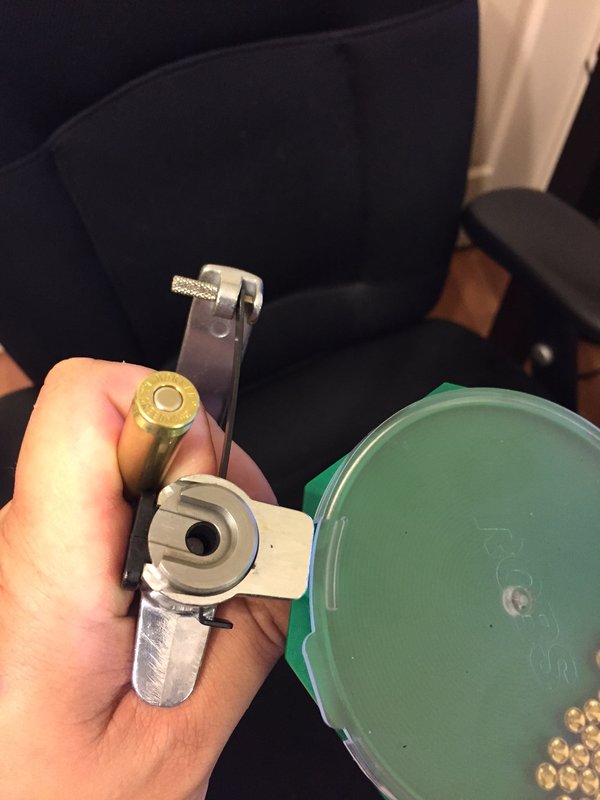

Sometimes the edge of my primers come out a little deformed with the crescent shape you are talking about when primed with the RCBS handheld tool, around 60-90 degrees around the circumference primer. It seems like it's caused from the lack of concentricity allowed by the diameter of the clearance hole. If you play around with the tool you can develop a feel for a way to prime the brass that will minimize the extent of the physical deformation. I personally haven't noticed too much of a difference in the performance of the rounds with the damaged primers so I don't think that it's a huge deal for me, but I am still interested in any priming tools that can offer an improvement.
