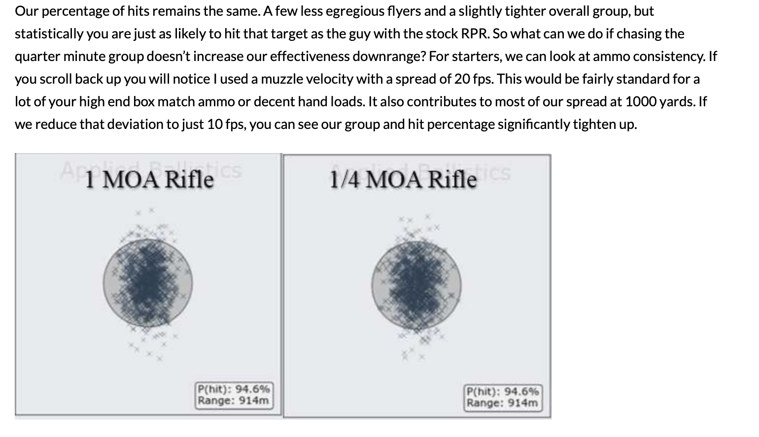

I would be careful how guys are using the WEZ as they misunderstand the inputs and what it is telling you
There is an article right now on FB running around showing a 1 MOA rifle and a 1/4 MOA rifle shooting the same at 1000 yards based on the WEZ Results
It's helpful but they have to use it correctly,
You have to look at the wez inputs. It is what it is. Run wind from 2 to 4, velocity from 2800 to 2850 etc etc. its basically a random number generator with bounds set by input values. Think of it as I guess N will be between x and y. If x and y are off you get crap. The moa of a rifle is only a small percent of the input. Try using fixed numbers - ie wind 5-5, mv 2800 - 2800 - change the moa. If you change everything you get nothing.
That picture definitely fooled me than. I dont understand, is the program just completely wrong or are people using it for the wrong application?
Once again, you have to isolate variables. Read the text in the image - muzzle velocity 20 fps spread. Imagine shooting with sight height between 1.5 and 2.0 for example. Wind speed and muzzle velocity will be the biggest variables, but every input counts..
How does a rifle shooting 1/4 MOA have the exact same percentage at 1000 yards as a rifle shooting 1 MOA
If you skew the 1/4 MOA rifle to appear like a 1 MOA it will,
But a 1/4 MOA is probably gonna have a lower SD which is part of it, you can have the same MV but a true 1/4 MOA rifle vs a 1 MOA is not gonna be the same at 1000 yards.
These are NO Wind conclusions in the article.
Part of the problem is the way it looks at the values if you use the same BC and MV it will make it identical, but it's not
This is not my data, I'm just saying people are using it wrong because they are making it appear these two situations ar equal
I know how to use the WEZ, though I use the Error Budget more so in CB 1, vs AB, but it's the same, the Error Budget and WEZ do roughly the same thing
In simple terms, because they used a 1moa target with zero wind and a perfect shooter assumed.
If you take a 1moa target, with a 1moa gun, no wind, and the perfect shooter......
No shit that it’s gonna hit the target the same amount as a 1/4moa gun with no wind and a perfect shooter. Both the 1moa gun and the 1/4 moa gun are inside the error margin of a 1moa target. You’d get the same data from a 1/16th gun almost.
Now, add a 5mph wind in there. And shooter error who misreads its as an 8mph wind. You’re gonna wish you had that 3/4moa extra error built in.
Yep. This is what happens when it’s so easy to publish data online.
Now we have someone with no real knowledge manipulating the WEZ prediction to incorrectly show there is no advantage to a 1/4 moa gun over a 1moa gun.
And people are eating it up.
I guess the interesting question is how can one define a rifle moa and also define a muzzle velocity variance. So it is possible to enter a .25 moa rifle with a 100 fps muzzle velocity spread. Thats a problem...
Yea, they likely didn’t think anyone would be dumb enough to manipulate the numbers and try to post white paper like data.
But, you know how people are.
It's not hard, but it's also not linear
Just because a guy can hold 1/2 MOA at 100 does not mean that at 200, 400, 800, or 1000
The growth is more like 1.5x MOA then it's compounded by the wind.
Trigger control is the most common problem along with inconsistencies in hold and position. In other words, most people not only tap or slap the trigger but move between each shot changing their position which also has an effect.
So if you say, you have a 1 MOA rifle, the next question should be WHERE ?
100, 400, 800, 1000 ?
Then you can begin to see how things quickly change.
For me, if I was putting in a .25 MOA rifle I would do 10fps SD spread or less, then for a 1 MOA, it would be a 20fps average like noted with factory ammo. After that, you want to consider shooter error maybe use an offset for that, like throw in 20fps extra of SD depending on how you want to calculate it
In this case, the data is setup for testing if a mechanical increase in accuracy would affect downrange results if all other values were equal. Given the parameters, one could instantly intuit the results, you don't even need the software. This is a very poor 'experiment', if it could even be called that. That's not how the tool is used, and if you don't understand how a tool works you should probably not be using it.
You must be careful about the underlying assumptions used in the model. In this case, where and under what conditions do we get 1/4 MOA and 1 MOA? For example, to get a rifle specified at 1/4 MOA to hit a 2.5" circle at 100% at 914 meters, you basically need to set all uncertainty values to 0. Setting muzzle velocity to a 10 fps variation reduces the hit probability to 64%. If you then reduce the mechanical accuracy to 1 MOA, the hit percentage drops to 26%., but a 10" target is 98% compared to 100% for a 1/4 MOA rifle. The 1/4 MOA rifle is 94% on a 5" target and the 1 MOA rifle is now 70% . This makes sense, but look what you did to the underlying assumption. While you specified the rifle to shoot 1/4 MOA, to actually do that at 914m your muzzle velocity variation must be ZERO! If you set the variation to 5fps, you only get a 90% hit rate. I'm not sure you would say that rifle is a 1/4 MOA rifle at that point. At 9 fps you are 64%, clearly not shooting 1/4 MOA with even great handloads. Does a 1/4 MOA system at 914m even exist? If you take a system that performs at 1 MOA under given conditions, that is, it gives better that 98% on a 1 MOA target, why would you expect a change in pure mechanical accuracy to change much of anything at all?
Note also that other variations are not used in the WEZ simulation, like BC variation, aiming error, zero or scope error, etc. If you ask the wrong question, don't be surprised if you get a nonsense answer.
Just look at the author. Makes complete sense at that point.
I never even looked up the article, the pic was enough to tell me the author does not know what they are doing. Since there is no link to the page, I'd have to do some kind of search to find it. Way too much like work to bother considering what I'd get.
Well, I don't know the author, but give the resume on the site it seems clear he does not understand the fundamental flaw in the analysis. Of course, most people either failed or never even took a class in probability and statistics.

Just to restate, because this is the cornerstone these guys getting fucked up.
Take a 3/4 MOA gun at 100, shooting at an MOA target at 1K with 0 SD & 0 WIND. What happens with the target image growing and shimmering in the distance? Is it a tiny .75moa visual disturbance? If so, the base gun is now 1.5MOA, plus all the other great things like SD and wind variations.
Optically the targets at 100 are not affected the same as the target is at 1000. The premise that you can even visualize the target the same is at the core of the error stacking these guys seem to conveniently forget about.
The better experiment and there are two immediately I can think of,
1. take two rifles of different accuracy potential, one that shoots like 5/8ths and the other that shoots 1/4 even if the ammo is different, and map the growth at distance. Establish a base group, then walk out and note the variation between the two different rifles with a single shooter.
2. The other experiment, take a new-ish shooter or any level of shooter and under "today's conditions" walk out and see how the group grows and changes at a distance and apply a value to that.
The Human factor is huge and combined with a rifle that is not shooting optimal sub 1/2 MOA groups, see how the conditions increase the variation in group size.
So if you have a 3/8th inch shooting rifle, at 100, what does that same rifle and shooter do at 1000, etc.
The biggest problem here is how the precision and accuracy of the rifle is defined. My guess is that most "1/4 MOA" and "1/2 MOA" rifles actually produce extreme spreads at 100yd in the .8-1.4" range.
We're good at tricking ourselves. If I shoot a series of 5-shot groups that measure .43, .51, .47, .32, and .26 at 100yd, I have a sub-1/2 MOA rifle. If the next time I go to the range and I shoot .63", .44", .70", .52", and .39", I must just be having an off day or perhaps the wind is gusting out there and kicking a few shots off or maybe I got sloppy with the fundamentals, but I have 2 groups today and the majority of groups from the last trip out that prove the rifle is sub 1/2 MOA.
If I overlay all of the groups from both range days over each other referenced by a mutual point of aim, what was probably produced was a 1.0-1.4" composite group that is what honestly describes the precision/accuracy of me and my rifle. Doesn't sound as sexy as sub 1/2 MOA though.
A factory rifle is going to be more like 1.2-1.8", I'm sure with a handful of exceptions. Don't believe me? go make a 1/2 MOA 20-shot group.
With careful setup, you can put two acoustic targets in alignment so that you can see EXACTLY how a smaller group at close range enlarges at increased distance, and that even without the aiming error of the long range target. Even tiny differences in the bullet BC start to compromise the group at distance where the effect is invisible at 100.
Although, the article does inadvertently make a point, simply buying a rifle advertised to give 1/4 MOA groups won't absolutely improve the results of a shooter only capable of 1 MOA . In fact, if the rifle actually does shoot 1/4 MOA, the shooter probably can't tell.
