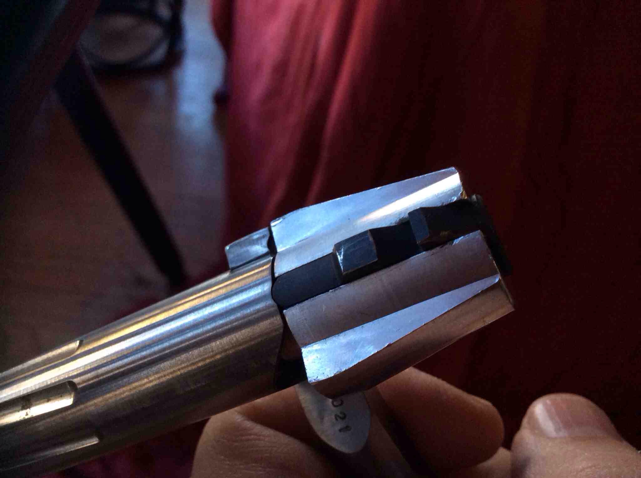

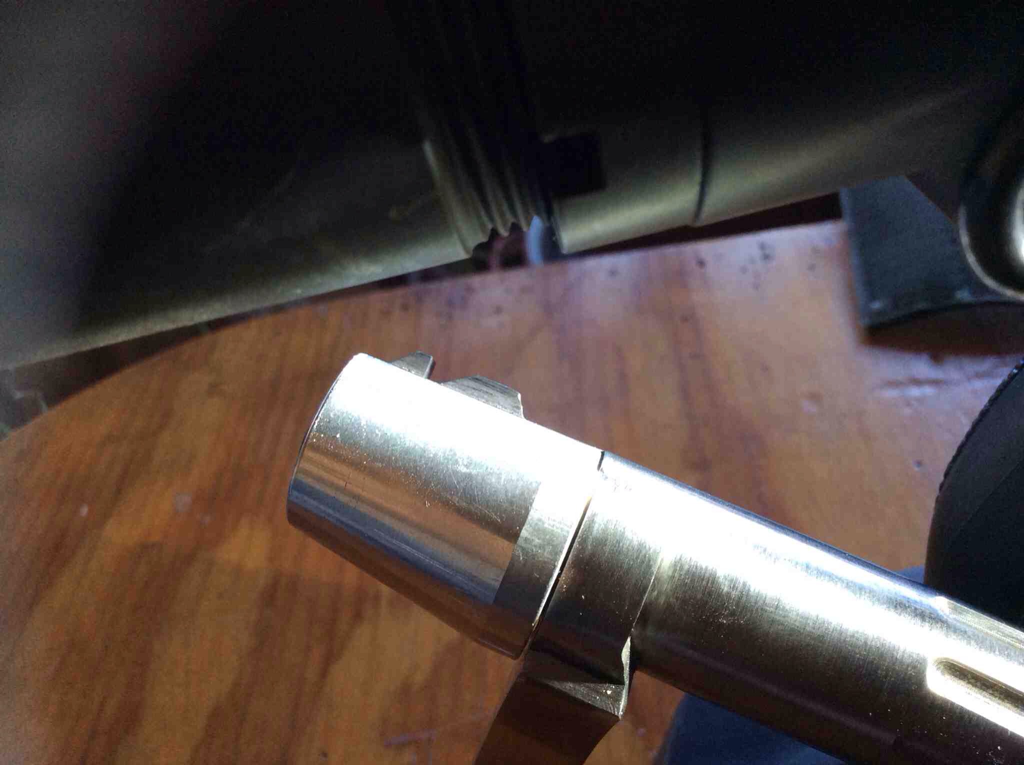

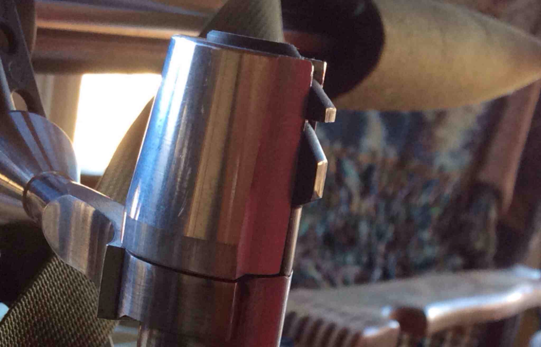

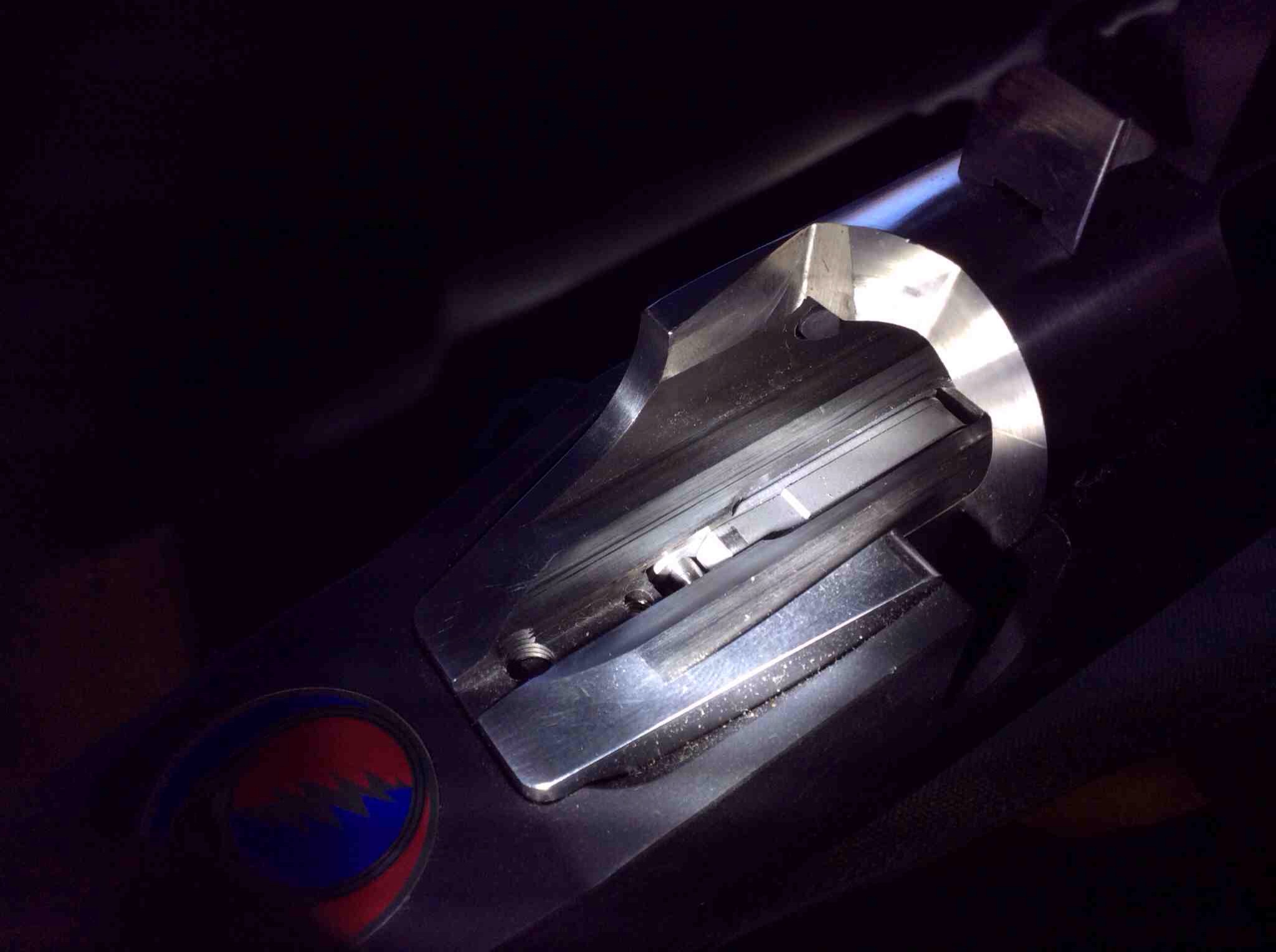

Going through the final assembly of my 375CT project; Lawton 8000 action and barrel; XLR Chassis, Jewell BR trigger (w/ safety in trigger guard) set to 2 lbs, NightForce 5.5 - 22 X 50 scope. Here's where I ran into a hitch, quite literally:
After installing the trigger, I assembled the barreled action into the KLR chassis and mounted the scope. At this point I noticed the bolt seemed to bind when I tried to install it, but I didn't think much of it; I mean, I had gotten the best of everything; what could possibly go wrong?
I found that part out when I lifted the bolt handle from the cocked position and the firing pin snapped forward (!). Lifting the bolt handle from the cocked, fired position was difficult, as if the bolt were on a bind; I found that if I pulled the trigger OR pressed on the cocking piece cover, there was a small, secondary "click", barely audible or tactile, and then the bolt would rotate open, but still with some minimal binding.
Whisky Tango Fox-freakin' Trot.
Out comes the magnifiers. The cocking piece looks like it was accidentally touched against a grinder on the leading edge where it engages the trigger sear, significantly reducing the engagement area. Am I right? I took some pics below; I'd appreciate any opinions, especially as far as I know, Lawton Machine is sadly a thing of the past; I placed this order with Barney himself shortly before he passed and to make a long story short, I thought I would never get this barreled action. Now I found out there were some problems with a secondary contractor producing bolts for the 7000 series actions, but supposedly this didn't affect the 8000 series. Help, advice, please!
Sent from my iPad using Tapatalk HD

I would say you have a problem with the depth of the trigger hanger. It sounds like the trigger is too high and it's binding the bolt up but that is just a guess without seeing things.
Thought about that, and I think that is quite likely at least part of what is going on. However, I'm still concerned about the face of the bolt catch. Those are supposed to be square; this one has lost almost 2/3 of its engagement with the trigger sear....am I right?

Had a couple of PMs from knowledgable persons about the last actions Lawton produced. The original vendor wasn't getting paid and declined any more business; so Lawton used a local vendor. The upshot is that this vendor probably tried to time the cocking piece (which is NOT supposed to be a Rem cocking piece, which this appears to be) by putting it on a surface grinder to get and engagement face perpendicular to the trigger sear. Also this second vendor did not heat treat the extractors properly, making them another problem waiting to happen. The firing pin is sintered and uncoated, not solid and hardened as called for in specs.
No kidding.
Will be sending bolt back to original vendor for rework; will give me time to get monopod fitted to buttstock. All I keep thinking is that I'm glad I didn't have the urge to stick a live round into the chamber and then open the bolt; it's taken so long to get this gun together for various reasons that enthusiasm almost won out over safety.
