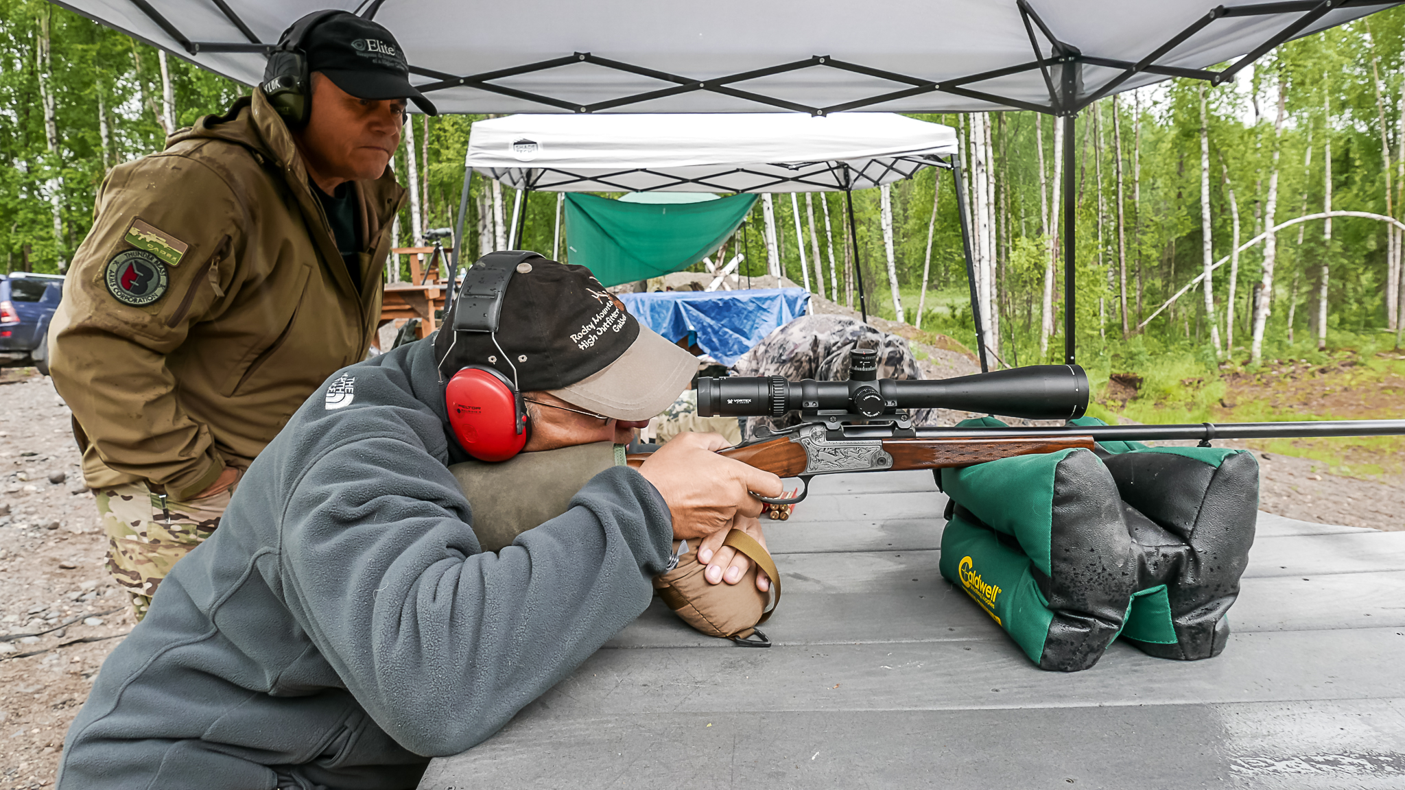

Do you look like this when shooting off the bench, if not, that is your problem, you can remove the bag and use a bipod, but the position should look the same?
This is the key to recoil management on a bench.
I'm probably not sitting as square as he is. I'm trying to keep my left shoulder back , but I'm sitting in an angled cutout on the bench so I'm probably not getting over behind the rifle enough. I imagine that it really hasn't showed up on the smaller calibers being off some to the side, but is really kicking my ass on the heavy recoil of the 338. Another thing, the cheek rest is really smacking my cheek/jaw on the recoil too. Too much downward pressure? I'm not trying to hold the stock down but trying to keep a solid weld on the cheekrest.
Interesting scope choice for a single shot rifle.
Looks like something I would do.

To Frank's picture, if you are not square like the pic, you can imagine under heavy recoil, the butt will slide to the right and down, having your poa after recoil among up and left. I was making the same mistake early on, and even showed up on small cal. I usually shoot prone but when moving up to avoid mirage(shimmer), my groups would worsen and poa would jump more. Frank's and Marc's training up in Alaska hammered this in.
