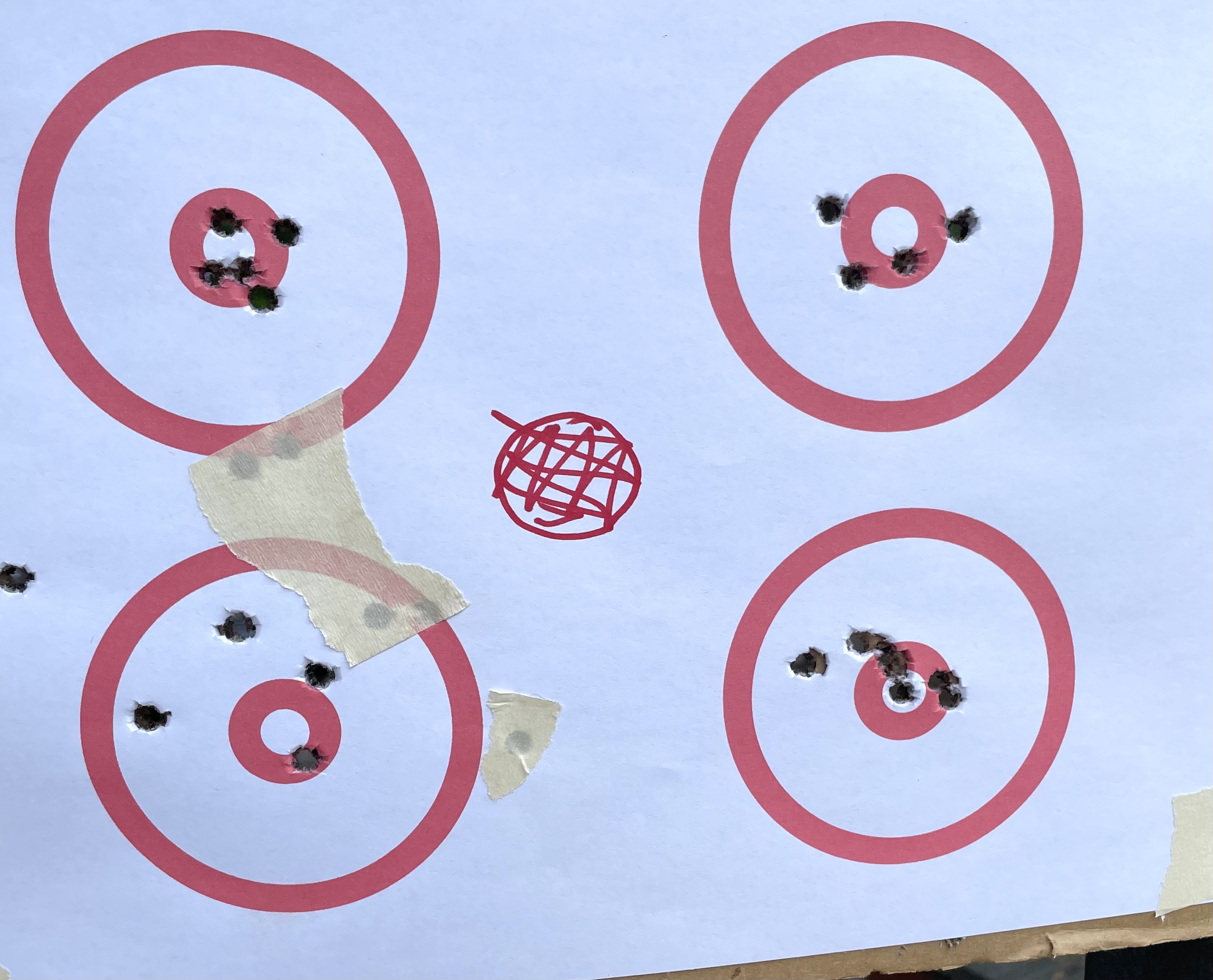

Here's an illustration from thisd afternoon's range trip.
Point is, 69 SMK is far more accurate than 55 FMJBT. This carries across different powders/primers/brass.
  • Distance: 100 yards
  • Rifle: Barnes Precision, 18" 1:8 stainless barrel, Vortex Strike Eagle 3-18x44 @18x, suppressed
  • Brass: LC, trimmed to 1.750 +/- .002
  • Goal: Compare CCI 450, CCI 400 primers with otherwise same load. Result:
    • 69 SMK, 25.3 Varget showed no difference between CCI 400 and -450
    • 55 FMJBT, 25.3 H335 --> 450 was 30fps faster
Targets: Center red circle is 7/8" edge to edge, outer red circle is 3 1/8" edge to edge. Targets shot in following order:
  • Upper left: 69gr SMK, 25.3 Varget, CCI 450, 2705fps (5 shots)
  • Upper right: 69gr SMK, 25.3 Varget, CCI 400, 2705fps (4 shots)
  • Lower left: 55gr FMJBT, 25.3 H335, CCI 400, 2920fps (5 shots, one near edge of paper)
  • Lower right: 69gr SMK, 25.3 Varget, CCI400, 2700fps (7 shots in ~20 seconds, leftmost two shots are last two fired)
  • (NOT SHOWN: 55gr FMJBT, 25.3 H335, CCI 450, 2950fps - accuracy [or lack thereof] is the same)

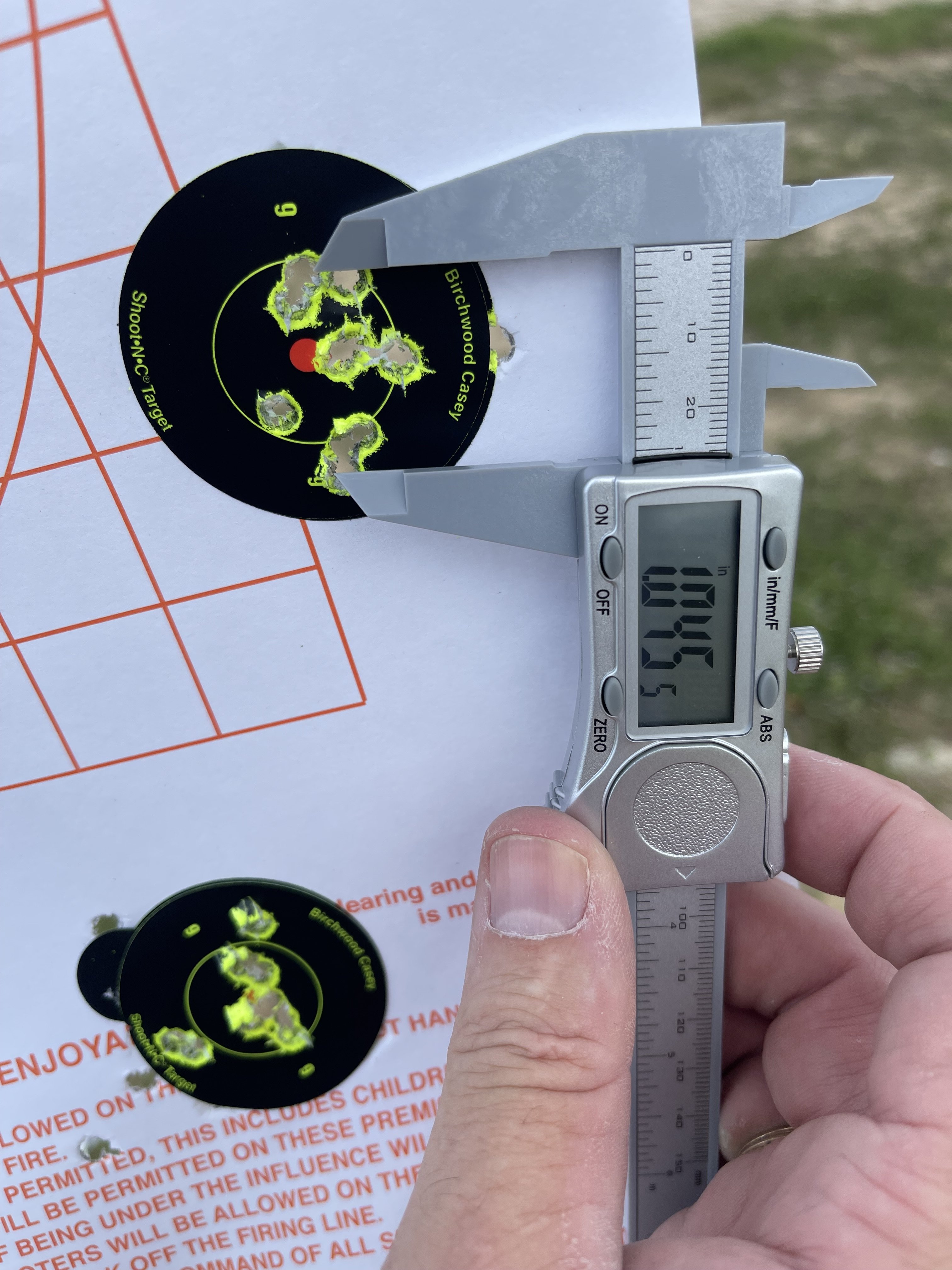

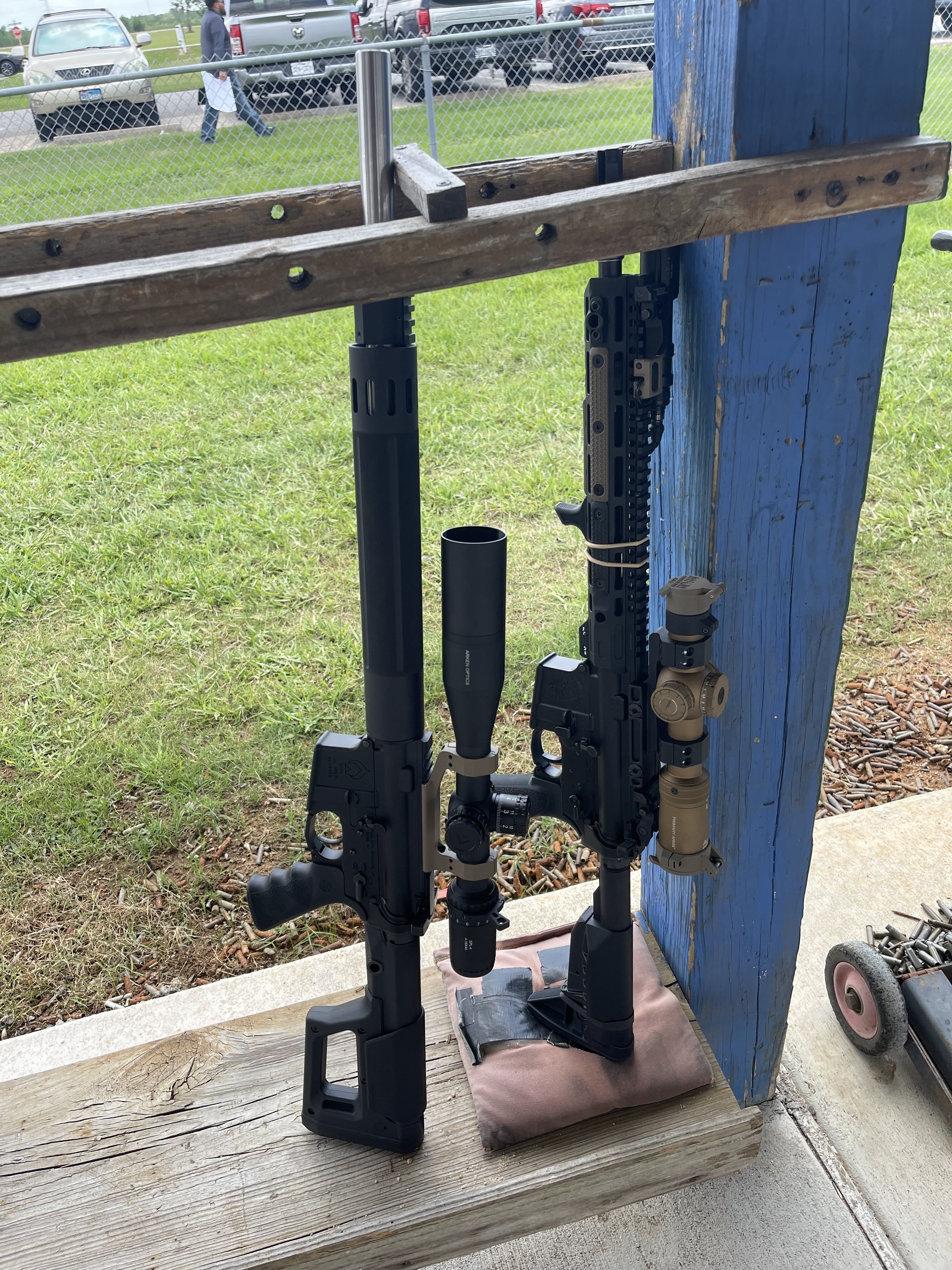

I’m back to confirm what everyone shared with me. I put 130 rounds through the gun, 10 at a time, all heavy otm rounds. I put 13 2” pasters on the target and fired 10 rounds at each one.
The ammo (in order it was fired) was:
- Hornady Frontier Match 75gr otm
- S&B Tactical 77gr hpbt (smallest groups and most consistent)
- IMI 77gr razorcore otm
- AAC 77gr otm (with AAC bullet)
I had little problem keeping all 10 in the paster, even when I forced myself to fire quickly (1 round every 2-3 seconds).
My groups started to open up when I got to the IMI and the AAC. The gun was getting really hot and the stainless bull barrel wasn’t cooling off much during cease fires.
I was getting tired towards the end and got a work call and had to pack up and leave, so I don’t have as much detail as you guys are used to. I’ll do better next time.

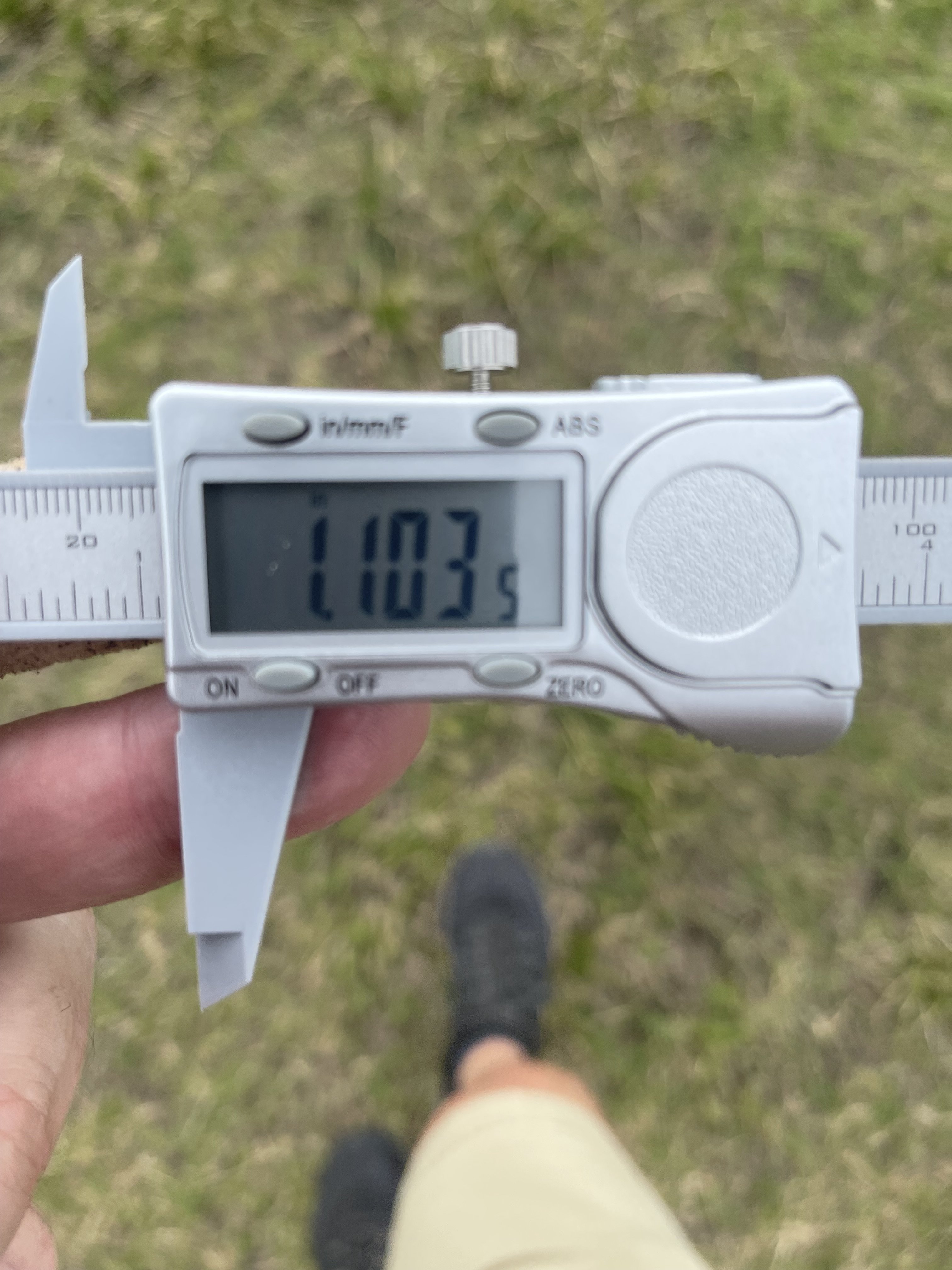

I did take a quick measurement of the smallest group, 1.1”, which I’m happy with and the majority of rest of the groups fit In the 2” pasters. The last 3-4 were between 2 and 3”. The 1.045 group pictured was from a previous sighting in trip and at 50 yards. I added it to show the pasters that I use.

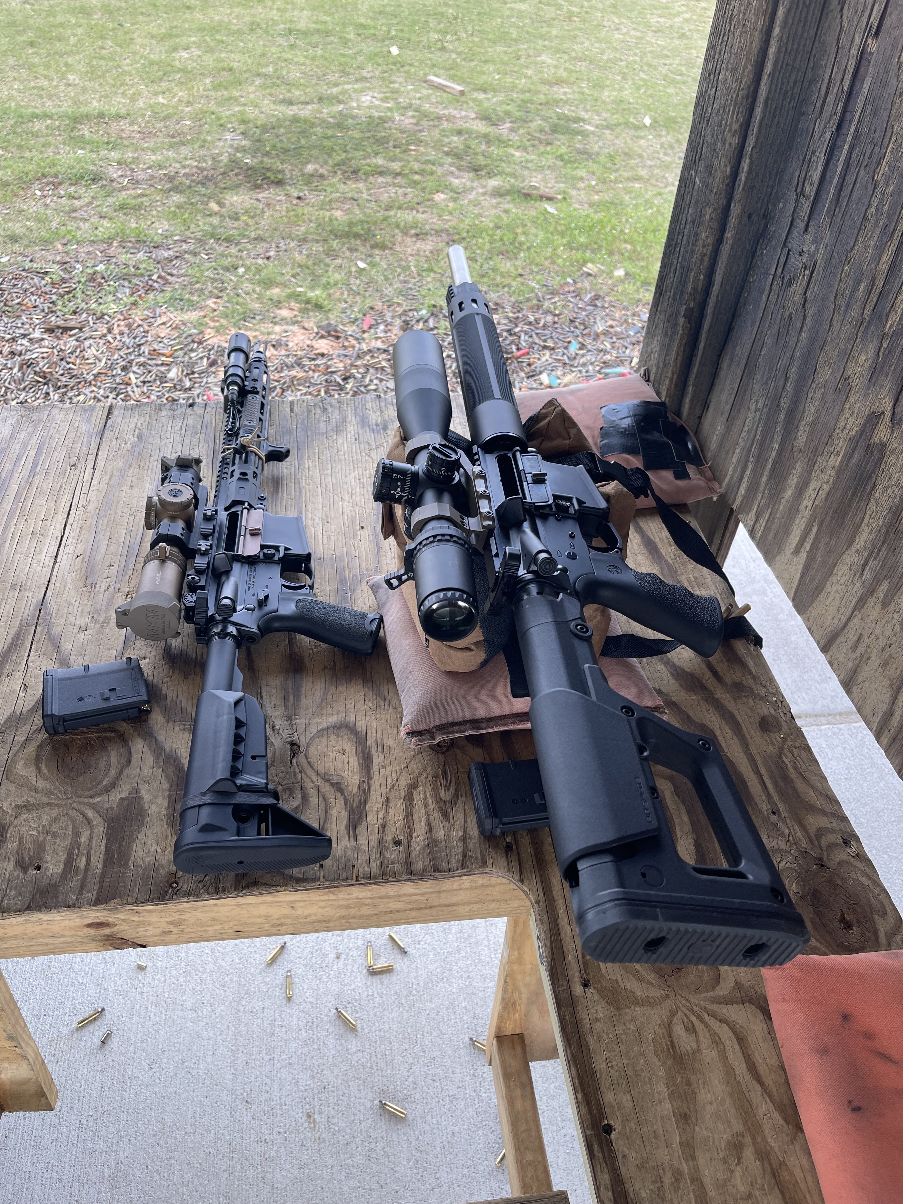

The gun I’m using is the heavy barreled one in the pics.
This was my first time at 100 yards with this rifle and my second time shooting it, so I’m happy with it so far. My son and I are taking a long range shooting class in a few weeks, so I’m very excited to learn more!
