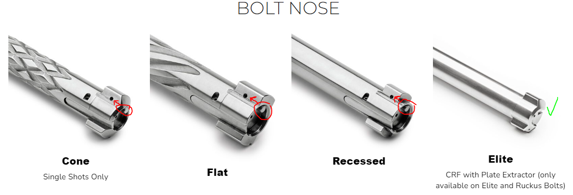

If you have a crf rukus with no spring ejector then you are good.
If you have the other three then you will want to use a fine punch (or nail) and hammer the retaining cross pin out. Dont pull the punch back out until you cover up that ejector so it doesnt go flying across the room and off into the void when its freed.
