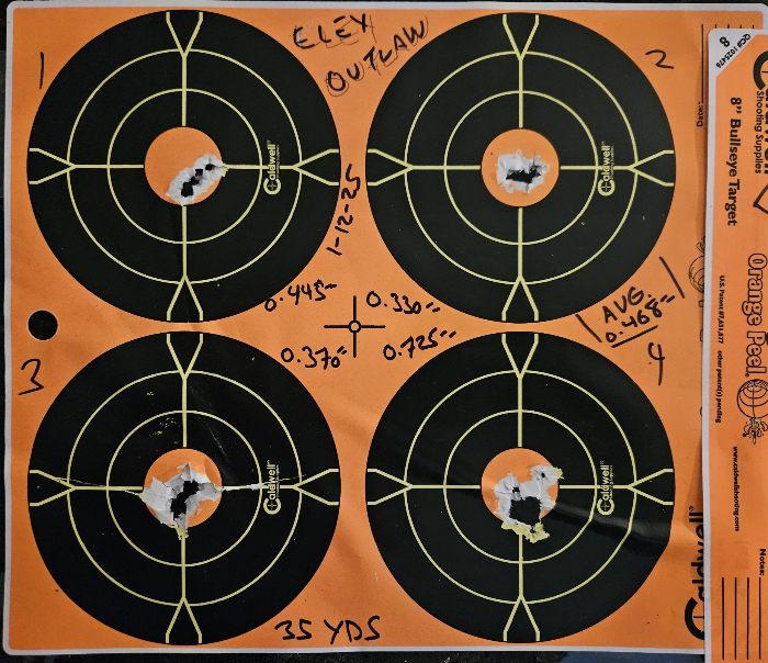

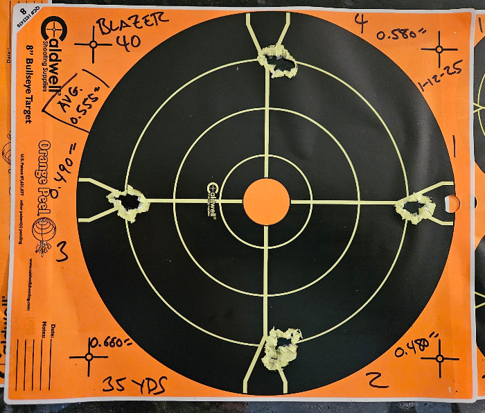

I guess this is a general question, but it involves a rimfire, so here I am.
I got myself a new T1x, and I am testing types of ammunition at short range. I am zeroing at 35 yards, and I will be moving out to 50 yards once I have favorites. The final goal is to kill squirrels.
I shot several types of ammo the other day at 35, and while an Eley product came in with the smallest groups (0.468"), cheap CCI Blazers shot prettier groups (0.555"). Each group was one nice round hole. The Eley groups were irregular.
Should a shooter conclude anything from the fact that one brand of ammunition shoots nice, round, symmetrical groups?
I was pretty surprised by the Blazers. I also shot CCI Sub-Sonics, and I got a nasty flyer I'm pretty sure I didn't cause.

I asked the question because some things about ballistics are counterintuitive, and I thought someone with tons of knowledge might have some input. Not trying to waste people's time. A lot of weird things happen on the range. For example, I have seen people have groups move to the left or right when changing ammo. That is bizarre. Up or down, I would understand.
The Eley shots took up less space, but the groups are kind of stringy.
I should have used the same kind of target twice, but I got out there and realized I had brought an 8" target, so I used it, shooting at 4 different places. I do this a lot anyway, to save money on targets.
