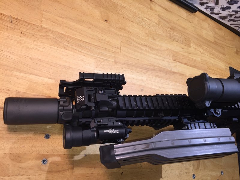

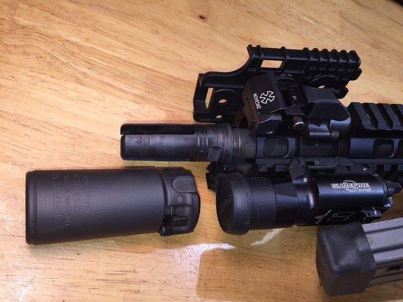

^^ As an aside related to timing for "environmental reasons", this Surefire QD "Warden" forward directing blast diffuser is useful for not worrying about the orientation of the muzzle brake lateral output; limiting dust blow-up if shooting prone especially if shooting low around a barrier and your otherwise horizontal muzzle brake flutes go vertical that really stir up the loose debris. Shown on a Noveske 5.56 N4 10.5".
