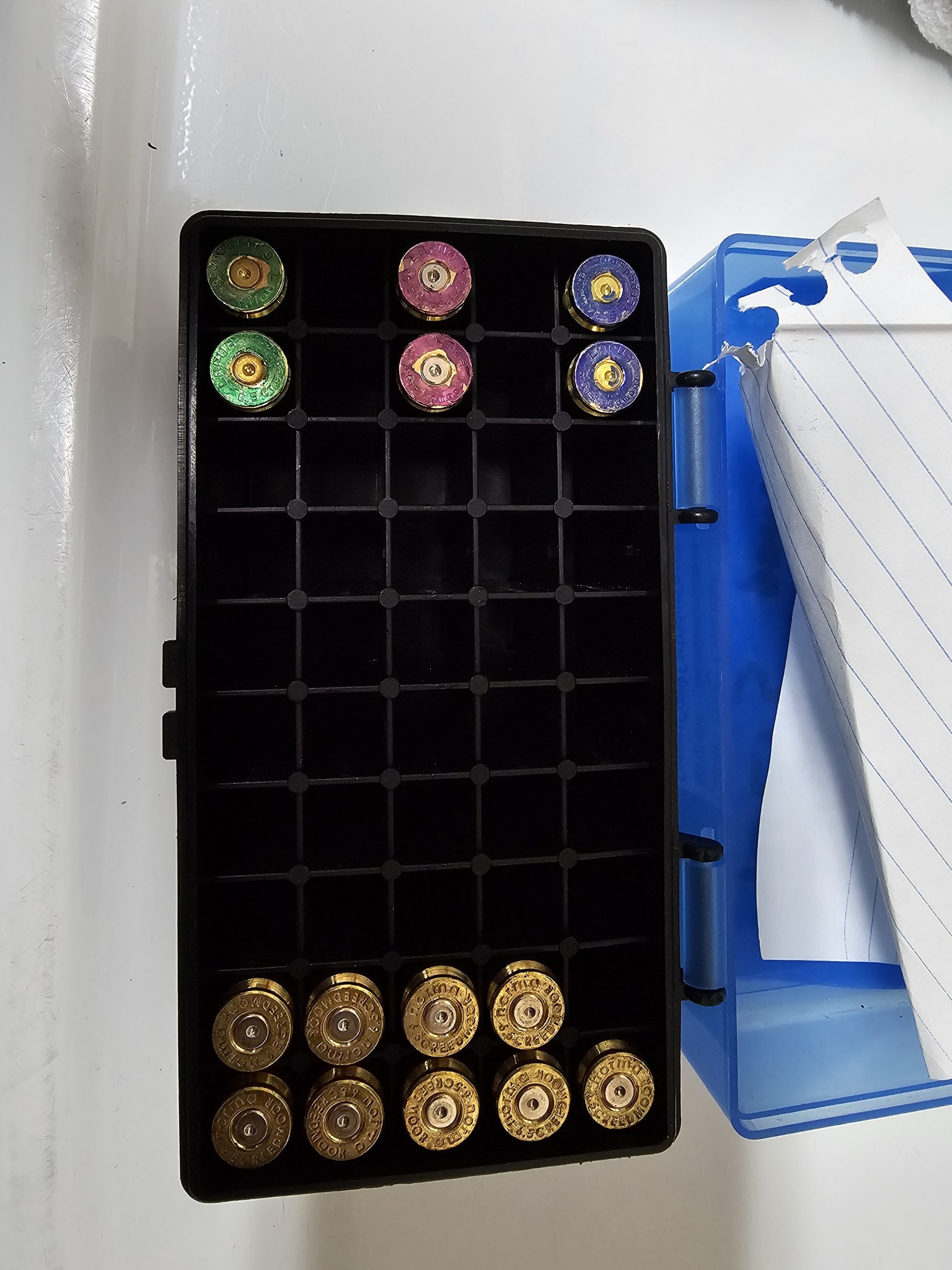

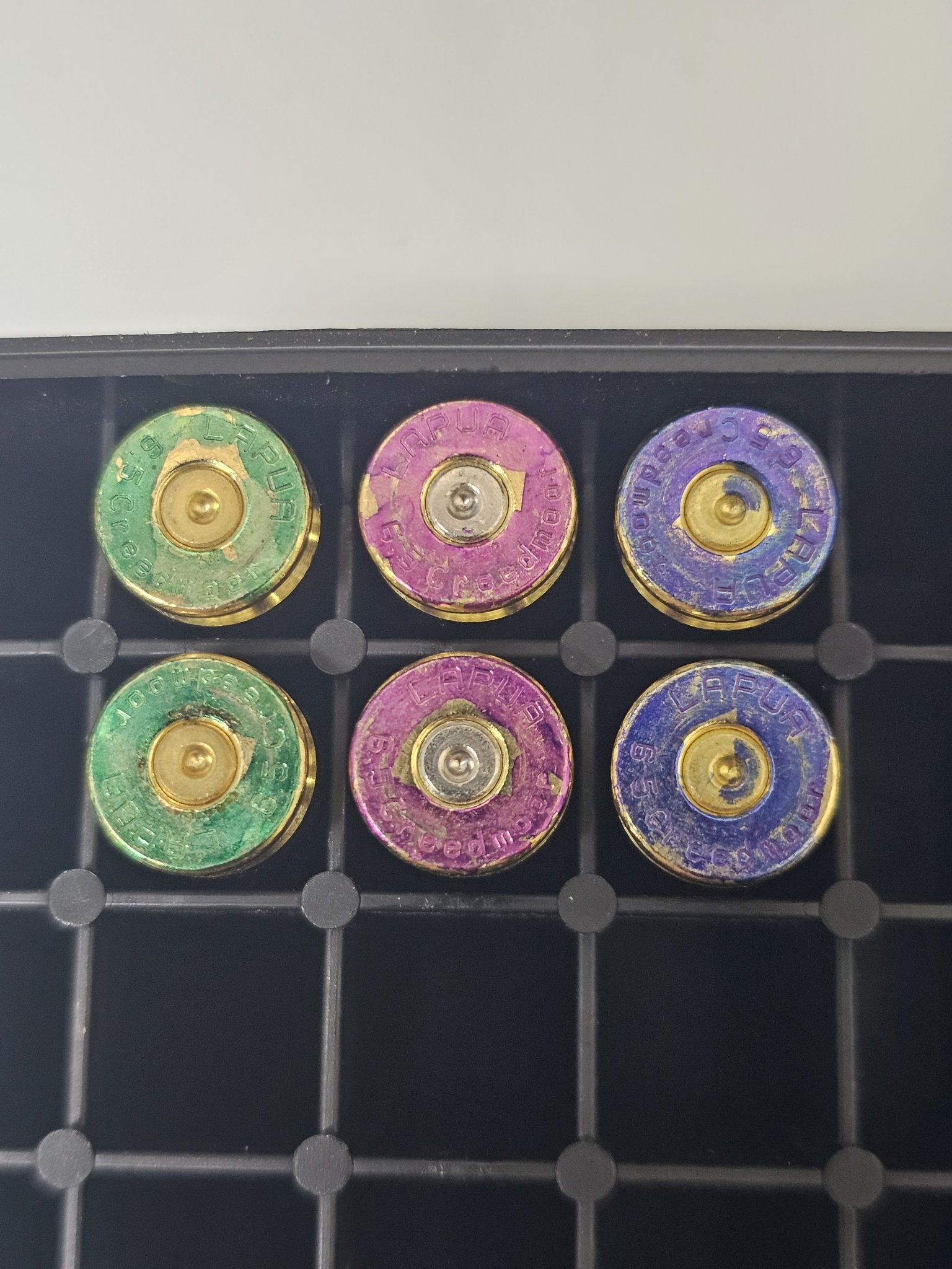

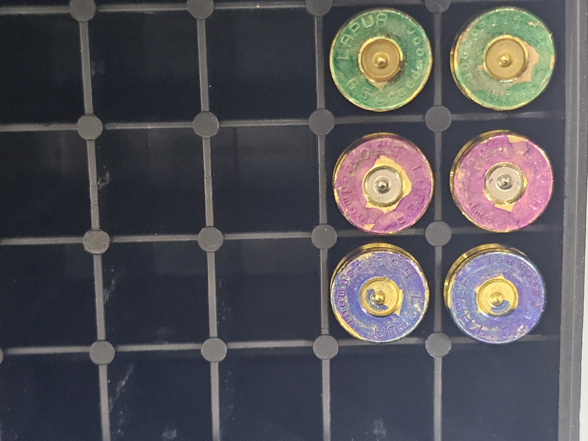

Do these Primers look flattened
Glowie
Jan 23, 2014
317
381
First time using small rifle primers for 6.5 creedmoor
Brass was new unfired lapua srp
Load was 40.5 gr h4350
140gr hornady bthp
Green = regular winchester srp
Purple =federal small rifle ar match primers
Blue= winchester #41 primers.
All shot about the same
Thanks for the help
Reason I asked: A friend of mine uses 40.5 under a 147eld. It does 2650 out of a 26” DTA and is super accurate.
