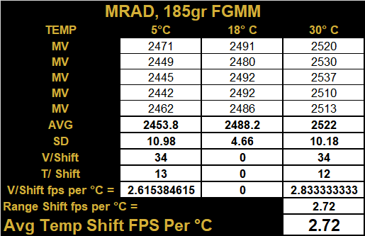

I do quick little tests, usually 15 to 20 rounds, to check powder sensitivity to temperature.
After I went back to factory ammunition, i figured it's important to start doing this again as the proprietary powders ammo manufacturers use is generally not that temp insensitive compared to Hogden extreme powders.
I just chuck the info into the kestrel app for the kestrel5700 and let it sort itself out.
I recently did this for FGMM with 185gr Bergers out of my MRAD and just casually shared my results to some mates.
The response i got was "why bother when you're not really getting the temperature of the powder, just the temp of the case." Fair point but i figured convection would do its thing and i always thought SOME estimate of powder sensitivity is better than none. Attached is the data.
I just did it without really thinking about it, is this worth doing?
Cheers

Edit: to clarify, 2.72fps per °C is = to 1.51fps per °F

Yeah 100% agree and I accept that there's going to be alterations in ambient vs ammo temp, your example is a really good one - my line of thinking was some is better than none.
The temp test was just a quick and dirty for the Kestrel to start (new gun, new ammo), but absolutely agree that it doesn't stop there, i keep records.
I'm going to notch your vote as "do it, but don't stop there", which aligns with my beliefs.
Thanks mate
