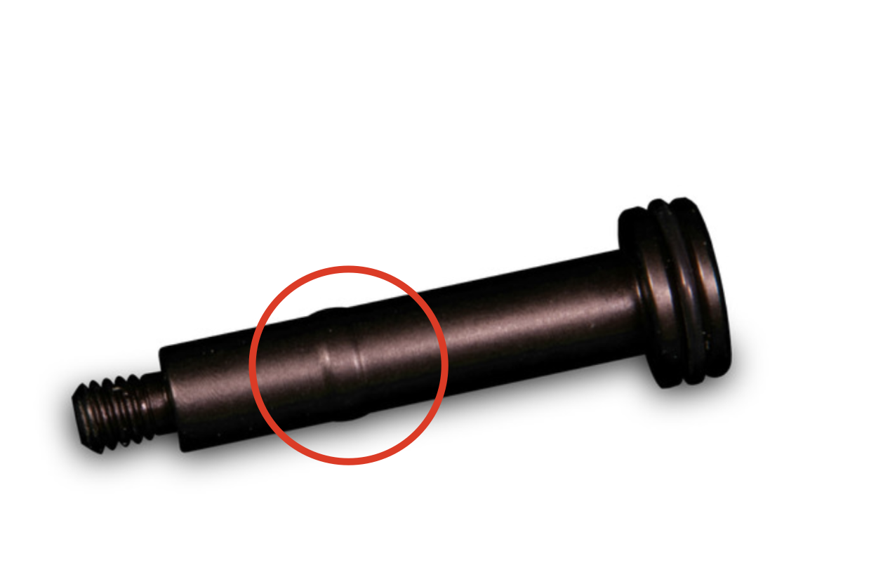

I have a question for those who use the expanding mandrels from Wilson, Sinclair, K&M and 21st Century.
It looks like the standard size mandrels are 1 thou or 0.0008 +/- 0.0002" under bullet diameter.
Are those the mandrels you are using before seating bullets?
If so, are you getting 1 thou difference before and after seating? Some people call this "neck tension" or "bullet hold." Is 1 thou enough?
Sinclair describes the purpose of these mandrels as being for the purpose of opening the necks so they can be placed over a neck-turning mandrel.
LE Wilson describes these mandrels as being for the purpose of opening up new brass that is either under-sized or possibly damaged in packing or shipping to "slightly less" than bullet diameter.
Some authors of articles in the Accurate Shooting bulletin have described using the mandrels and experiencing spring-back to 2-thou under with Lapua brass, but not necessarily any or all brass.
I've received the impression that it has become popular to size necks with these mandrels in lieu of the carbide expander balls in full-length bushing dies (Redding Type-S, Wilson, Whidden, etc.) The practice is to push the cartridge into the die to bump the shoulder and squeeze the neck down to a bushing size just below what the expanding mandrel will open. Then the case is pushed into mandrel die where the mandrel opens the neck, sizing the ID vs. the bushing that sized the OD.
I've read descriptions of why the pushed mandrels are supposed to be better than the pulled balls/buttons.
What I want to know from the people who use these mandels for the purpose I just described, is: Are you using the standard size mandrels sized 1 under bullet diameter? Or are you using a smaller mandrel like the ones from 21st Century that are in half-thou increments? If you're sizing 1 thou under bullet diameter, does your brass spring back to 2-thou under? Are your bullets secure?

Alot there... Most of us are probably using a mandrel that delivers .002 under bullet od for the id of the brass. How we arrive there using a mandrel is a combo of what sizing die and annealing. Could be regular fl die or a bushing die. Personally I don't use bushing dies anymore. I just fl size with a normal Forester die and open back up with a mandrel that will deliver .002 id on the brass.
I have played with as little as .001 and as much as .005. .002-.003 seems to be the sweet spot
It's not about what brand of brass you're using, it's about how hard the necks are. Harder neck = more spring back. Neck hardness changes with every firing, so the answer to all this is going to depend a lot on how you anneal and how often. Size of the mandrel is only one part of a larger equation.
If you want to use a mandrel, you may need to experiment to see what size gives the results you want for your process. Also, if you're the type who doesn't anneal at all or doesn't understand how it changes things like bushing & mandrel dimensions and brass springback, then you'll either learn a bunch pretty quick or spend a lot of time wondering why you don't get consistent results.
If you want to do it "right", then look into mandrels like 21st century or others who make more than just .001 and .002 under bullet size.
You can experiment with what interference fit performs best with your ammo/rifle. And use the appropriate mandrel to se that interference fit. As mentioned above, things are rarely the same over the life of brass. You might end up having to use a mandrel .0005 up or down get the desired inside diameter. Spring back and such is going to be condition of brass dependent, which can change. Especially if not annealing every firing.
Then there's other things to consider such as friction. The more/better lube you use, the smaller you may need your inside diameter to hold the bullet in a way that performs well.
And as very well pointed out in the above post, the bushing or non bushing neck size matters. The smaller you size the outside diameter down, the larger mandrel you will need to overcome the spring back and such.
There's quite a few variables at play.

This is why I:
1) Use a bushing size that corresponds with the mandrel size - I'm looking for the mandrel to be minimally engaged on every expansion after sizing. Less engagement = less spring back = less variation
2) Anneal before every sizing. As @Yondering mentions, every time you fire a case, its hardness will change. Different hardness = different spring back AND different force holding the bullet in when you seat. Annealing helps even all that out.

I’ve used both the Sinclair expanding (-.001) and turning (-.002) mandrels. I’ve found better accuracy and SD’s with the turning mandrels while using moly neck lube. I anneal all cases before resizing. I only shoot 223 and 6.5CM semiauto rifles. Less neck tension could work better in bolt rifles… but I wouldn’t know.

I find a 0.263 mandrel from 21st Century gives me the best results.
I anneal the same.
Do you see more issues with 6GT than the others?
Wondering if more a brass thing.
And do you anneal necks of hornady and lapua the same? Could effect it.
Im no worshipper of EC and he has a good vid showing annealing times and effects on seating pressure, all other items same.
I think it all ties together with OPs rambling opener.
Every brand, even lots of brass will be different, so thats why I love the 0.0005” increment sets from 21st Century.

I do exactly the same, FL followed by mandrel to usually 0.002 under.
Hi - for 223 I use a full length die with expander ball and crimp because gas gun - works great and sub moa with single lot virgin brass. For 308 and 6.5cm I full length and use a mandrel (sinclair w sinclair or 21st centery expanders) .002 gives me decent neck tension and nice groups but I will crimp it if it is going in an AR10 or M1a...
How do you get a 002 under mandrel from Sinclair? They say theirs are 1 under. You use their neck turning mandrel? Or from 21st? You bought the kit or the ones sold in half-thou increments?
The Sinclair Expander Mandrels are .001 under bullet diameter. The Sinclair Turning Mandrels are .002 under bullet diameter.
Since the original reason for the mandrels is to uniformly expand the neck and then turn the neck. Hence the .001 and .002 sizing. For example, a 6mm case you would expand/uniform to .242 and then turn on a .241.....giving the turning mandrel .0005 - .001 (spring back dependent) clearance for the neck turning operation.

I anneal after every firing, full length size with a bushing leaving the neck ID about .300 or .301. I use a .304 mandrel and end up with a neck ID of .3025, a .303 pin gauge won't fit. I do the same with both 308 and 300 PRC. I'm thinking about trying a .305 mandrel.

In theory, sure. But if you pick the neck bushing intelligently, the mandrel won't be working it that hard, in actual practice.

I have a 21st Century Black Nitride that I have been happy with. I use their expander die body too.

Is this considered a mandrel: that little rim?
I suppose that whole thing could be but only that little bit actually works the brass. Looks more like an expander ball though in that it drags on its way out.
Most mandrels look like this
Flat on top that reference against the dies flat top to keep it plumb as it’s forcing it’s way down into the case mouth opening it up to the cylinder diameter.
