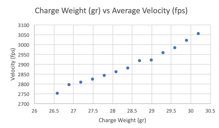

Help me out here. Why do I care how wide the accuracy node is? I know this is heresy, but hear me out. Im reloading on a single stage press. The RCBS Chargemaster is SLOW throwing a powder charge. Slow enough that I can confirm the weight on a gem pro, adjust the weight to within the accuracy of that scale, and seat a bullet before the next change is thrown. So, weighing to within 0.02 grains is no more time, and essentially no more effort, than weighing to 0.1 grains. I'm also using temp stable powders from hodgdon's extreme powder line (target, H4350, etc). Finally, where is the node in the chart below? Note, the highest charge weight had a pierced primer, so I'm pretty sure I hit the top end... :oops:
Well, since you asked, I’d be looking a lot closer between at 28.5 and 29.3, but using 0.2 gr steps instead of 0.5. gr steps, especially for such a small charge weight.
Sure, your scales are plenty accurate, but how well can you control weather conditions, elevation changes, powder lot changes and variations in brass? Maybe you can and have the time and control of these factors, but for people who shoot a lot in varying conditions, locations and use components that may change throughout the life of a barrel, the size of the node matters.

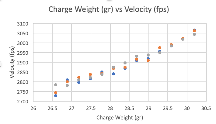

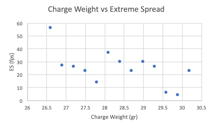

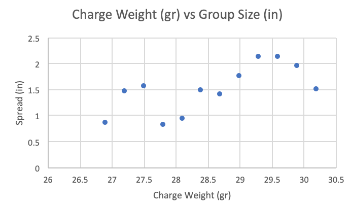

I think we're on the same page, except that those are 0.3 gr increments. If you don't have the ability or desire to control for as many variables as you can (like if you are using a progressive press and can/will not weight every charge), you want a wide node. But, if you are weighing/trickling every charge, live and shoot primarily on the coastal plain with relatively low elevation variability, and also experience low seasonal temperature shifts because you live on the gulf coast, a wide node isn't necessarily as important.
And, I didn't show all of the data. Note that those are "average" values. There were 3 cartridges loaded at each increment. Note that this graph could look much more "nodey" if only a single charge was loaded at each increment. 3 shot group sizes may not matter much, but they don't get any better with more shots, and 2"+ at 100 yards is pretty meh by any standard- even if the ES is single digits for the cartridges measured. I'm working at 27.8gr right now.
And, to the OP's question, in this rifle (22" barrel, 224 Predator, AR15 rifle)- just looking at average values- 0.1gr will give a difference of ~8 fps over the range tested. Added to that, if you are on the ragged edge of a "node," 0.1 can push you into unfriendly territory.
