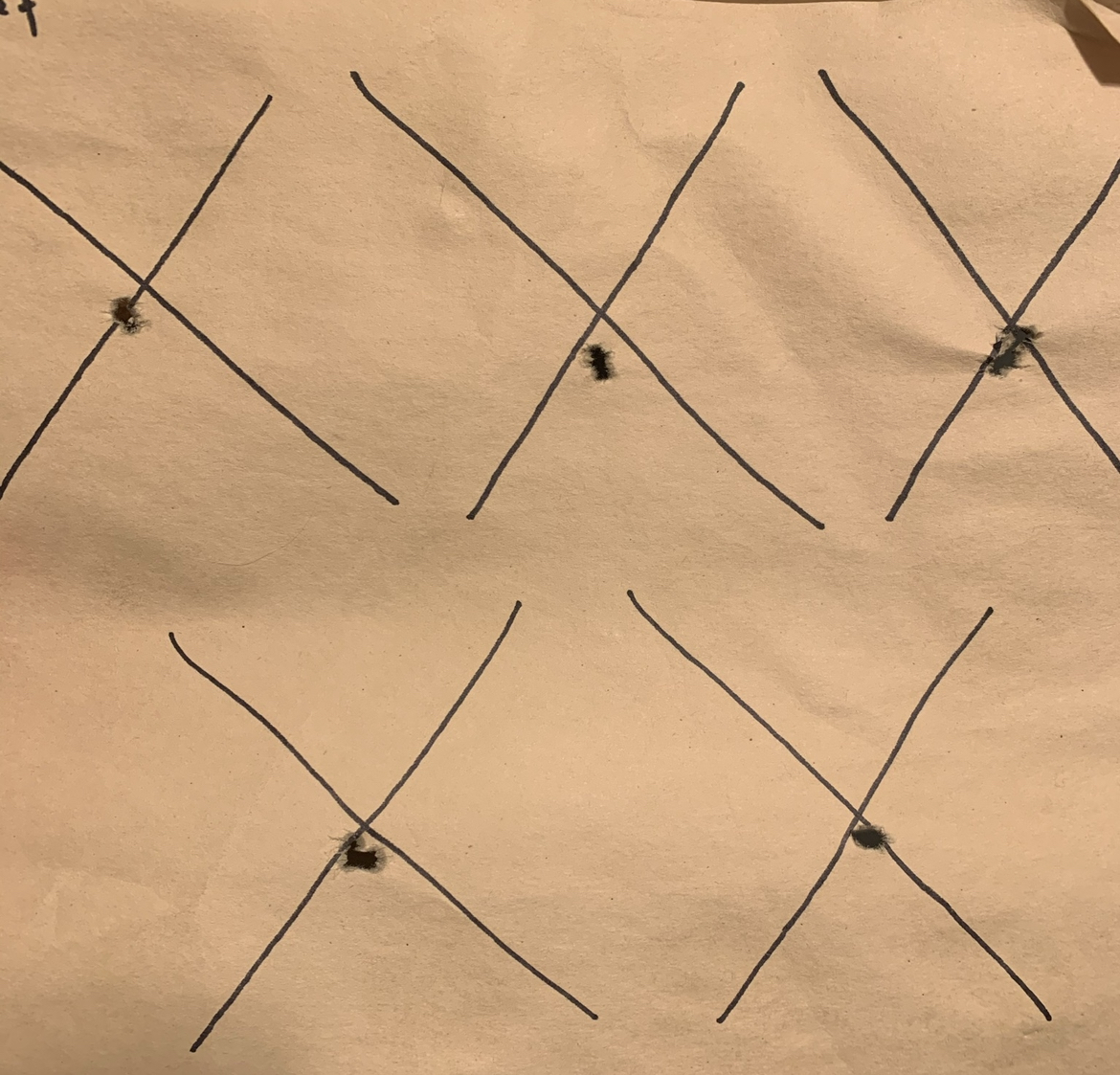

Here’s a load development target with 5x 4 & 5 shot groups with 6x47. Took the same load I settled on for that barrel and did a 3x3 with another barrel. Average group size was like .18 for the 5x target with at least one group in the zeroes. I’ve had multiple barrels shooting sub 1/2 moa consistently with 105s and 109s.
Also, I have my own reamer spec’d around Peterson brass and 109 hybrids, but it works equally well with Lapua brass (when you can find it) or 105 hybrids, and while not totally optimal it shoots dtacs great too. If anyone wants it PM me.
It’s not a finicky cartridge at all and the reamer specs are well sorted. Just make sure you have enough clearance at the .200 datum line and at the neck, and the freebore to suit whatever bullet you want. The issue with the original reamer that Surgeon was using had too short of a freebore and too tight body/neck dimensions. I suspect that was the issue with a lot of the barrels PRS people had a long time ago.
