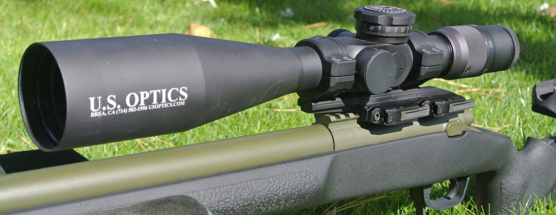

    I have multiple Bobro QD mounts that i have had good luck with . I can't afford all the optics I need so I move them around regularly. I'm not an expert but I did a lot of research on this topic and seems like Bobro does it right.
    Here's a review from a supposedly reputable source... ;)
    Here's a good thread on the topic from this forum...
    Another from the m4carbine forums...
    My experience in moving 2 optics around on 4 guns is Bobro mounts always return exactly where they were on the same gun. My buddy has moved his optic between guns as well. Boro design is solid in my experience.
    Pretty sure GDi has the least zero loss of any QD mount.
    But a unimount and a t handle torque wrench is probably the way to go unless you need to be able to QD the scope in field to access irons or something
