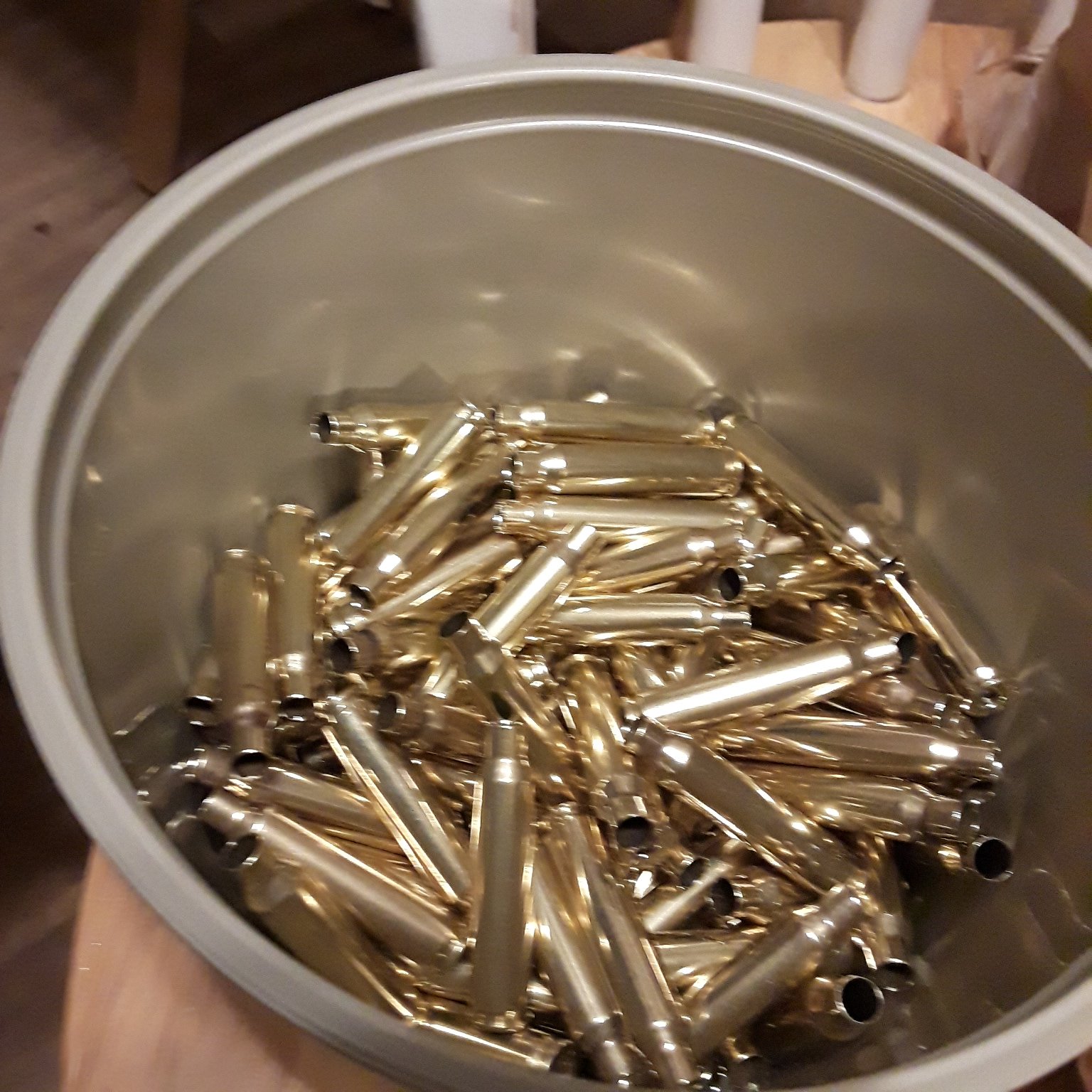

I mix my wax with mineral spirits and put in a condiment squirt bottle.
2 parts wax to 1 part spirits .
I turn the tumbler on and add 2 full squirts, let the tumbler distribute the wax till all clumps are gone before adding brass.
? Brass too slick or shiny making problems? Not ran into that.
Since your media is dry some extra wax on first run may help.
I use lyman media, the red one. It leaves a reddish residue inside the neck, and a dollop of carnuba car wax leaves a smooth waxy finish on the out side. And it smells good!
