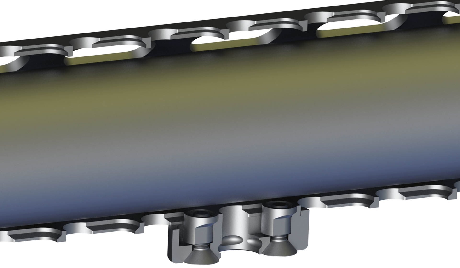

Keymod and Keyslot are more that just a "lollipop" shaped slot. Keymod uses an undercut of the straight portion of the keyhole:
For Keyslot, the back side of that same area has a conical feature (similar to a countersink), which recieves the conical head of the mating screw. This provides better retention.
It may not be terribly difficult to form these features, but such an undercut would require more machine time than a simple slot.
