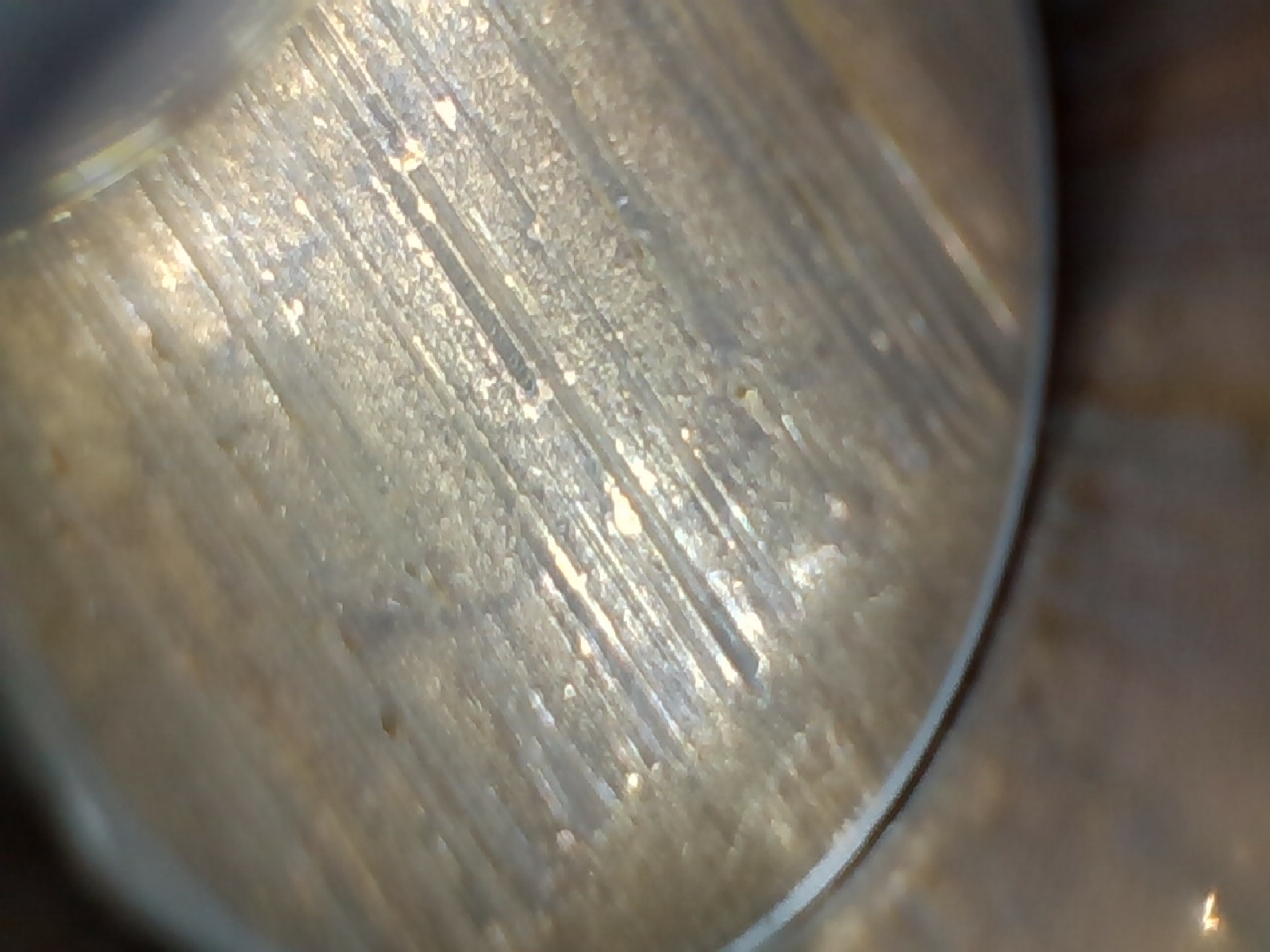

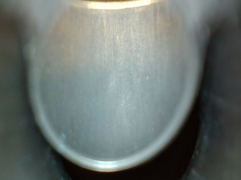

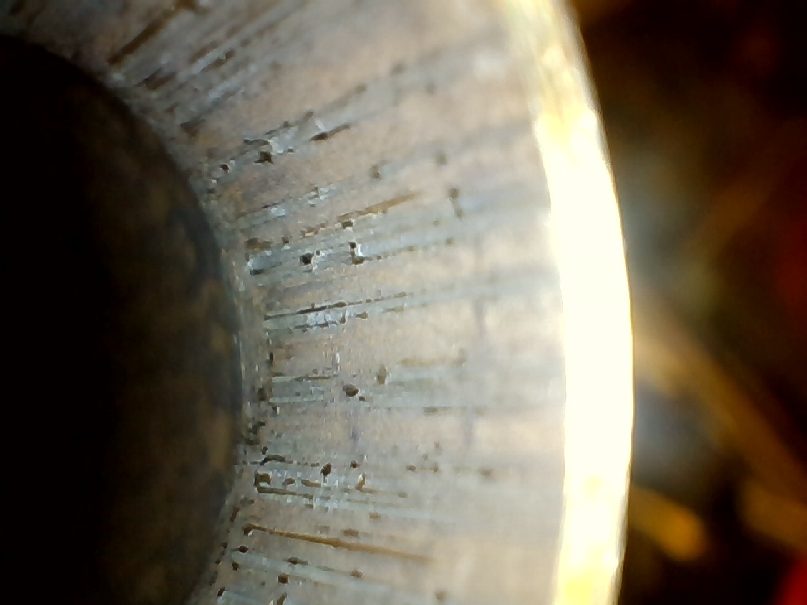

Just so you guys can see what im seeing. The more i look at it, the more of a problem it appears.
Some of the lines extend into the shoulder so im thinking its factory marks unless theres another explanation. Will unburned powder do this?
And one of my 6.5 CM x5 fired smooth as silk
From the second pic it does look like it's coming from a donut at the neck shoulder junction.
Are you seeing the same from the entire batch of brass ?
The first neck turning set up I bought years ago was the RCBS with auto feed that replaced the cutter head in the manual trimmer they sell, the turning arbor is designed to ream the ID as it's turning the OD.
If you know someone that has one it might be worth a test to see how it does, I'm positive there are better tools made for the task however.

Im sending a email to hornady tomorrow. Using the borescope I can see some of the lines continue down past the shoulder.
I've already tried some abrasives and these marks are deeper than it will cut through easily. It needs to have about .001 taken off to really clean it up.
So with the graphite lube approach, it's not really solving the problem, it's more or less just lessening its effect on the copper bullet?
If those lines go down past the neck-shoulder junction on the inside of the shoulder and below, it would explain the high points of the asperities being mashed along those lines.
This would have happened during one of the deep draw processes before the neck and shoulder were formed, and then those smashed asperities happened when they either did it with the bullet or any tools that went down the neck.
For their deep draw to get those lines, they probably got brass stuck to their tooling and it galled everything that came next. A lube issue or contamination could cause that in the deep draw.
