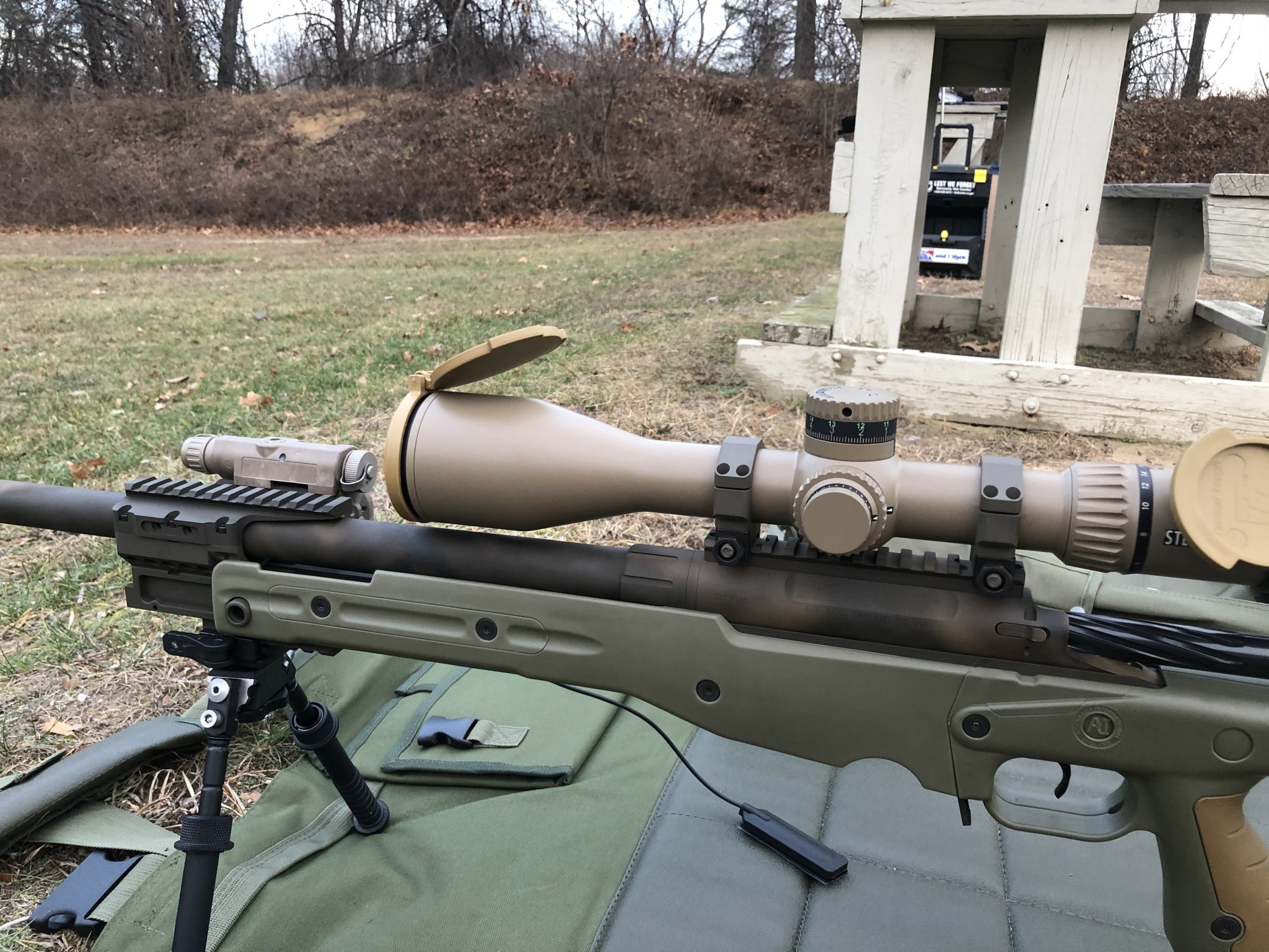

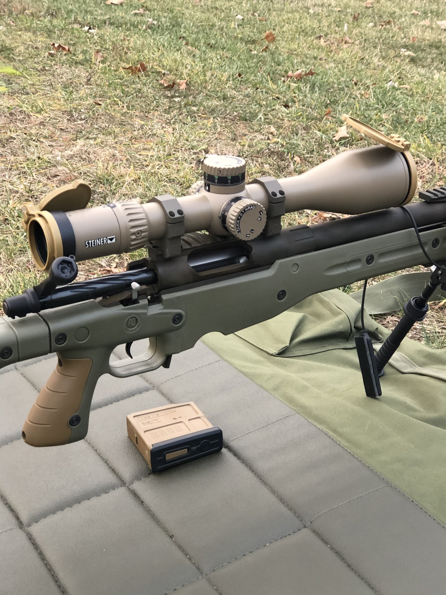

The one on my Nuke seem to have been doing admirably so far. These shots were with a random swag load with 140 ELD-M loaded in virgin Alpha Munitions brass and RL16. The barrel was decently warm for a couple of those groups and I'm far from the greatest shooter out there. Let it cool down for the 300m. Biggest complaint so far is that the barrel seems to get marked up easily. Also had some surface rust show up, which is a first for me in dry ass Alberta. Haven't had that issue with my other firearms. First picture is visual representation of the rifle from a separate range session. For the record, the pictured factory loads of Hornady 140 grain ELD-M also shot very well.
