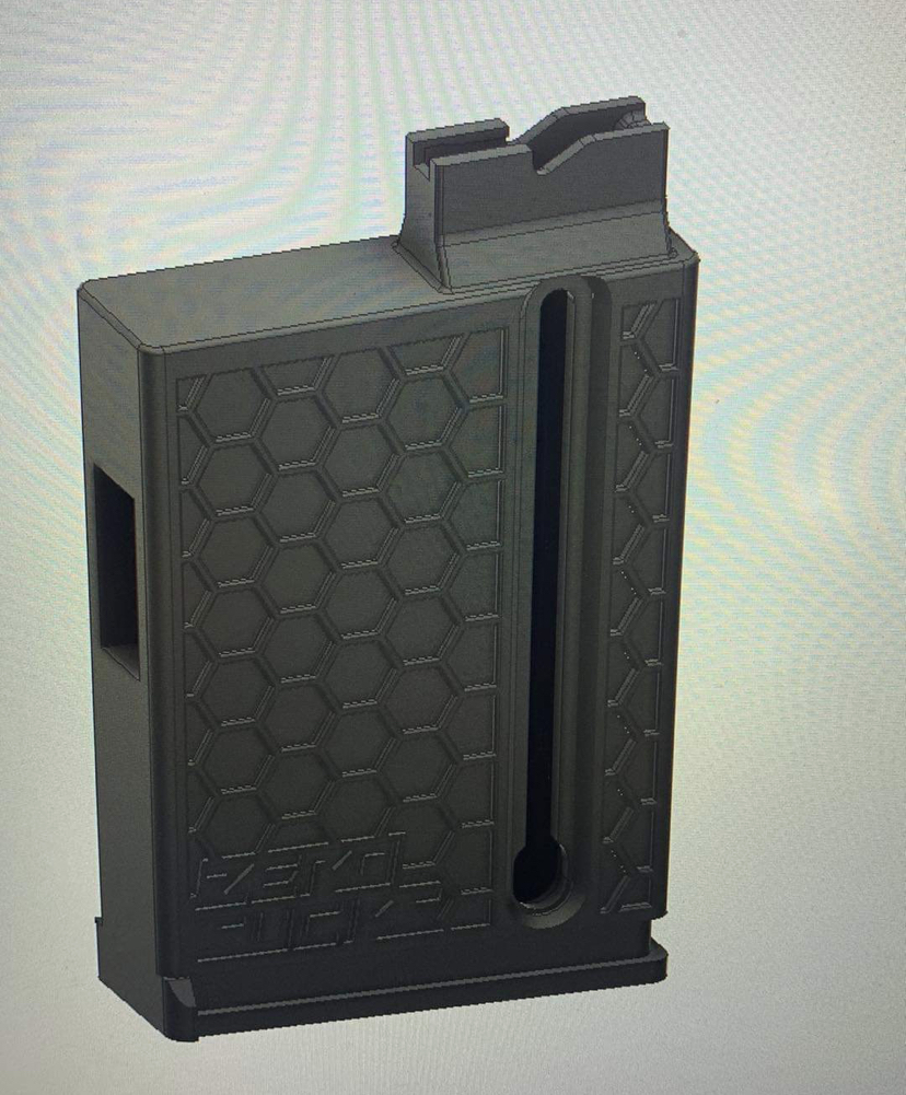

Well AZ Dan,
you told me to get back to you when it was a +5 or +10....here is a plus 10 setup from L3I Design Solutions!

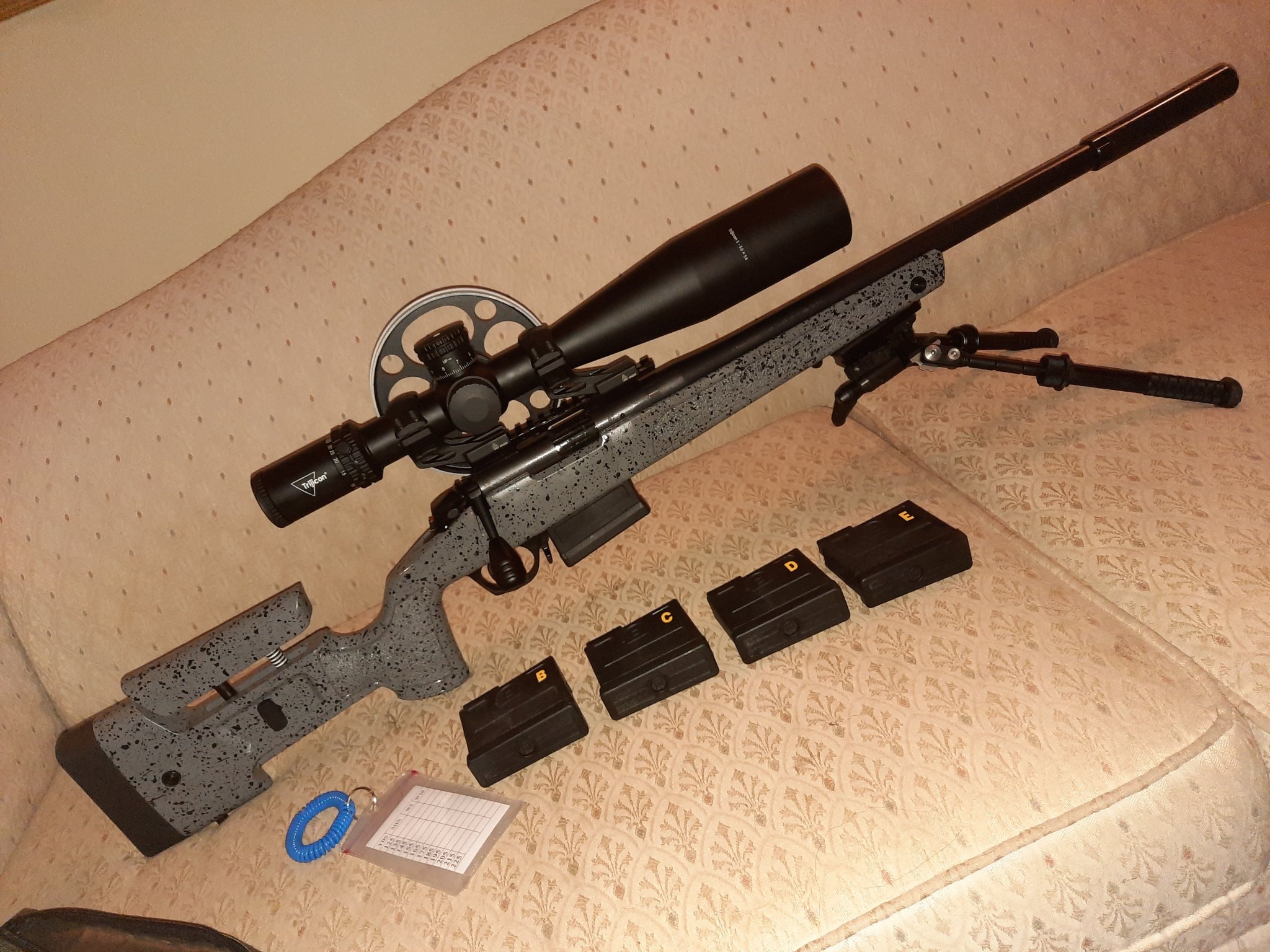

What's the problem with multiple pre-loaded mags? I put ID marks on all of my mags primarily to be able to ID them when
they show signs of requiring maintenance. I have them on the bench and the ID allows me to quickly orient them properly
prior to the switch. They sit on the bench on the left side and I switch them with my left hand.
I would hate to pay more money for a larger mag and some back-ups mags and likely spare parts only to have it go down.

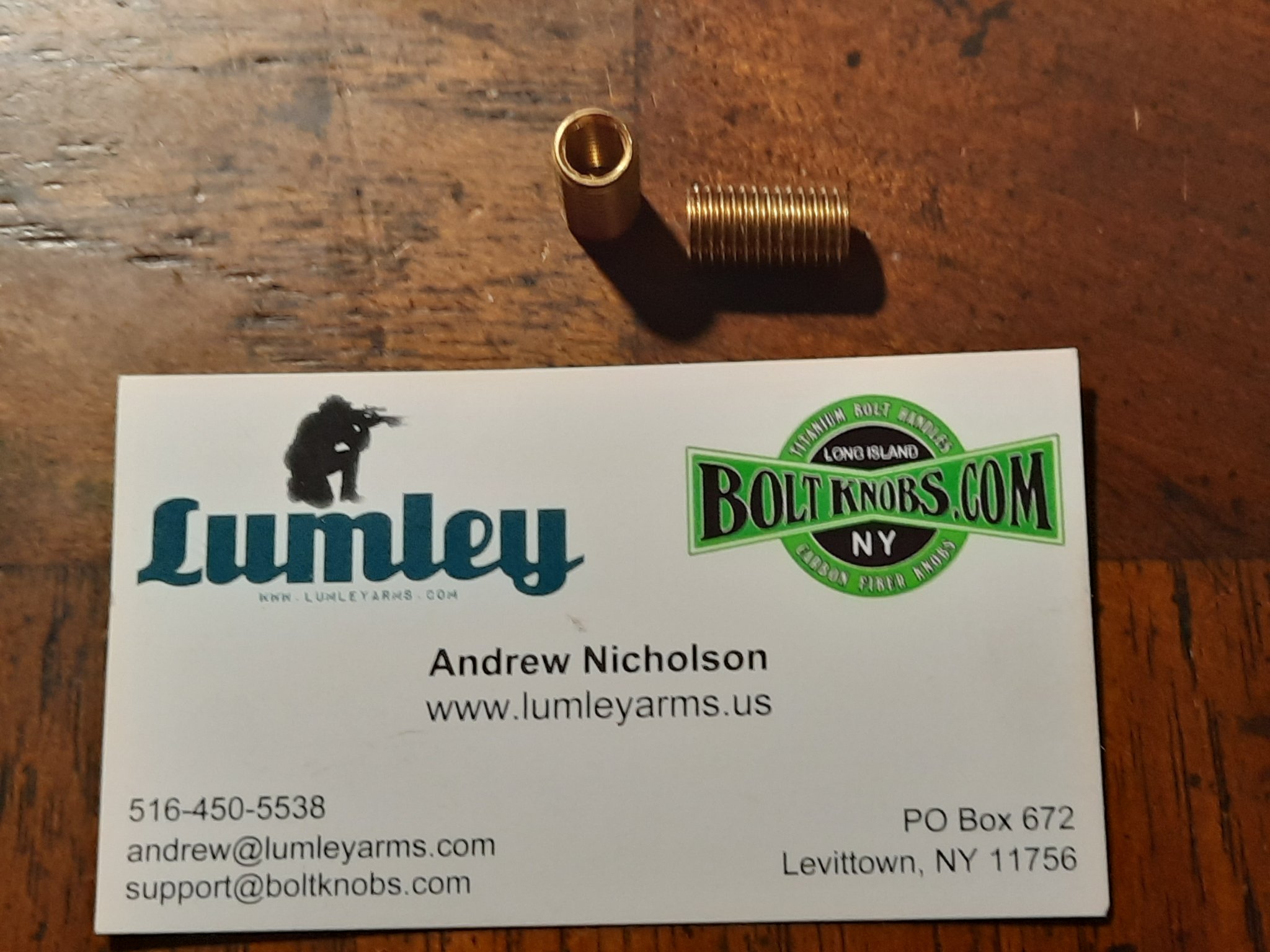

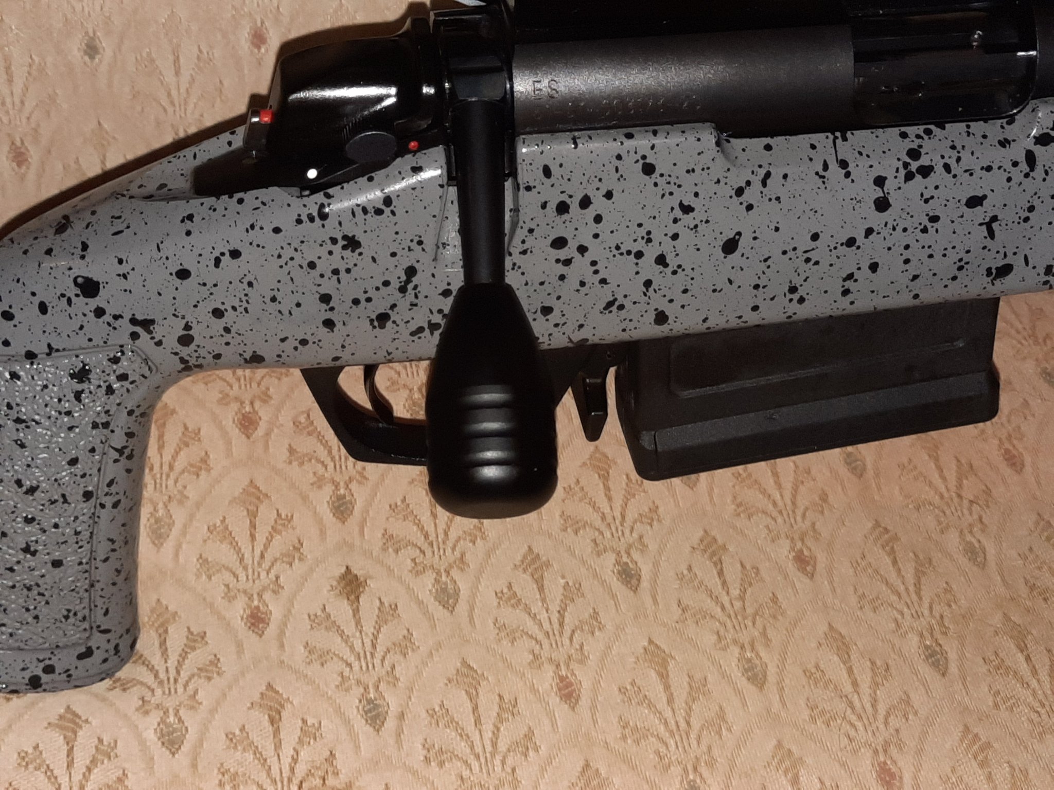

IMO... the B14R is a really nice rifle given it's price point of $950.00. My only personal complaint about it's ergonomics
is the bolt knob, it's too short and it's knurling is too crisp for the way a slap my bolt around. I replaced it with a Vudoo knob
which suits my taste perfectly. I may have had to use a Lumley thread adapter but truly don't recall. It goes from 5/16-24 to M6-1.0
I'm sure I had to use it on my 3 CZ 457s to put the Vudoo knob on them. I had AREA 419 knobs on all of my 457s but changed
them out for the Vudoo knob as well.

that mag looks great how well do they function and how much$
It works great. The are sold as 14 round magazines and then they also sell magazine extensions. the extension added to a factory B14r mag adds 2 rounds, but added to the 14 round magazine with a new follower and spring it brings it up to 20 rounds. the springs for that configuration are still on order though and currently not on the website. L3I Design Solutions is the company.

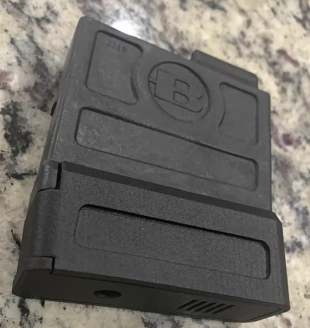

I have three of the L3i +2 baseplates on my B14R. I run mine in NRL22 and similar matches. I did have to stretch the OEM spring and file down the "nub" on the follower per a few of the guides floating around, but after that, they've been a joy. Aside from the 12 round stages at NRL22, I mostly just enjoy the added length - the OEM 10 rounders are tricky to remove from the magwell and my Esstac KYWI pouches, especially when wearing gloves.
Honestly, had I not just learned of this new product, which looks to be even closer in dimension to a 10rd AICS, I would have put more L3i +2's on the rest of my mags.

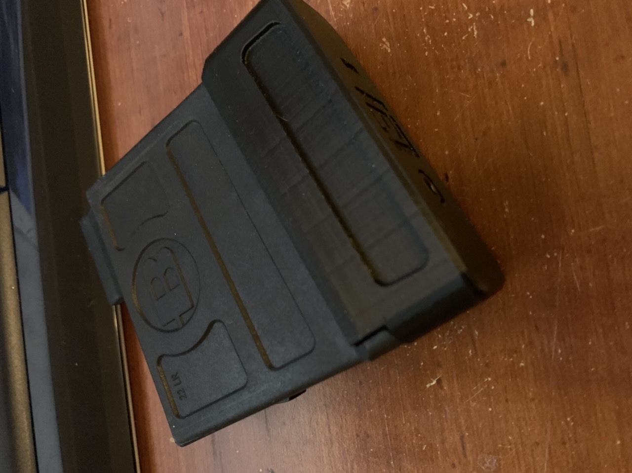

The +2 is great for competition, yes you can buy another 10 round mag, but you may not have enough time left on the clock to switch mags…so you are buying time back essentially. Having an extra round or two even on a 10 round stage comes in handy if you have a misfeed. Our new +2 extensions are now made of a durable nylon and install very easily with a removable base plate.
The +2 is great for competition, yes you can buy another 10 round mag, but you may not have enough time left on the clock to switch mags…so you are buying time back essentially. Having an extra round or two even on a 10 round stage comes in handy if you have a misfeed. Our new +2 extensions are now made of a durable nylon and install very easily with a removable base plate.View attachment 7751951
Where do u purchase the +2 base plate.

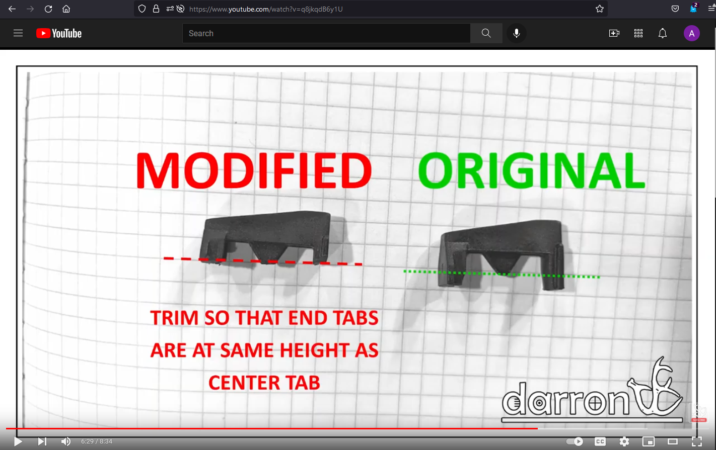

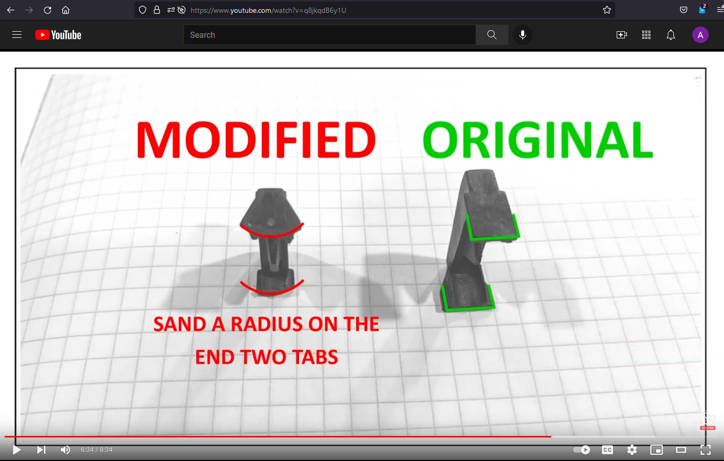

I haven't seen anyone else mention this problem but I started looking for mag extensions b/c when I load to 10 rounds in the factory mags the nose of the last round is pushed up and hits to barrel above the chamber. Rounds 1-9 will feed just fine. I figure its a tension thing so am hoping a looser spring in a 2+ extension would help. I have it in a KRG W3 so that may also be the problem.
If anyone has seen/ fixed a similar problem I'd love to hear how... otherwise I'm gonna give the L3i a try.
The extension is a great product but I'm not sure its going to solve your problem. One of the L3i mags with an adjustable mag height catch might make more sense. Someone else can chime in if the W3 can have an adjustable mag latch put on to correct feeding with your factory mag.
@waterman86 - Regarding not being able to fit 10 rounds into the OEM mag - I had a few mags with that issue as well. When I installed my Gen1 L3i +2's on a handful of them, I needed to perform some modifcations to both the +2 parts and my followers to get proper function. A YouTuber named DarronB has a video up showing the needed removal areas, highlight below. I ended up modifying all my followers, including those in mags that kept the OEM baseplate and stayed at 10 rounds, and noticed a world's difference and improvement getting 10 drama free rounds in and out on the clock.
Recommend this mod 100%, or at least until Bergara does a revision to the OEM mags. If you're looking for extensions, I recommend the newer L3i's, although my Gen 1's work fine, I do not look forward to taking them apart for cleaning.

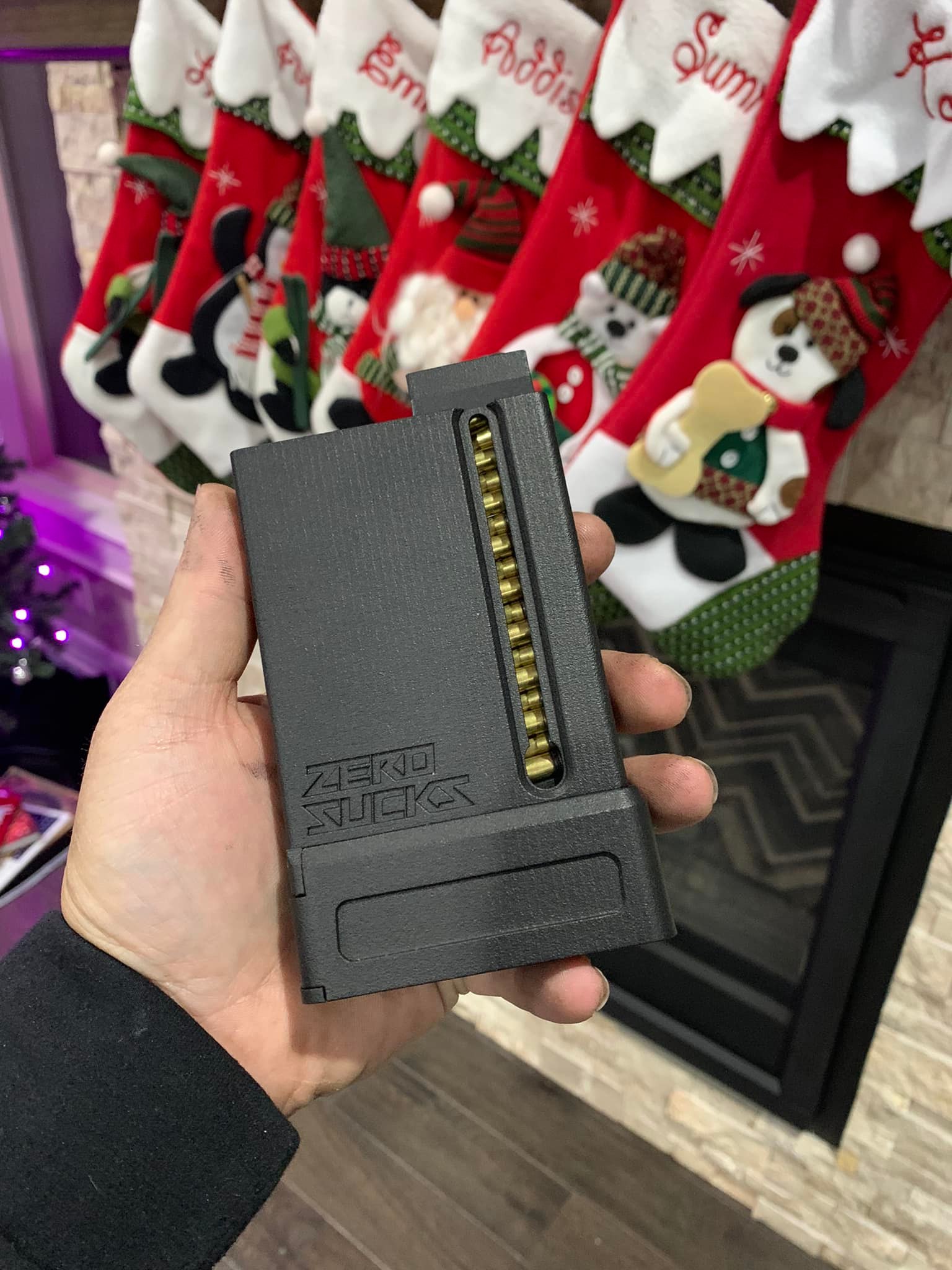

I like this a lot. I am not a fan of the hexagonal design.
I hope they come out with a full magazine kit, no assembly required 20 round magazine, for a nice price.
There are some floating around that don't have the hexcomb but the cost to manufacture it is quite a bit more. If it's a smooth sided body the material requirements are more as well as the fast that you must hold a different surface finish spec.
I we do a 20 round mag it will be a small batch since the pricing would make it more than most would want to pay.
Reactions: SneakyDingo1
It's stronger the way it is vs inversed but that's definitely something we will look at. It would still require a surface finish spec and would raise the cost. I'll look at the cost of a small batch of 20 rounders with smooth walls.
