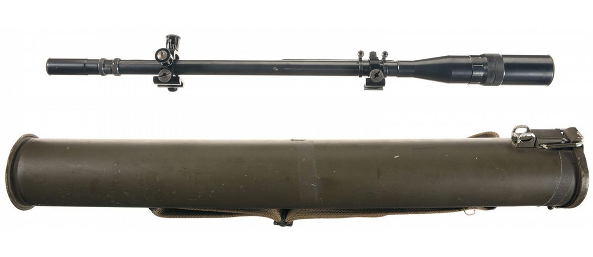

I have 3 different types of Unertl tubes, but I've never seen any flat top ones. Everyone mentions the flat tops, I've even seen a photo of a case that matched the description and claimed to be a Unertl tube, but the case in that photo looked like it was for something else. Hopefully someday there will be definitive proof of flat top cases with Unertl scopes that fit within them.
Of the 3 confirmed types, the aluminum one is the most rare. In fact, it's probably the only one made since it rang like a bell when anything hit it. Not a very desirable characteristic for sniper equipment. The 2 micarta cases have different construction features on the bottom, otherwise they're pretty much the same.

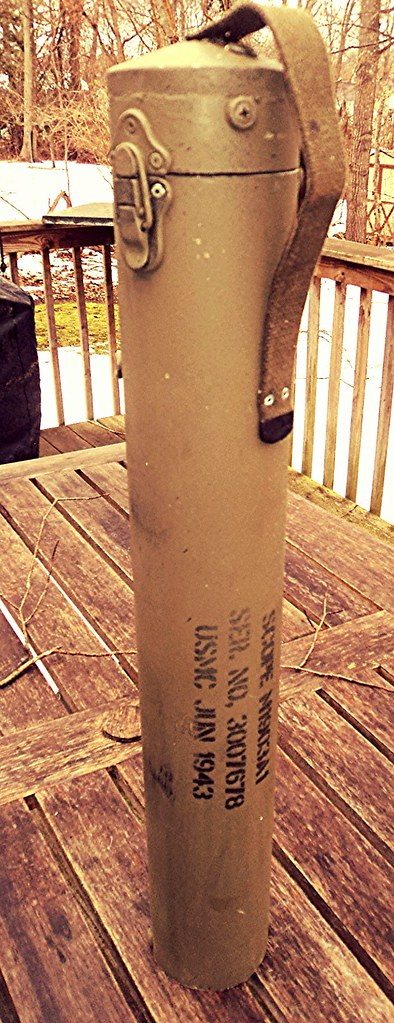

No. Just ignore everything in Random Guy's post. Starting from scratch, here's the information you need:
Tube - a little over 24" long, about 3" wide. Go with @sirhrmechanic's advice and just get tubing in the correct dimensions. Add a piece of the same material to the bottom and find/make a funnel shaped cap for the lid. Get fancy with a spring at the bottom or just add foam or whatever padding to need to get a secure fit for the scope on the inside. Done. No wood or aluminum or other shit, keep it simple.
Here's a more detailed explanation with photos (actual first-hand information, not a book):
The tube on the left is micarta, it has a micarta bottom and there's a spring on the inside bottom of the tube. The middle tube is micarta, it has a micarta bottom and that's it, no spring on the inside. The tube on the right is aluminum, it has an aluminum bottom, no spring either (has some pad at the bottom, probably a thin piece of leather).
None of these original WWII era Unertl tubes have wood on them. This is also the only aluminum case known because it sucks. I doubt they made aluminum ones decades later either, because the aluminum case sucks compared to the micatra ones.
Here's a photo of the inside of the micarta tube with a spring at the bottom. Notice how the piece on top of the spring is funnel shaped, this is to center the scope in the tube. The piece on the bottom also has a thin layer of padding to help protect the scope. The spring served 2 functions, the first is to dampen any shock to the scope if the tube gets knocked around. The second it to push the scope up against the the tube's cap, which is also funnel shaped to center the scope in the tube. All this scope centering sorta prevented the scope's turrets from impacting the case wall (preventing damage, losing zero, preventing noise, whatever reasons).
Here's the inside of the cap, notice the circular marks in the micatra from the scope being wedged into it from spring tension. The cap is shaped like this so that the scope self centers and doesn't rattle around in the tube. To say that the cap has a pointed top in order to "shed rainwater" is retarded, I have no idea why Poyer wrote that.

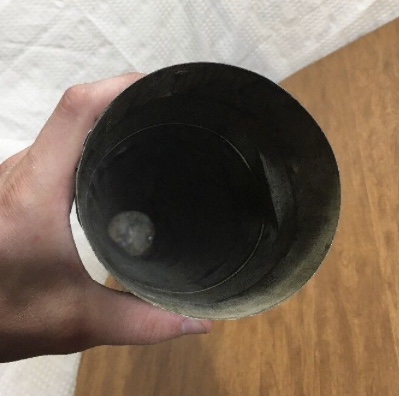

Here's the inside of the micarta tube that doesn't have the spring at the bottom. I have no idea if this is a completely different style of case, if it's earlier than the spring loaded ones or if it used to have a spring but was somehow damaged. Personally, I really don't care. All I know is that this is the case you should copy if you want to make an easy version of the Unertl tube. It's a flat bottom, put some padding down there to get your scope up to the cap and be done with it. If you're awesome at making shit, then try doing the spring loaded case.
Attaching the cap to the tube is pretty basic, 3 rivets on the tube line up with 3 "T" shaped cuts in the cap. To close, line the cutouts with the rivets, push down and rotate either left or right (it doesn't matter, it's "T" shaped). To open, rotate the cap slowly while lightly lifting, you'll soon rotate to the release cut and the cap pops off. There's not snap closure, it's a few rivets and cuts. If you're able to do it this way on your build, go for it. If it doesn't matter to you, then choose an option that's easier to make.
If there's a spring in the bottom of the case, the scope will extend out of the tube. When you put the cap on, it pushes the scope down and the spring tension holds it in place. If it doesn't have a spring, the scope will drop in and rattle around in every direction. If you're not using a spring, I'd recommend some padding on the bottom of the tube and inside the cap to hold the scope steady.

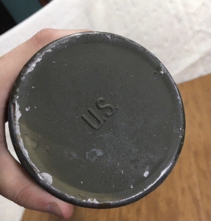

I was bored today, so I decided to take the bottoms off the micarta tubes. Turns out, there's only one type of tube, the weird one just had the bottom piece flipped around!
I've never seen photos of the bottom inside one of these tubes before, so I guess this is a SH Vintage Section exclusive, lol. Here it is:
I have no idea why someone removed the sping and follower from the tube, but it's interesting to see what makes these tubes special. Let me know if you guys need any other pics or dimensions for these micarta cases.

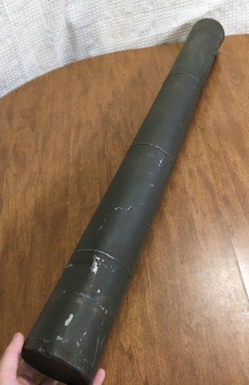

Personally I think the aluminum ones you see in some books with the flat tops, were probably made to hold something else. They are not marked in anyway and they really don't strike me as a scope case. I think they were made for something else, like say a map case or something along those lines. I also don't think there is really any chance any were made in Korea. They had a huge surplus of those Can's leftover from WWII that were never used. So I don't think there would be any reason to have made more for Korea. Esepcailly since the Unertl was replaced in Nov 1950. They had no intention of making the Unerlt the standard sniper for Korea. It was only used because they couldn't get enough M1C's fast enough from the Army. But a small number of Unertl snipers were used in Korea, so there just wasn't that many used. So all the surplus Micarta can's they had there really wouldn't have been a reason to make more. Also there isn't any mention in the Marine docs at all about making new ones. It would have been listed if it would have had happened.
To be honest the Micarta can's seem to have never really ever been used. I've never found any pictures of them in use, or even any testimonials of them being used. The WWII Marine snipers I've talked to said they never used them and even seemed sort of puzzled when I asked about them.
Ryan's one above to me is either a really early piece, or maybe a prototype of some sort. It might even be Unertl made some for the shooting teams to store their scopes. Then the Marines copied them and made them for military use. The standard Micarta can's aren't marked J Unertl, but Ryan's is. Which makes me think it's a really early one before there were war shortages on metal. It's possible it's post WWII civilian too for like shooting teams and such, but I think we would find have found more of them if they were post WWII. That is why I guess I think it's pre WWII or very early WWII. But that is only a guess. So far it's the only one known of.
The Marines did receive Unertl scopes before the sniper program for their shooting teams pre WWII. They also did buy some Unertl scopes for the sniper trials. That is what to me seems to be the most logical on why that scope can exists.
I also know where Ryan found that aluminum can and it's Marine history. It's a really neat piece that I would love to own.
Okay, it sounds like Joe Poyer's book might have an error re the mysterious aluminum flat-top "scope cases" from the Korean War. Looking around, I did find pics of a vintage US military map cannister case "made of tin or aluminum" that I suppose could have been re-purposed and used to transport a Unertl scope?, although this one does not have any leather straps or a snap at the end as Poyer described. Maybe a similar map cannister was reported to him as being used with the scopes in the 1950s? (Joe Poyer has since passed away). Anyhow, I think the above observation about Micarta cases is correct re post-WWII supplies. (A local collector buddy has several Micarta cases in his safe...but none are for sale).
