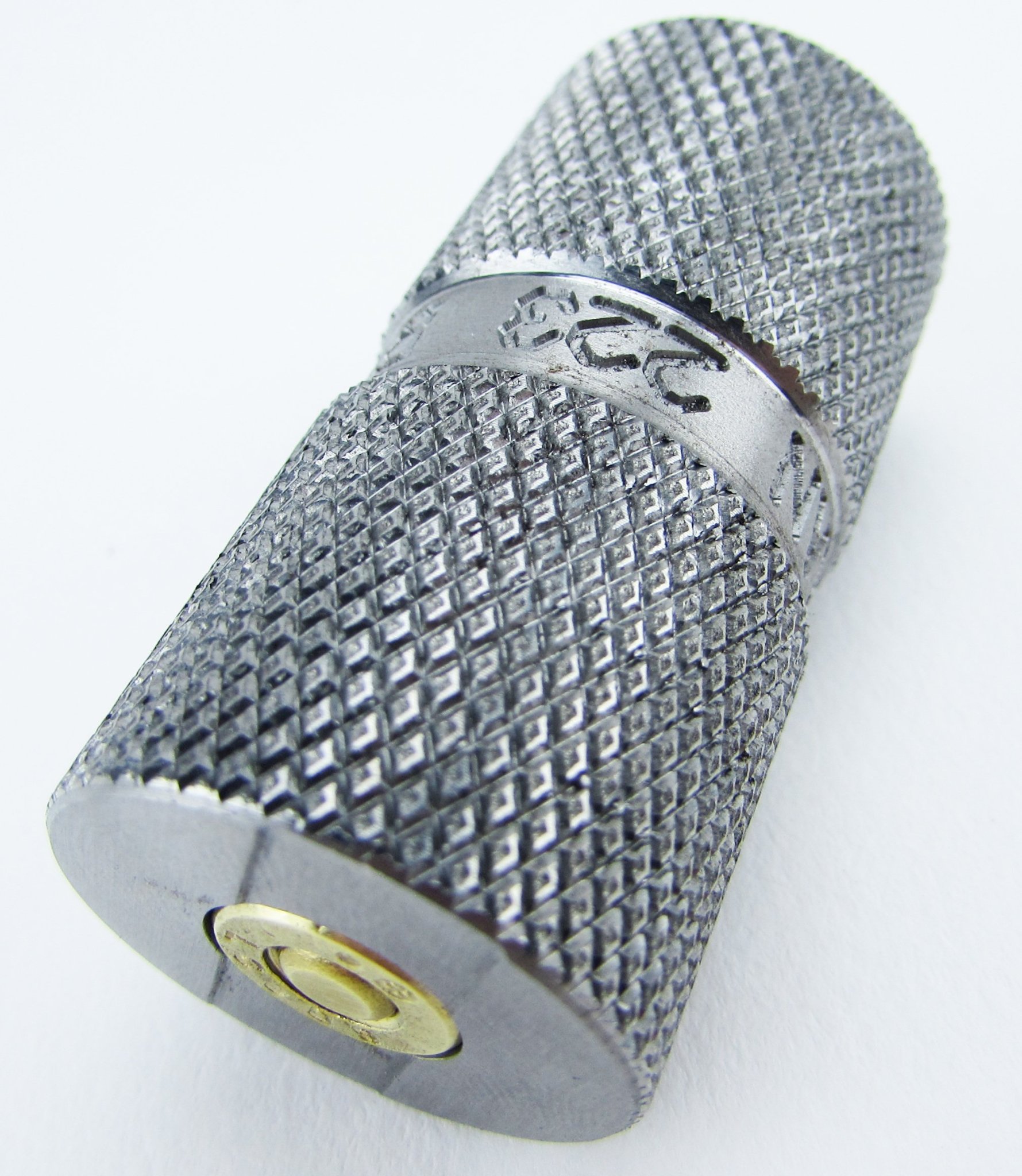

I occasionally use Whidden case gauges, which have measurements for every thou.
Easy way to directly compare brass pre and post shoulder sizing operations.
The datum itself (i.e. 'GO') is not necessarily important, but rather finding out how measurements compare before and after sizing.

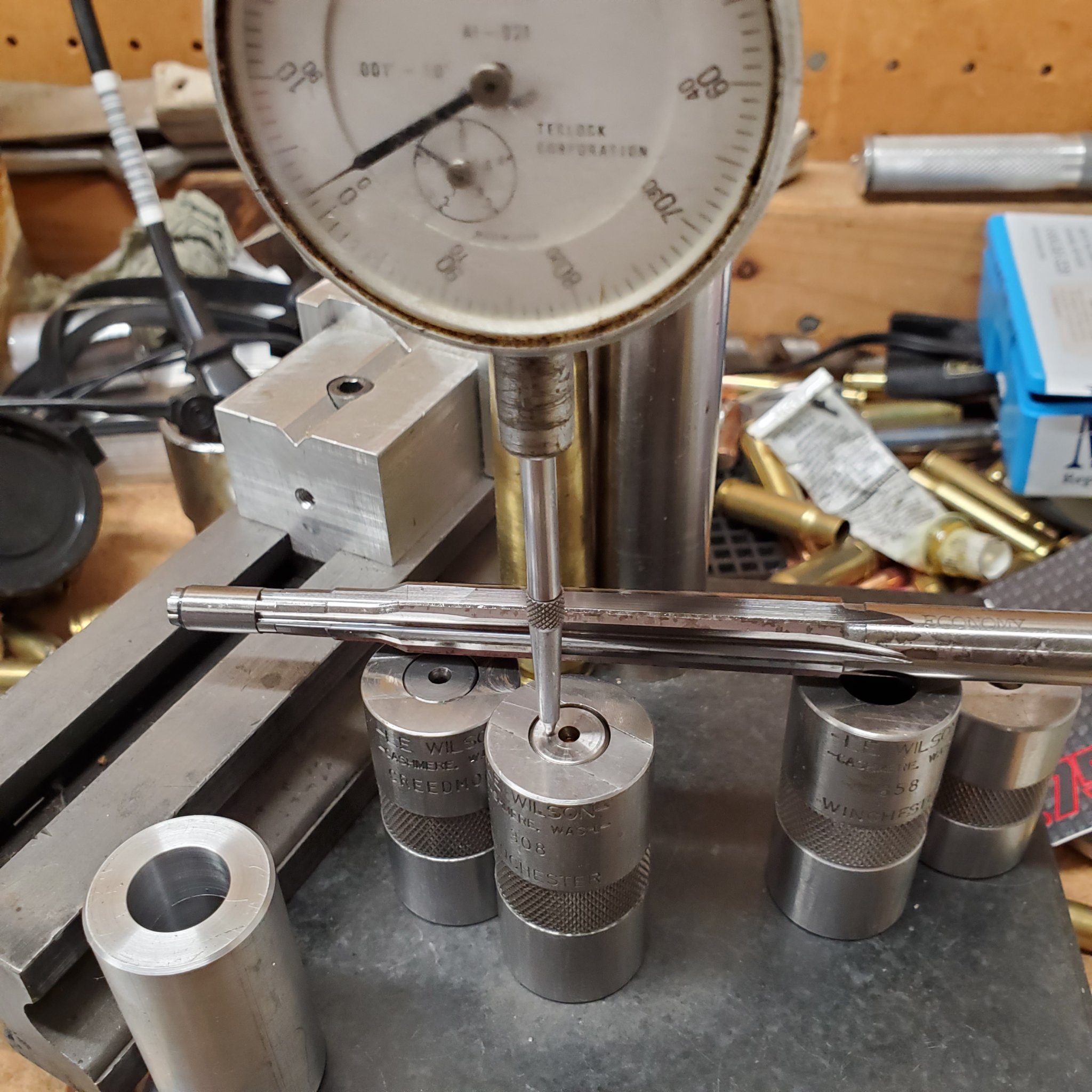

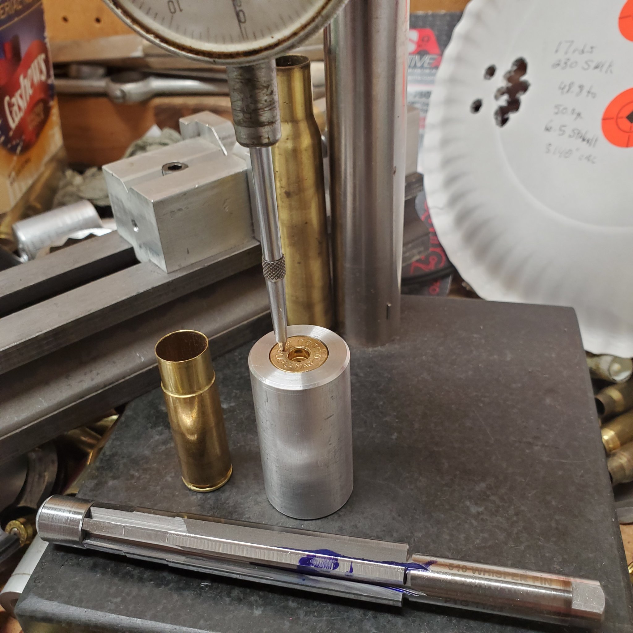

Yes, I use case gauges.
I even make my own with the reamer I chambered the barrel for. They are not available in many wildcat and many outdated cartridges.
There are no, chamber gauges either, like go-gauges, so ya make your own, to chamber your barrel.
Checking factory cartridge gauges for accuracy with the go gauge used to set your chamber headspace, is very beneficial.
This makes for accurate measurements.

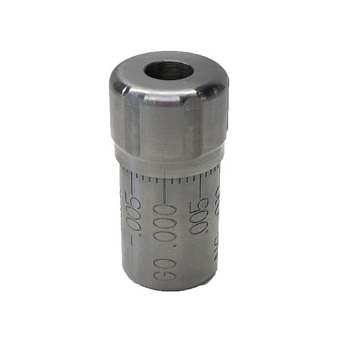

I've had my Wilson case gauges for years, but didn't use them much outside of when I was shooting NRA Service Rifle, with LC brass. Learned the hard way to gauge *every* round used in a match - at least with that stuff. Especially with a gas gun.
More recently, I broke down and got a Wilson case micrometer. So the case gauges came in handy... although I am considering whether it'd be worth it to get one made from the actual reamer 🤔

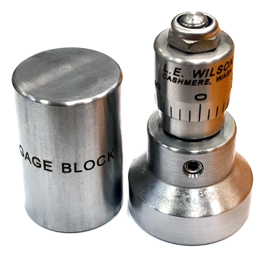

Just this one, with the regular (headspace only) case gauges.
The block’s only for zeroing.
Has the advantage of speed in operation, seems less technique - dependent than calipers + comparators.
I like this idea for those who don't have a surface plate and drop indicator setup.
Accurate methods and more choices to check out variations in cartridge sizing and shoulder set back is a welcome sight, to let the individual shooter decide the method or methods he chooses to use.

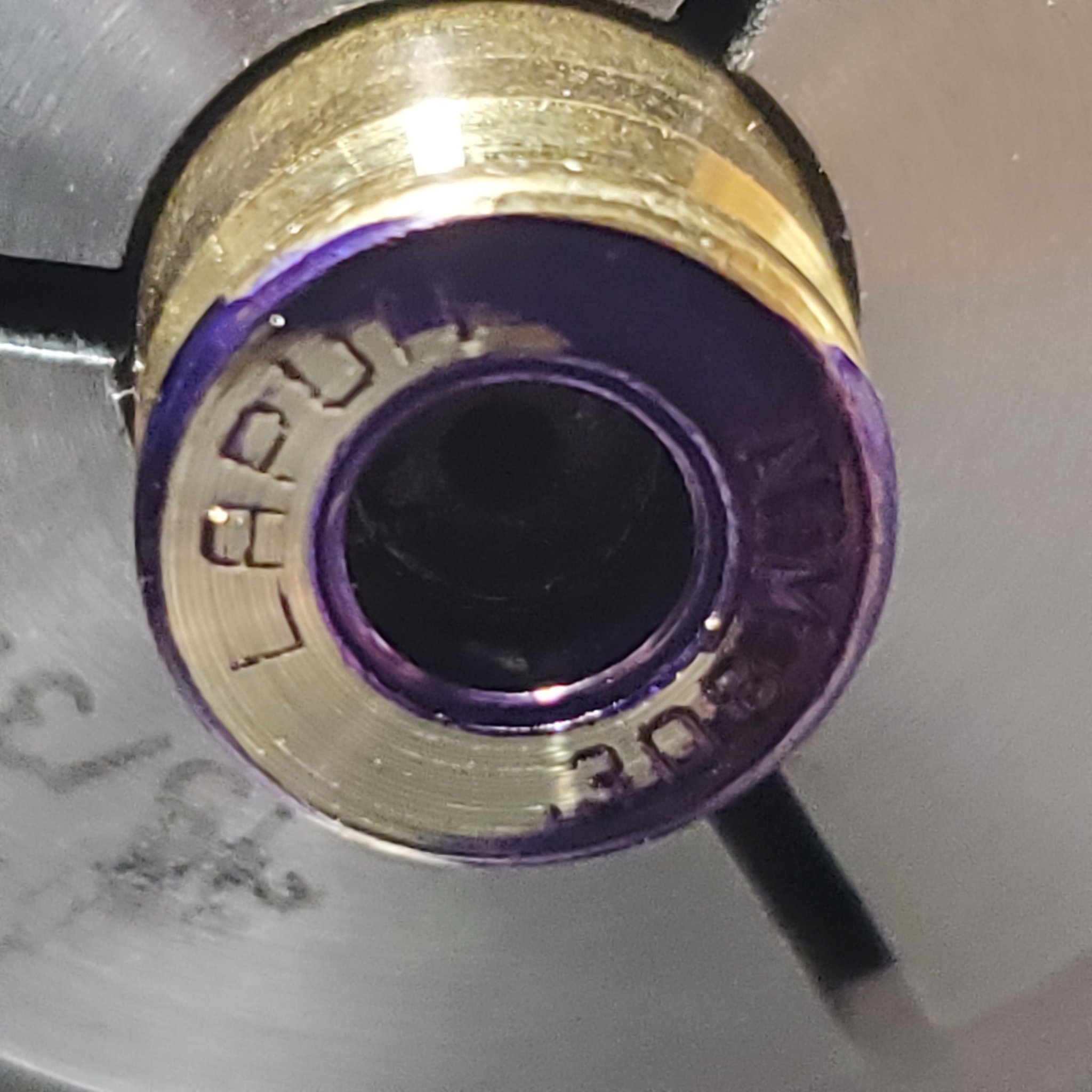

Example: The best cases in the world (subject to discussion) the case heads are not perfectly square.
And another variation added to the shoulder set back measurement that has nothing to do with annealing. And why one might get a different measurement with the caliper if moved 90°, although small it's there...

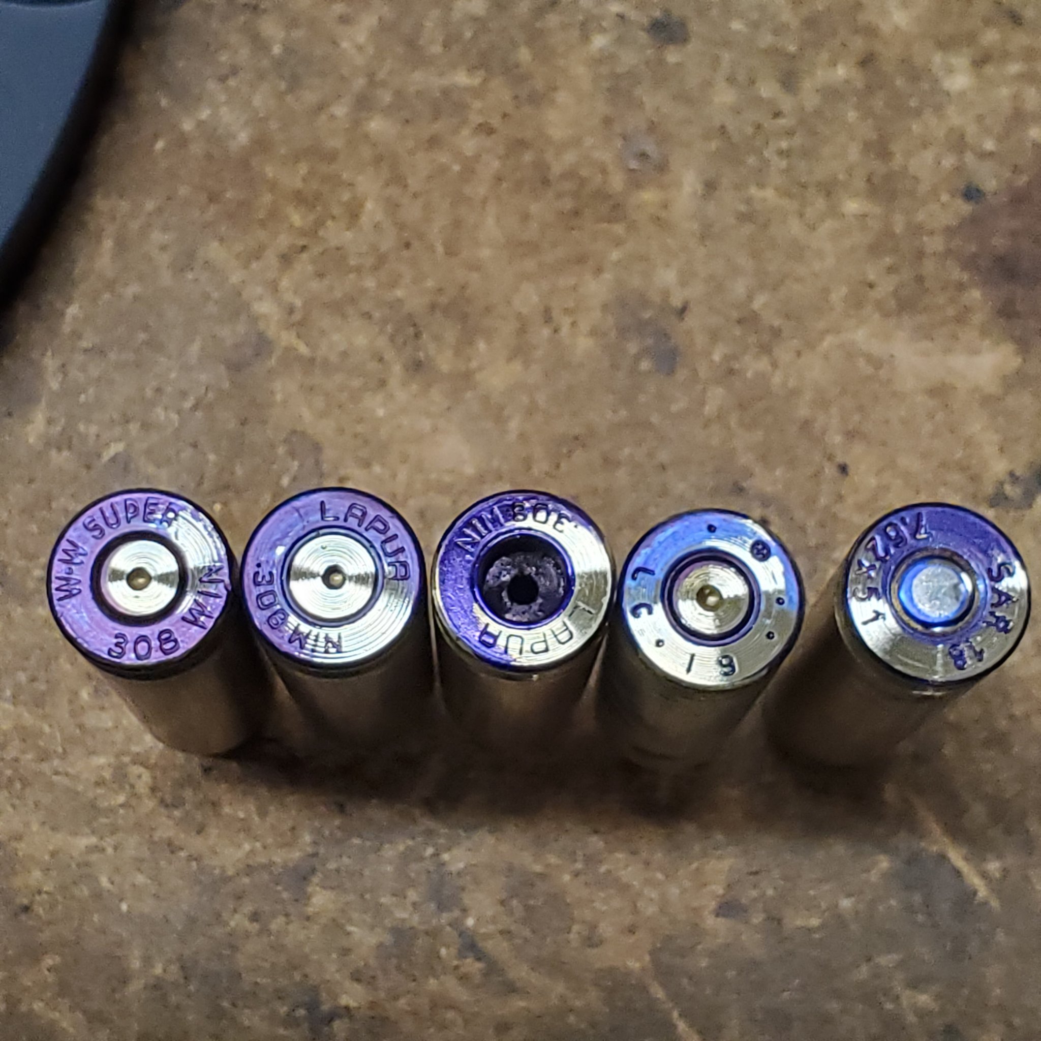

Here is a random group, LC military was laughingly pretty good.
None were flat...
notice the primers being machined flat, pushing out and flatening against a square boltface.

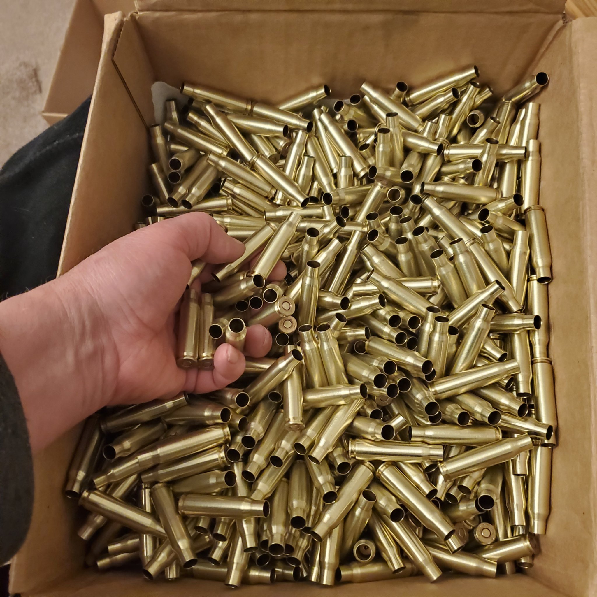

I am in the middle of loading 308 for a semi auto, and have several large bags of brass (some deprimed and sized, some deprimed and cleaned), so for that, yes, I'm using a case gauge to sample some in the bag to see if it's sized or not.
I use a lot of LC brass, these 1000 ready to load 308 LC brass cases have already fired, along with Lapua, hybrid, and other commercial cases. Just load em to the shortest headspaced bolt gun chamber and shoot them in all 8 rifles auto or bolt. They are easily capable of half in 5 shot groups with no case prep, even out of AR 10 autos with good barrels.... but I use the Wilson case gauge along with a drop indicator on a granite surface plate so I know exactly where the case shoulders are averaging out. Or letting you know its time to anneal, with more inconsistent spring back in the shoulder.
I use the same neck bushing for Lapua and LC brass in the Wilson FL bushing die...not so with Winchester.

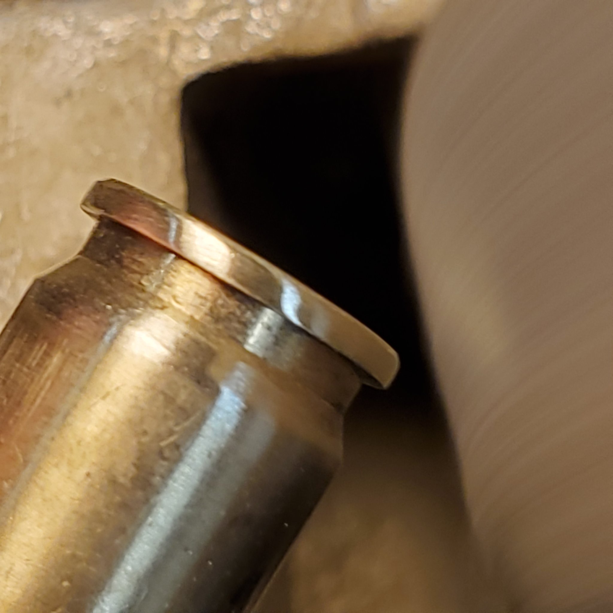

The issue I had with a batch of LC 5.56 brass wasn't the headspace, but the rims.
I'd checked the headspace, using a regular comparator, adjusted the sizing die accordingly, but every once in a while, had one that wouldn't chamber. Measured everything I could think of at the time... nothing. Finally, I tried dropping the offending cases in the gauge. The rims stuck up well proud of the gauge face - despite having 'perfect' headspace. What the...?
Turned out that a few, out of that bag of 1k, had a burr on the rim. Dunno exactly what caused it (I have guesses), but it was enough to make the round hang up going into the case gauge - or the chamber.

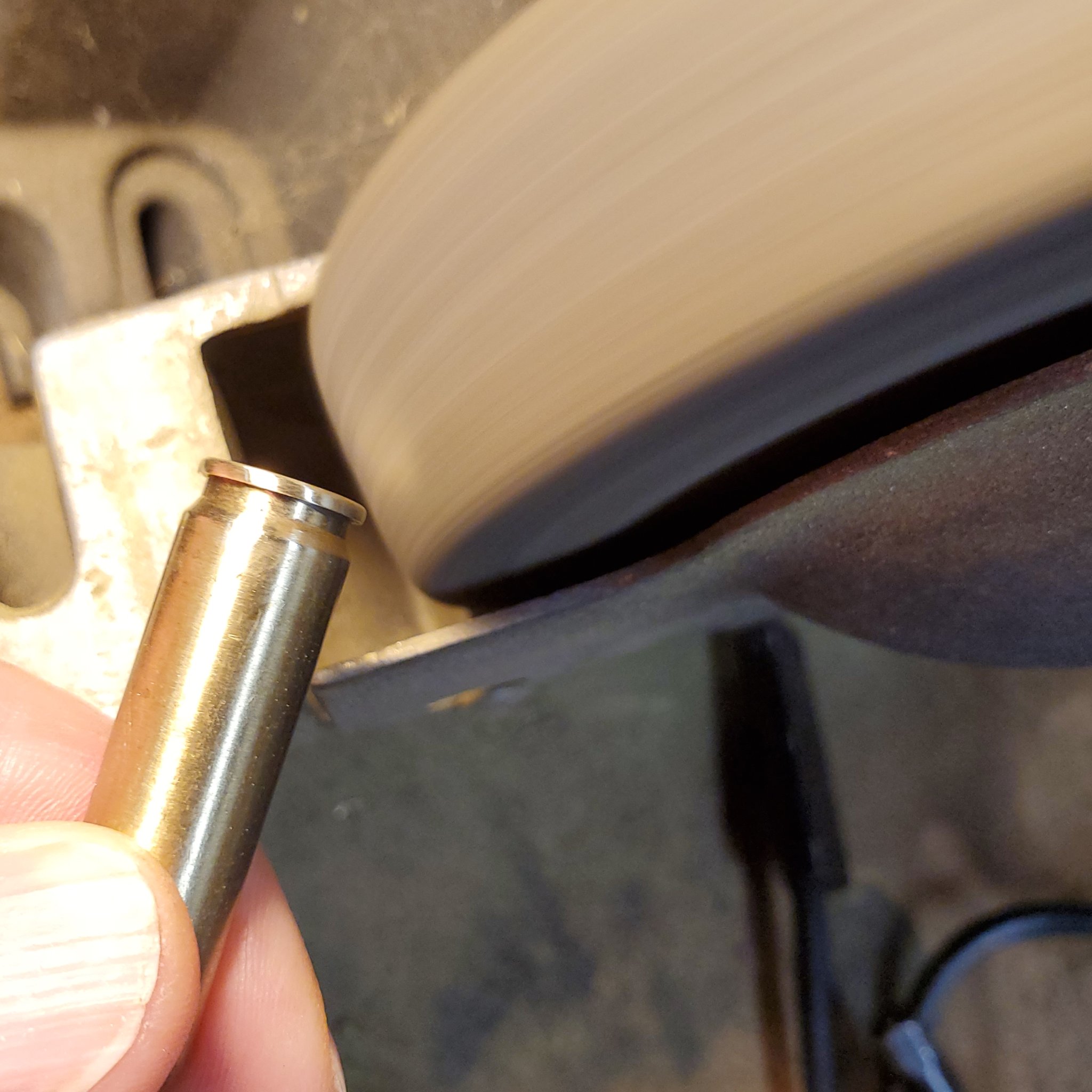

Burrs on the rim are common, even slightly bent rims especially from autoloaders.
A quick buffing on a Scotch-Brite silicon carbide deburring wheel does the trick in one or two seconds.
This is one of the reloaders best tools.
Polish and deburring in a fast fashion. Great for spin polish or deburr. Get yourself one you'll be glad ya did, been using them in reloading over 25 yrs.

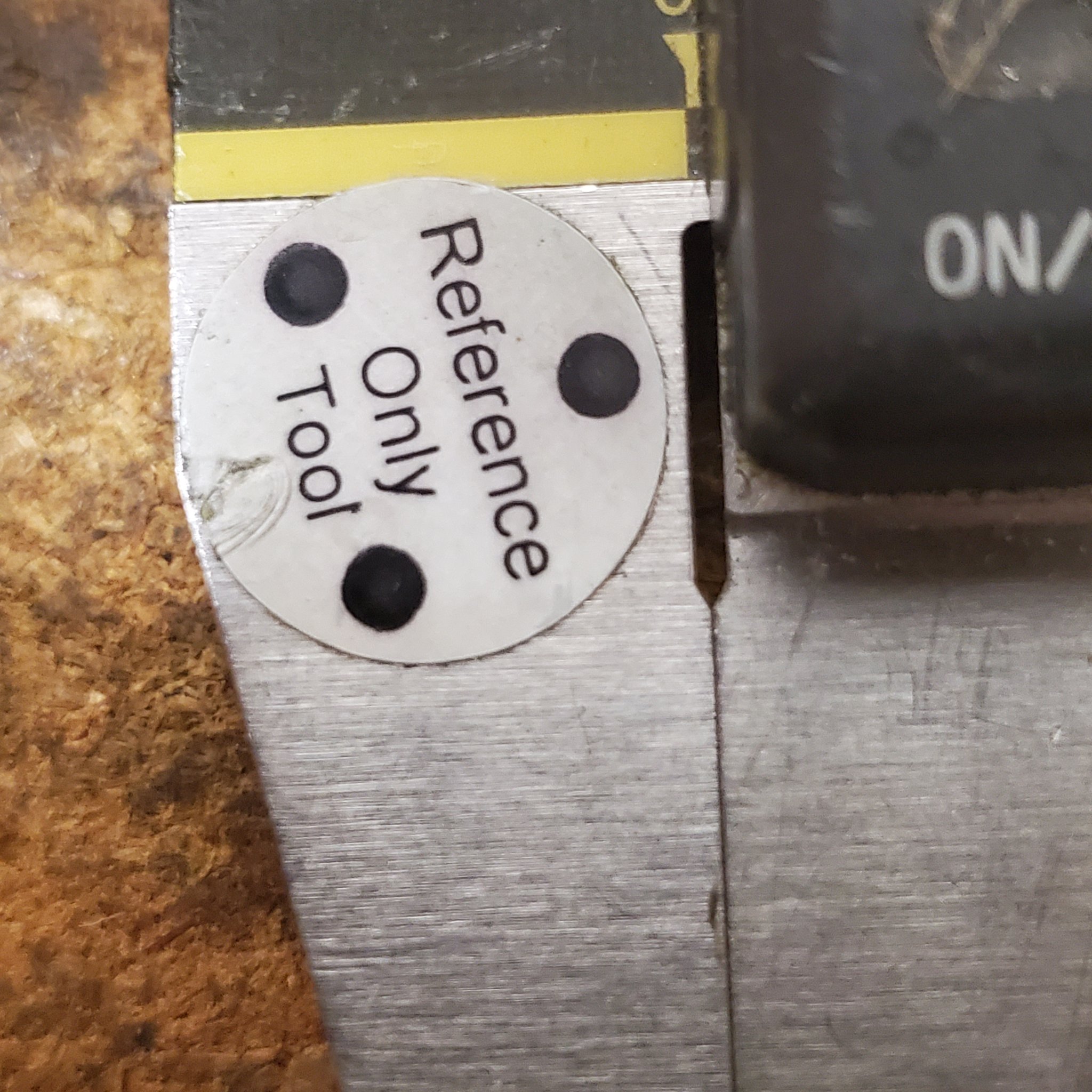

Keep this in mind, Industry standards :
A digital/ dial caliper is not a precision instrument. It's a plus or minus .001" at best for precision measuring, as it can be flexed that much easily.
It's called a reference tool, only.
If one has a large tolerance it can be used to spot check parts, but never used initially to pass a part to begin production.
The inspection department didn't have one. It's all electronic, granite surface plate CMM in a controlled atmosphere, high tech digital measuring machines, capable of finding fault with parts made on the worlds best CNC machines.
Those machines are inspected for accuracy before being put into production.
Calipers are not used in inspection departments to determine if a part is in or out of print, you would be fired for that.
"It was close, but my caliper said it was in."
Only calibrated micrometers are used with an inspection department sticker, by a machinist no other measuring tool are allowed in the shop, for precision measuring, only reference, akin to a tape measure, not considered precision.
Here is an inspection department sticker still on my caliper.

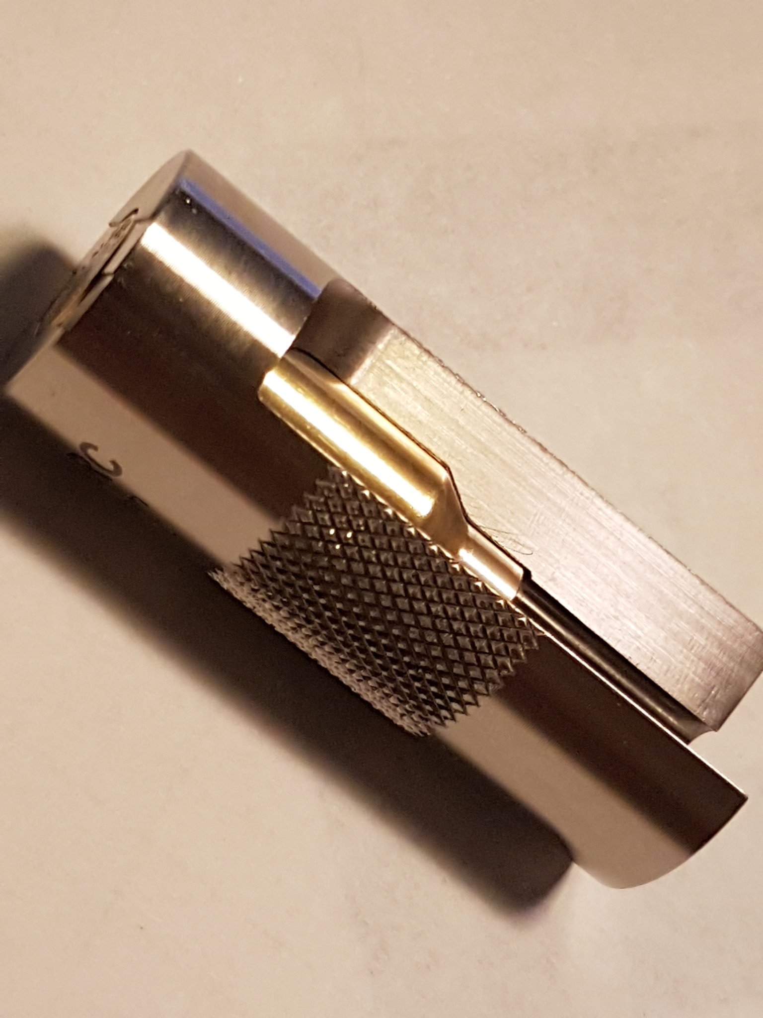

FWIW, if your firearm uses a "SAAMI spec chamber", you want a gauge that can display multiple areas that are critical when a casing has been resized after firing or when converting a casing. These areas are the case web, case body circumference, shoulder bump, trim length and bullet ogive contact. If any single or combination of those is off, it will affect your feeding, especially in self-loading platforms. I use the Sheridan slotted gauges for all of my AR rifle calibers as it can show ALL of those at the same time. I can check the cases after sizing and before loading to make any adjustments of dies, trim length and initial bullet seating. For AR platforms, getting these dimensions right for the 1st firing ensures reliable feeding, chambering and firing. The enclosed body gauges didn't tell me if my shoulder bump, case trim length, case web or bullet seating depth were off when a casing wouldn't just drop in or drop out, the Sheridan slotted gauge will expose which is at fault. CAVEAT: Once you have your dies adjusted for the casing itself, bullet seating is when most people will deviate according to their desired amount of jump if it exceeds the COAL for the SAAMI spec or the magazines they use.
YMMV
