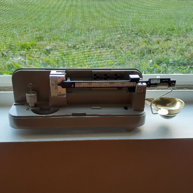

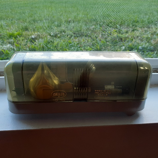

Ohaus 1010 been using this bad boy for 15 yrs never had any issues
Reactions: louu and cm1021
