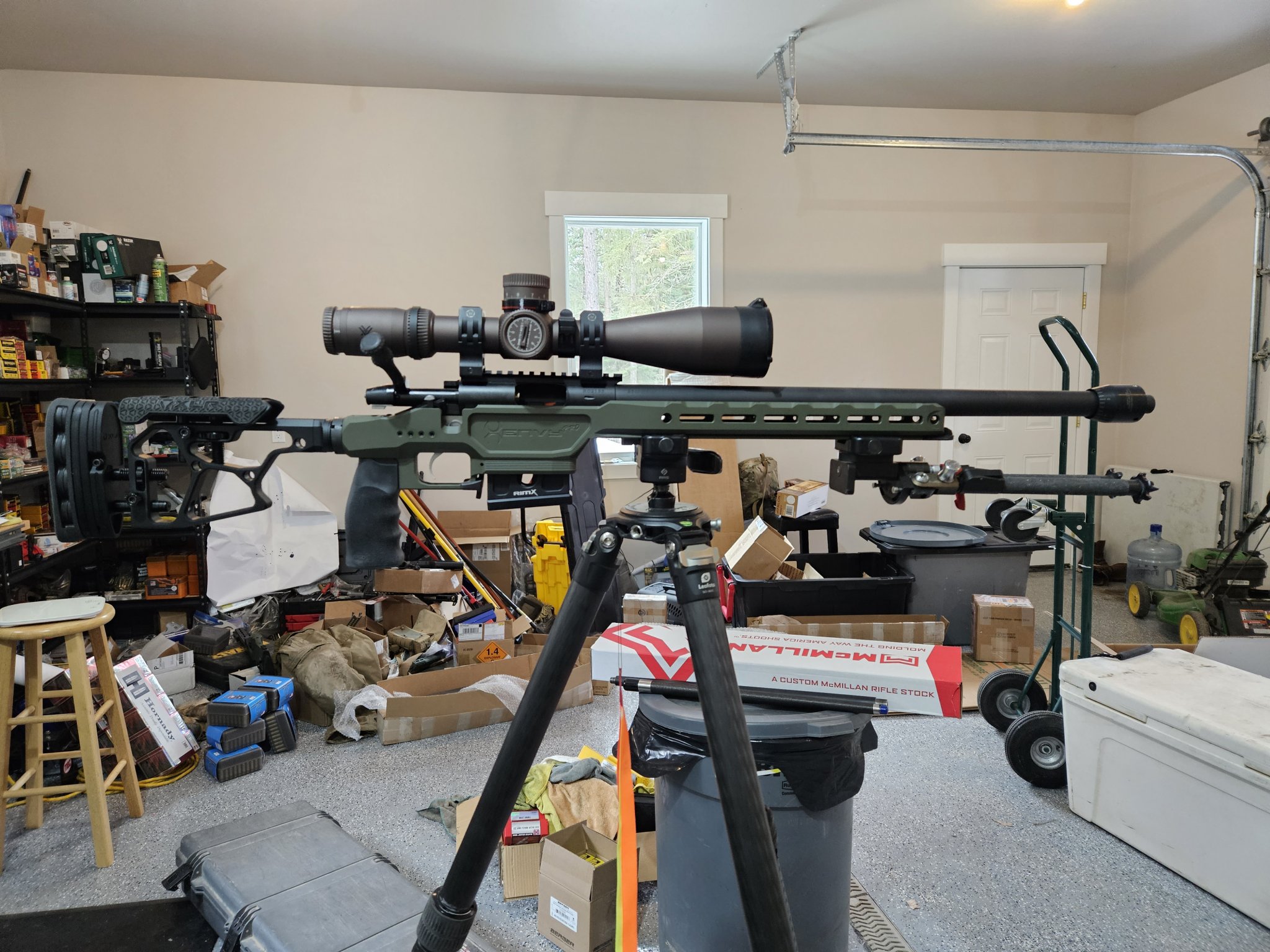

Not the prettiest of rigs, but it does balance at 11.5lbs.
Vudoo 360 w/ 22" Benchmark Benchrest Contour with a Holeshot Tuner
Element 4.0 Magnesium
Vortex Razor AMG 6-24

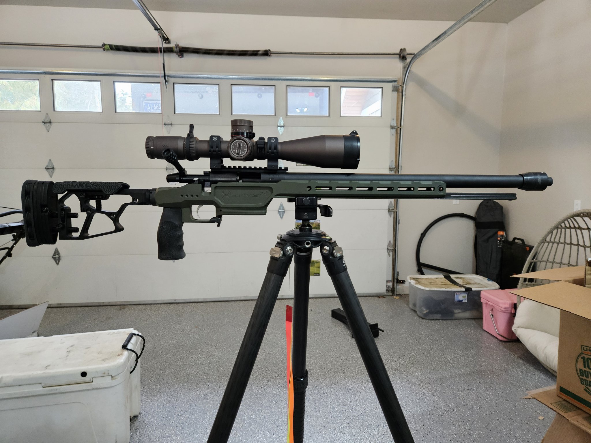

I’m running straight 1.25 22” Krieger barrel in a MDT JAE with no weights, Gen 3 Vortex Razor and it’s coming in a just a bit over 20 pounds. Balances right at the magwell. Previous to this barrel it was an 18” Ace Vudoo barrel, don’t know that I’ve noticed a huge amount of accuracy difference but larger barrel is easier to balance. I would say that the noticed Accuracy has come from the chamber and the fact that it’s far less picky with ammo.
and even that big barrel is rear heavy it seems since you said right at magwell...not 4-5" in front of magwell

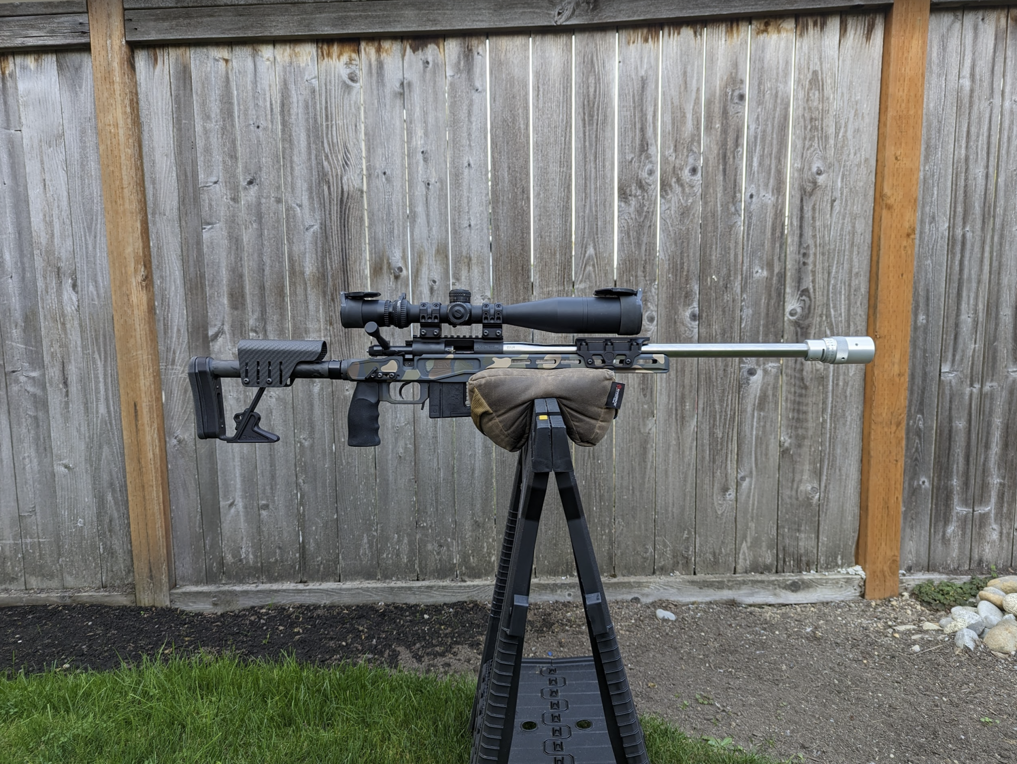

I am putting a Tract Toric 4.5x30 on the Vudoo so I am thing with the MTU and chassis weight plus scope should be in the 20ish range. That is about the same as my AI's.
I got to weigh my rifle to make sure and it's 18.5 pounds as pictured. 22" MTU and ATS tuner. The S3 6-36 is a couple ounces lighter than the Tract but not enough to get you over 20.
I grabbed a couple sets of exterior weights for my ACC when they were on sale. Now I can take the bipod off and still balance well. Makes the transitions much quicker and smoother just sliding that long flat forend onto the bag.

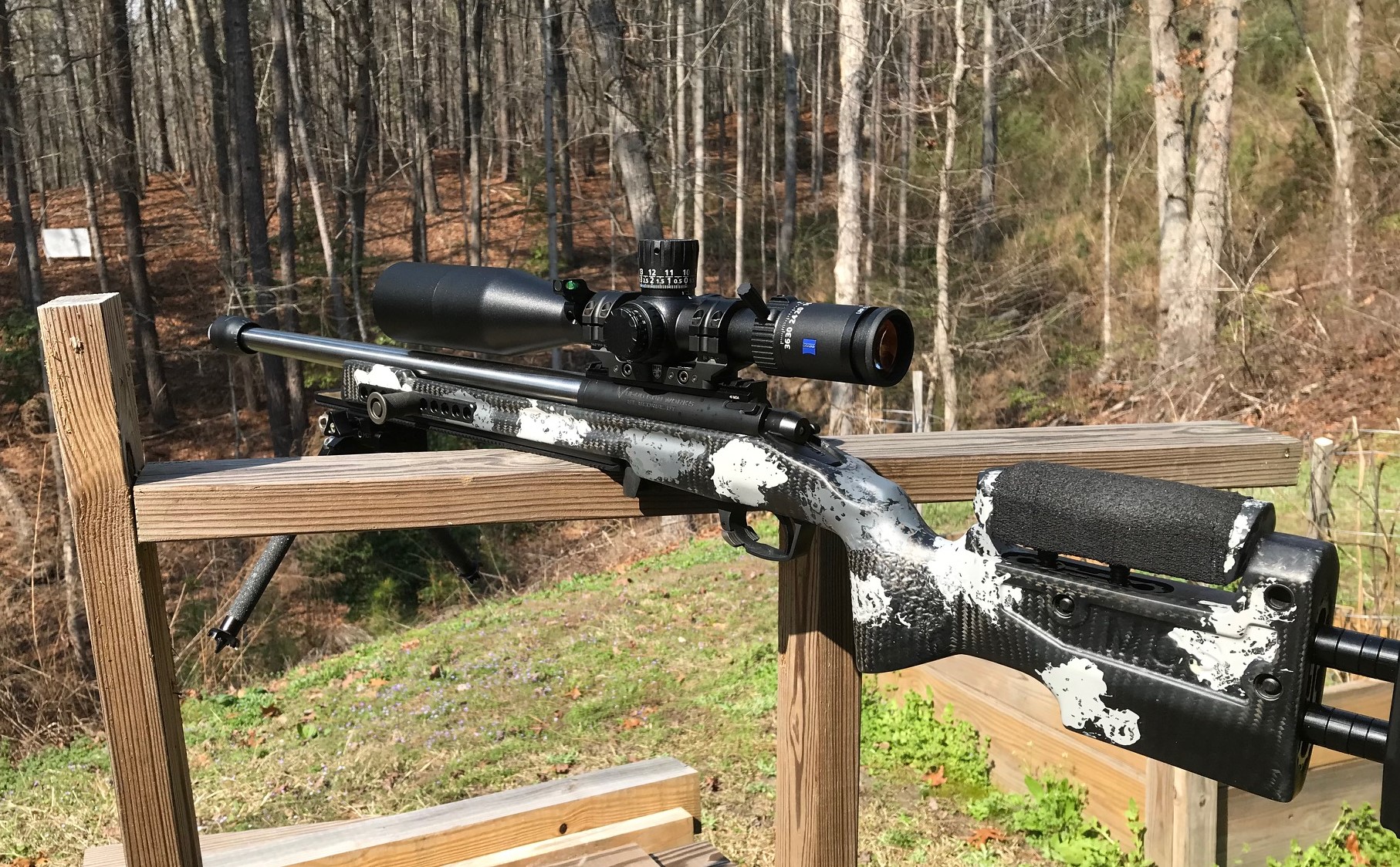

This is a 22" m24 Bartlein rimx build. Has an ats tuner at muzzle. Heavy gen3 razor glass. Had to install the 6" arca extension to get it balance decent without bipod installed. With heavy arca extension rifle weighs 16.2#
Edit: I do plan to switch to a bit lighter glass, prob an s3 zeiss 6-36 as I'll be adding a rear bag rider and trying to keep balance without weight. Nrl22 matches do have a lot of movement and odd positions where a heavy rifle will just slow you down.
