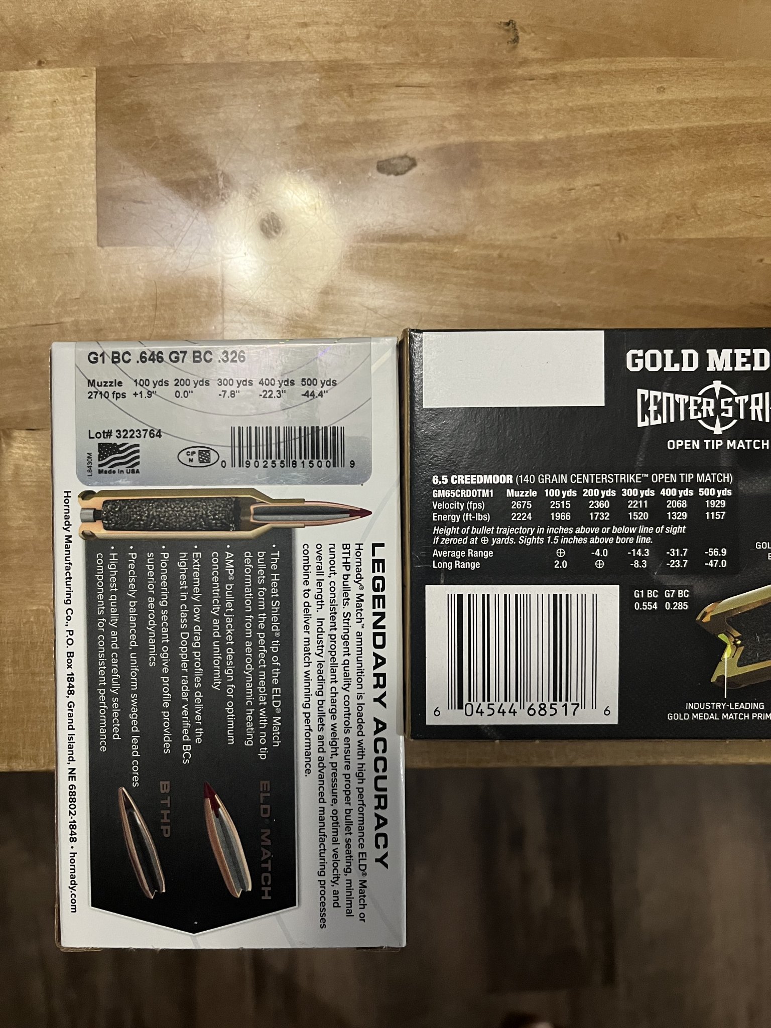

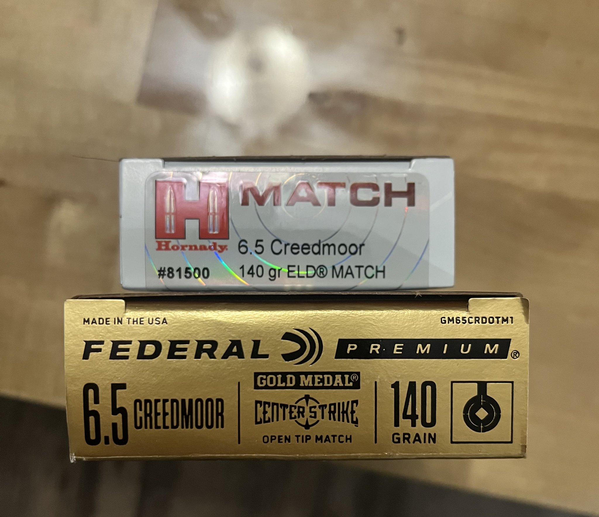

Hey guys hope all is well. Question about BC. I live in Nebraska where Hornady is. Been shooting eld match for a while. Recently I have branched out to shooting different ammo to see how my rifle groups. I haven’t shot this federal yet, but curious as to why someone would choose open tip or even the federal 140 gr Berger rounds. They both have a decently lower BC than the Hornady. Without sounding like a rocket scientist, why or in what conditions would a lower bc bullet or an open tip bullet be better? Not trying to say Hornady is better than any other brand just genuinely curious. Thanks!
BC matters at distance. Typically 600yds and further. Inside 600yds, velocity plays a larger role.
So, you'd have to take your specific situation into account to decide what matters for you. There are many other factors to consider besides BC, and again, specific to your situation/s.
View attachment 8349425View attachment 8349426
Run the bc’s and velocities through a ballistic calculator. You’ll see exactly how much it matters.

Hornady almost always exaggerates their bc, that said I like their bullets usually. The 140 eldm trued to .303 g7 for me. Consistency is always king especially past 600y.
its not exactly them exaggerating, they just only list the highest BC for the highest mach value on the box...that BC would only apply for the first couple 100 yds of flight or so
the 140 eld's full listed BC values provided by Hornady are .326/.320/.310 for the 3 mach values they test
for most short action cartridges people are shooting, the 3rd mach value occurs around 5-700 yds where you really see BC start to show...which is why most everyone uses a value of closer to .310...600+ yds is where most are tuning up their ballistics to match
printing the highest possible on the box does probably draw more eyes and interest though...they know what theyre up to lol

In reference to your photos - The only relevant number on the back of a box of ammo is the lot number. Everything else is irrelevant to you and your rifle as a starting place to gather data. Your actual data / drop will reveal your true M/V out to 600. That is, if you know how to true a ballistic solver. Your data / drop at 800 reveals your most usable BC out to 1K and will not be the same as what is on your box.
Your takeaway: Let your actual hits / data / drop be your guide and don't trust published numbers unless they have been confirmed. Box numbers are merely place holders in a ballistic solver until truing.
Always seek to stay within a lot number during purchase.
Always zero at 100 yards.
