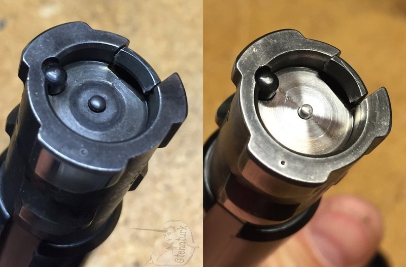

I was having primer problems with my 6mm Creedmoor and even more with 22 Creedmoor. I emailed both AI North America and MileHigh about purchasing a new SFP bolt or having the bolt head swapped out. Both responded with "no, those are not available options at this time. Send the bolt to Stuteville Precision to be bushed"
