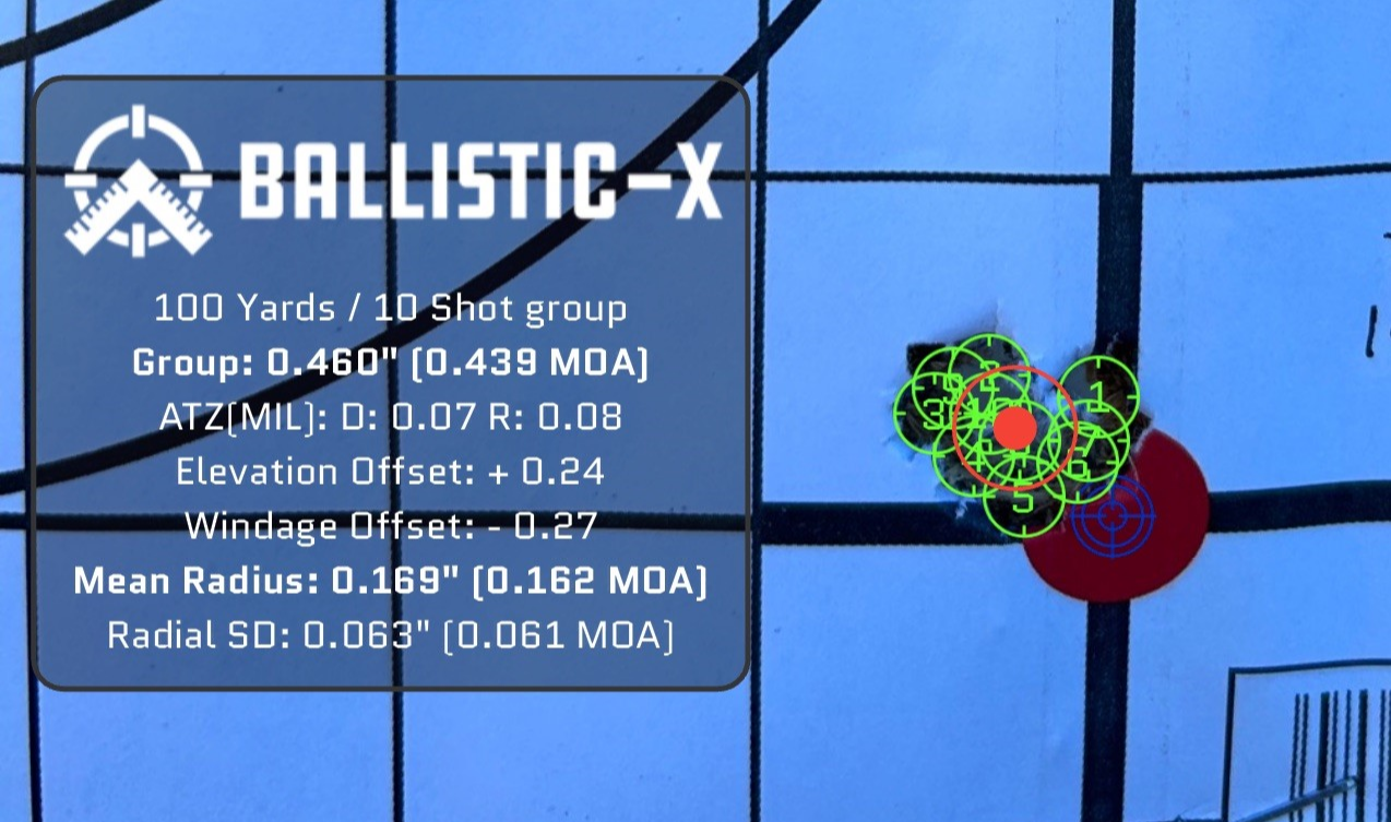

    To be honest, I'm over seeing bullshit 3 or 5 shot groups that mean little more than bragging rights.
    If you guys really want to do something meaningful about making your practice rounds count more than anything you've heard of &, something way better than your bullshit group size, C'mon in & learn what we all should be shooting for unless, we are Bench Rest shooters &, don't really count in the normal world.

    It's all meaningful, but I like to see mean radius, radial SD, and group ES.
    I agree.
    Take 25 rounds and shoot 5 5 shot groups taking at least the velocity off of 5 and then apply the statistics.
    We need the sd of velocity to bound our long distance come ups. 3x SD +/- of the average velocity is the min max velocity. How much is that at the distance you are shooting. Then add to that the same +/- 3x SD of the group size and you get a picture to a 95% confidence of what you can hit at distance.

    Group size is determined by 2 shots. Depending on the number of shots it can show how well a shooter can repeatedly put shots in the same spot or how well a load repeats. It does not show anything of statistical value.
    Mean radius uses data from every shot and provides usable statistics for predicting how well the load and shooter are performing.
    An expert shooting a rifle of known accuracy can tell a lot from either method. Take away one of the knowns then mean radius will probably work better when developing a load.
    Bottom line is both have merit. Understanding those merits is the important thing.
    Shooting paper at 100 or 200 yards means way less to me than the chrono. Few people are shooting enough to be statistically significant at that distance. (This is for rifles shooting under 1 moa with multiple loads)
    Up to about 16-18 shots in a group, it really doesn't matter which one you use because the variability group-to-group is so large that either measurement is only a loose ballpark representation of to total population. Both MR and ES have a ton of variability.
    At around 18-20 shots mean radius starts leveling out while group size (ES) stays variable. The more you put into the group the more mean radius pulls away for a meaningful repeatable measurement.
    The subject of compiling multiple smaller sample sets gets muddy. Changing conditions group-to-group or day-to-day can influence MPOI slightly so even if you correlate MPOA/MPOI of multiple small sample sets it can be a little noisy. If you don't correlate MPOA between smaller subsets then you're at least partly delusional in interpreting the results.
    In other words, I don't care how many 0.1-0.3 MOA 3-shot groups you have, your rifle is still probably a .6-.8 MOA setup at best for 20 shots. If you don't correlate POI to POA your tiny group means jack for practical application & hit probability at long range. You can do the math and see how smaller sample sets naturally produce smaller average extreme spreads... That doesn't mean your rifle is more capable. Your "0.1-0.3 MOA" rifle has the exact same capability as someone who shoots 30-shot samples and has a 0.9 MOA system. When you take a 1st shot at a target, you're pooling from the total population of possible dispersion and that's what drives real-world hit probability, not random chance small sample sets where you go back after the fact and make excuses for "fliers" and delete data points.

    honestly the group size (ES) is nearly meaningless. The true population group is done with infinite shots in theory. The thing with ES is as you add shots, ES will get bigger. You can always shoot worse, you can always have a crazier shot, you can always have a worse flier as you shoot more shots in the group. But the mean radius, or median radius (CEP circular error probability) will approach a value that represents the true value of the population as you add more shots (won’t constantly increase), which gives you a valid accuracy of your rifle system. So why would you pick a stat that’s never gonna tell you the true accuracy of your rifle?

    Something that was mentioned upstream that’s important for folks to keep in mind…For normally distributed data the min recommended sample size to make decisions is around 30. But you can save some money by making rough decisions based on 10-15 round groups. If only doing 5 shot groups then mean radius uses more data points (5) than looking at group size (2) so it’s more than 2x the data points compared to group size. If only looking at one or the other for a 5 shot group I’d take mean radius. In other words mean radius levels out sooner and is less noisy sooner than group size.
