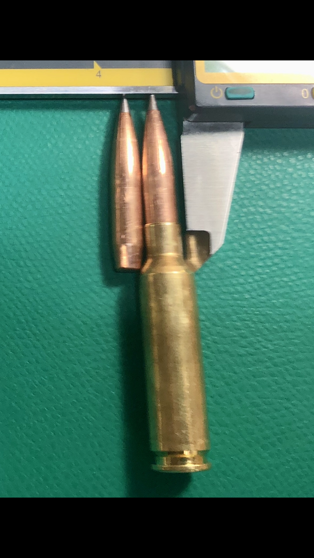

For new (-ish) barrels: Does longer freebore allow more powder and more speed if you load to a small jump?
Say a long bullet is inserted only 0.2” into the neck, either because the reamer cut a slightly longer freebore, or the lands have eroded some amount. Effectively case volume goes up a lot. Does this help us achieve more speed by adding more powder, without running into pressure problems?
Example below: 153 gn Atip projectile, which is very long at 1.5”, in 6.5 Creedmoor brass.
Yes technically, but it doesn’t have as great an affect as you’d think. On two occasions I’ve chambered a barrel, developed a load, then ran the throat out further with little affect. In one case I added .138 to the existing .112 throat. It gained roughly 30 FPS. You could see a greater variation across two different barrels with identical specs.
Pick the throat on the practical aspects like mag feed, appropriate sized action for the cartridge as opposed to using a longer action, etc.
Thanks. It looks like i can add 2 grain of additional powder as a result. Lands have moved forward by 0.2”. Does this make sense?
What you’re describing would be the same as comparing capacity between a 6.5x47 and a 6.5 Creedmoor, or a Creedmoor to a .260. They’re performing almost identically in a lot of guns in hand loaded configuration. If you want to go faster, pick a larger cartridge and/or a longer barrel.

Good feedback, thanks much. Yes it is now loaded way beyond mag length. Single feed only. [On my new MPA rifle with a fresh barrel, the bolt will not be able to close, loaded this long.]
So to summarize, and correct me if i am wrong: Longer freebore in a new barrel might perhaps gain you 30-50 fps, but it is not going to turn a 6.5 Creed into a 6.5x284 or a 6.5 PRC. A barrel with a slightly larger than SAAMI spec chamber might do the same, i presume.
Case closed, and thanks for the details!
